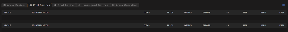

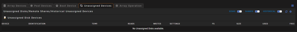

  1. I removed UD Preclear as another forum recommended. Then started the array in safe mode multiple times. Unfortunately, no drives are showing available so no data from them such as dockers, shares, photos, movies, etc can be found.
  2. I used the Unraid USB Creator software to create a new boot device as requested. I then copied the old config files to keep my settings and replaced the Key as Unraid required. Afterward, I rebooted my server and signed into Unraid. Unfortunately, nothing changed, Unraid pops up and does not recognize any of my drives. Array Devices, Pools Devices, Boot Devices, and Unassigned Devices all remain blank. However, while copying over the config files, I was able to gain access to my diagnostics which I have attached. At this point, I am worried I have to start all over. stark-diagnostics-20240703-1315.zip
