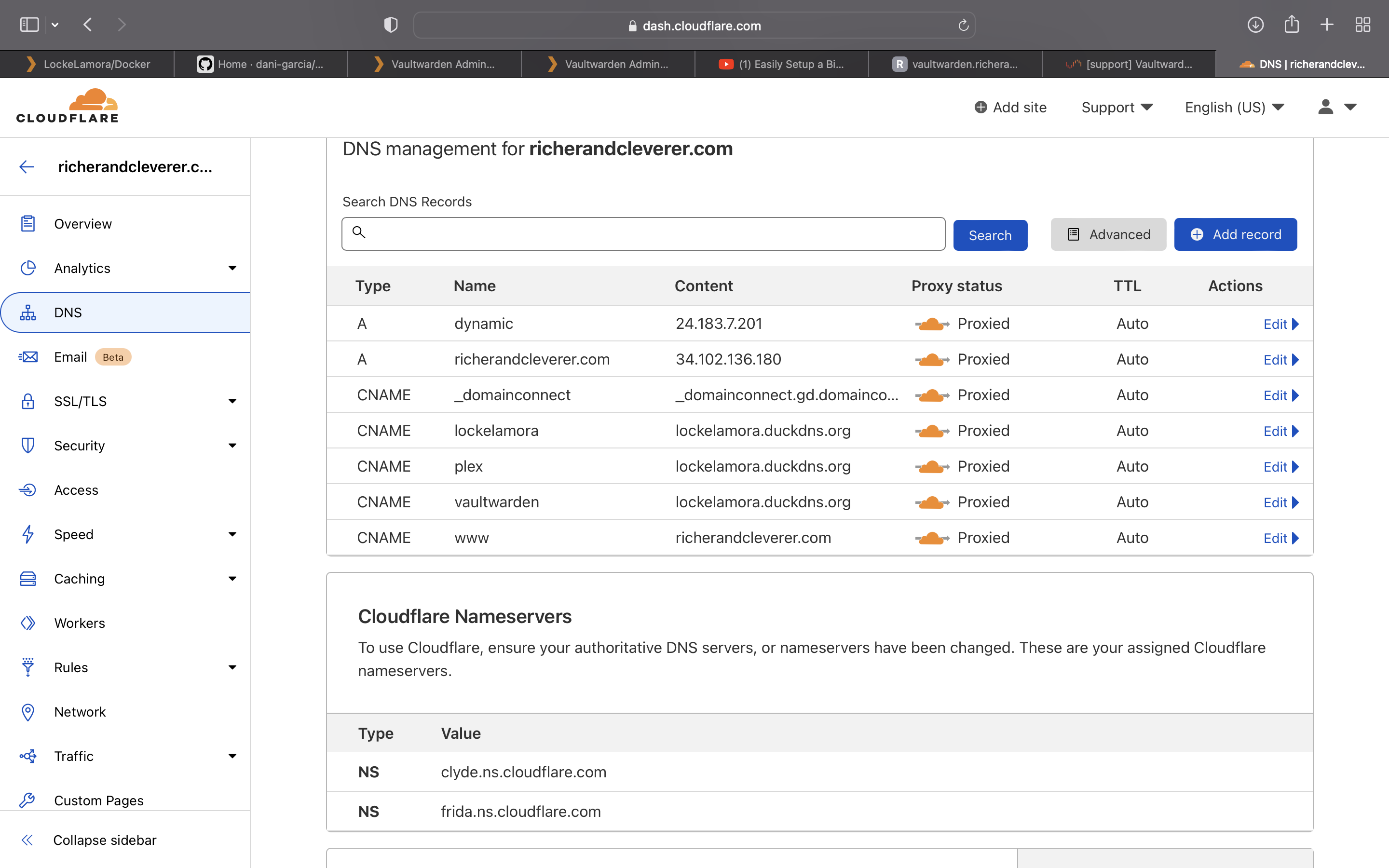

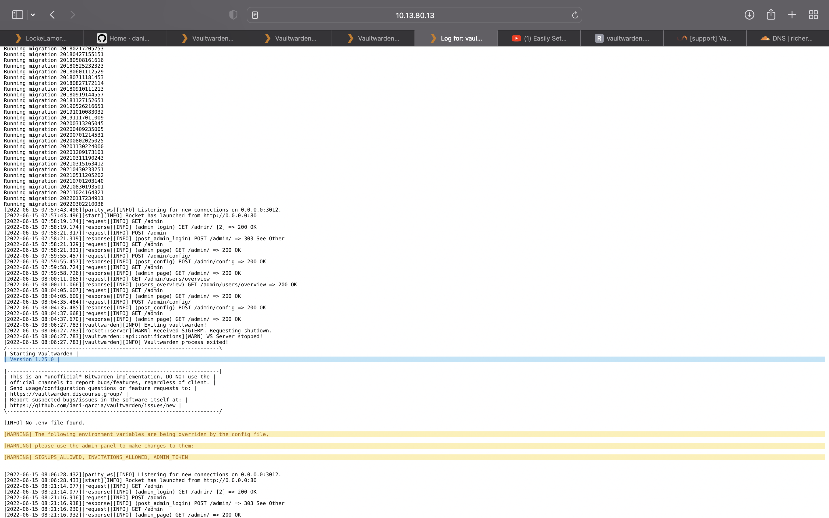

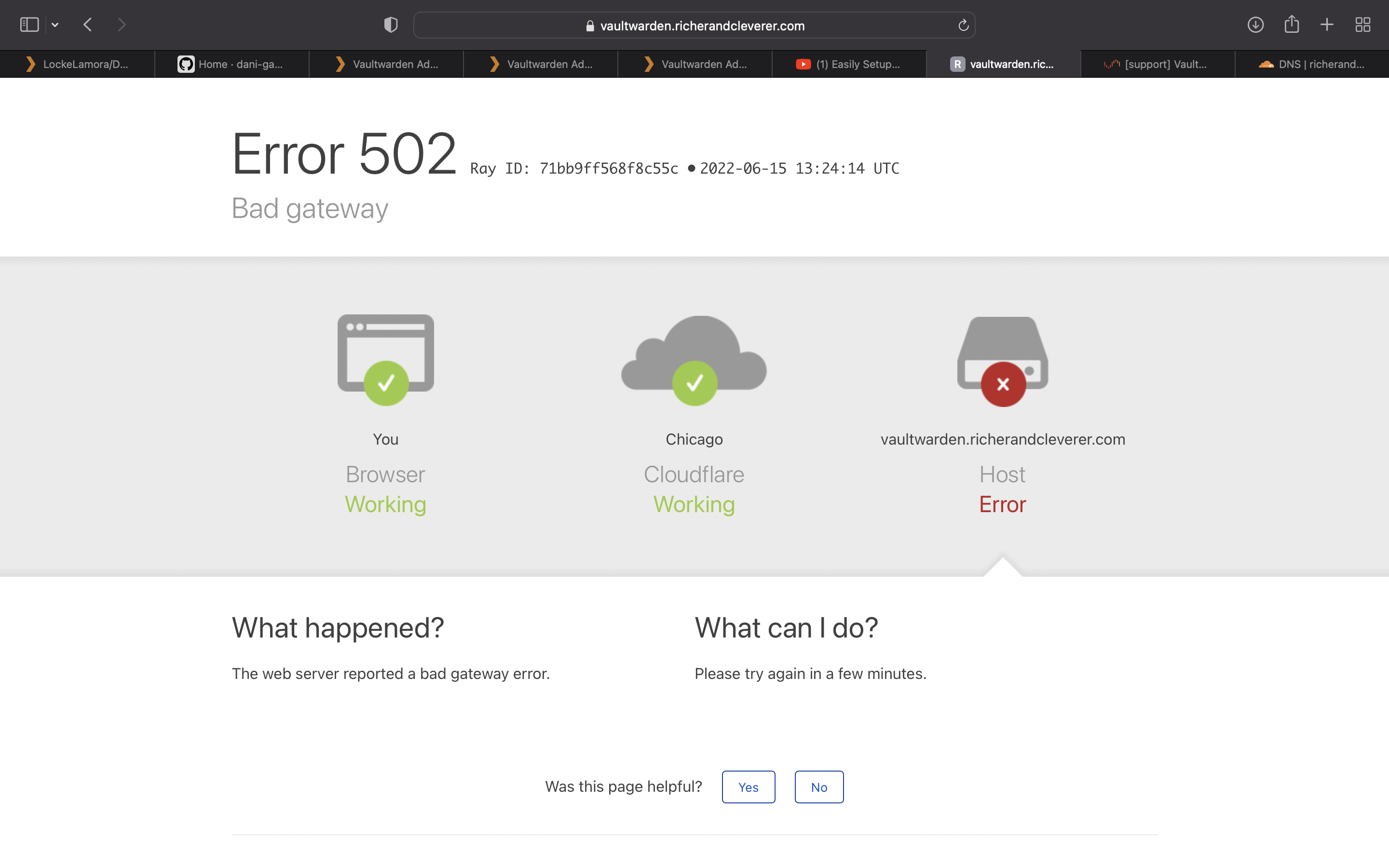

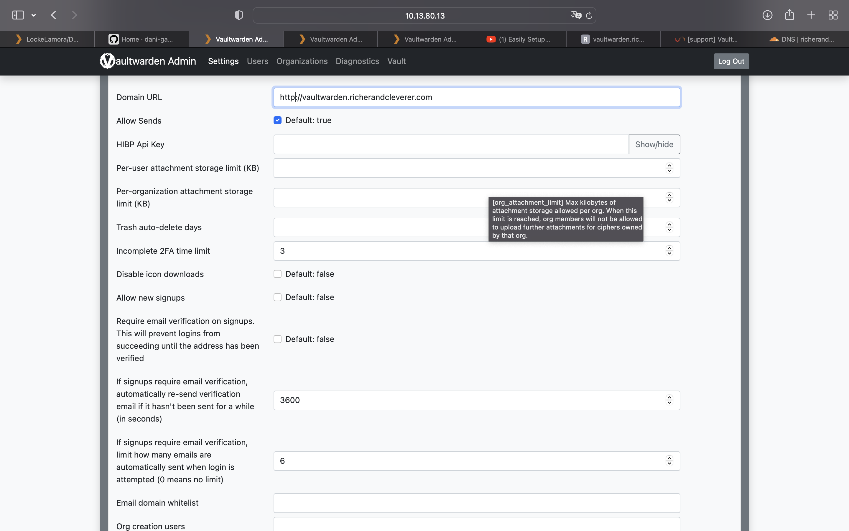

  10. I am having some trouble with vault warden/https/reverse proxy I have swag setup and the logs are normal. I used space invader one's setup video. swag runs on a custom network called proxy net (just like my hero spaceinvader one) vault warden is setup and I can config the smtp and send a user invite. when I try to continue the invite process I click the link and am taken to the login/create act, but I can't finish due to https error I went through the reverse proxy process step by step. I have duckdns and cloud flare dyndns both ready and setup. I have a CNAME vault warden.mydomain.com to direct to the duckdns url. I am attaching the VW log (the swag log has no errors and is running just fine), a snap of my cloud flare settings, and some other potentially relevant info.I have also attached a photo of the error I get when I try to go to my site. If we can get this figured out, I will buy a random stranger a beer today. If there is any more info you need to diagnose or fix this, let me know. I am new to this and am VERY accustomed to deleting dockers, deleting app data folders, and reinstalling. I am not good enough yet to fix it all in settings so I nuke them when I get lost. This is my third clean install of VW. vaultwarden.subdomain.conf
