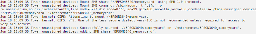

  3. I updated the plugin to 2022.06.19 but I'm still getting errors unfortunately. Here's what I tried so far: 1. Restarted the unraid server and reinstalled the plugin 2. Changed the password (I'm using a very simple password) 3. Disabled authentication Any other suggestion I can do to check on my end? Thank you. tower-diagnostics-20220621-1754.zip
  4. Thanks for looking into this. I can confirm that it successfully mount my share on 6.9.2 but not on the new unraid OS 6.10.x. I was thinking that this issue might be tied to the new unraid OS. tower-diagnostics-20220618-1811.zip

  6. I updated my Unraid OS to 6.10.3 from 6.9.2 but I am unable to mount a smb share. It was mounting the share just fine on 6.9.2 but not on the new OS 6.10.3. I double checked the settings and everything is the same. Is there anything I can check on my end to help solve this issue? Thank you. tower-diagnostics-20220617-2107.zip
