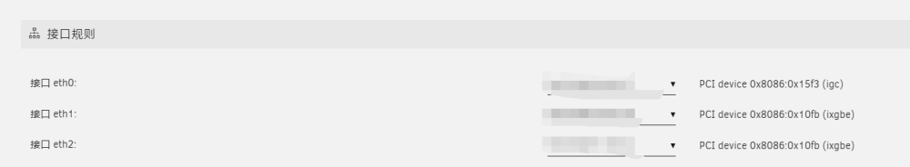

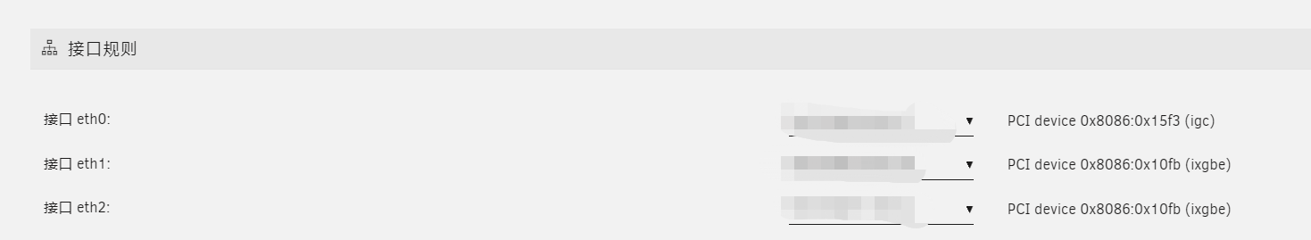

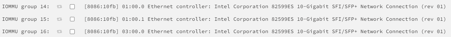

  3. Hello everyone. I recently purchased a x520-da2 network card, but when I plugged it into the motherboard, I found that the dual-port network card can only recognize one port. It is strange that there are 3 SFP+ ports clearly visible in the system equipment, but only two are shown in the network. (There are two x520 network cards on my motherboard, da1 and da2 respectively.So theoretically there should be three 10G Ethernet ports and one onboard 2.5G Ethernet port) I have tried to delete the network and network rule files in the boot folder, but it doesn't work. There are screenshots below for your reference, please reply if you need more information. Thanks for the support!
  4. 使用x520da2的时候遇到了一些识别问题,我现在设备主板上插了两块x520网卡一个da2一个da1总共三个口,而且在系统设备中也能看到三个SFP+的网口. 但是在网络中现在只显示了两个口,等于双口网卡只显示一个,boot里的network和network rule也删除了也不管用。 有遇到同样问题的大哥吗?
