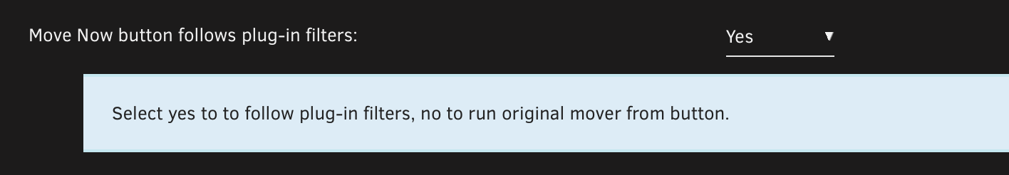

  3. this just worked for me. Plugins>CA Mover Tuning>Move Now button follows plug-in filters: Yes
