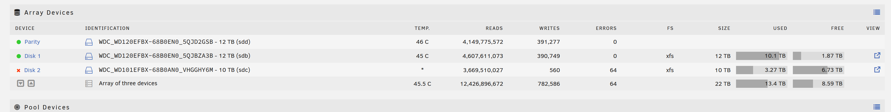

  2. Last questions, i hope - Replace the SATA cable? Do you mean make sure its in place or change it? - So i need to stop the array, assign the drive as disk2 as previously, and start the array? And the drive will be rebuilt? - Why does the drive need to be rebuilt? The data is all there....

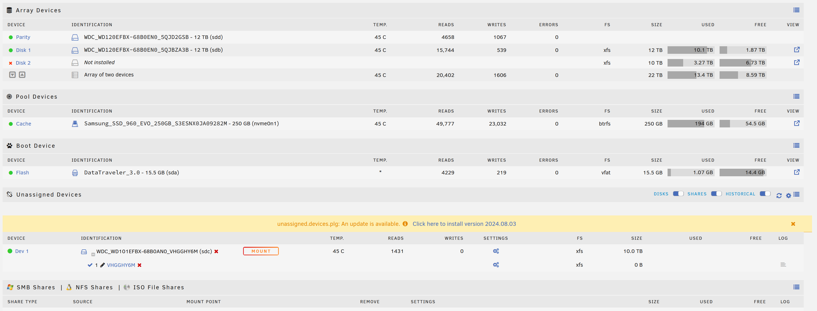

  3. Sorry, smart report fixed in previous post. Array started with the disk unnassigned, this is what i see. Why would the disk have to be completly rebuilt?
  4. Smart Test results (short): Completed without error The disk is now unassigned and when i try to assign it as Disk2 as before, its seems to be detected as a new disk and Unraid wants to rebuild it WDC_WD101EFBX-68B0AN0_VHGGHY6M-20240809-1146.txt

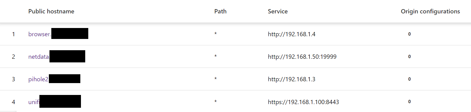

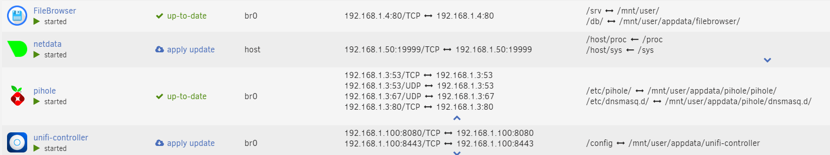

  7. Im trying to setup the tunnel and I have 2 questions. Its partially working: - browser (filebrowser) is working - netdata isnt working, i get the coudflare host error - pihole2 isnt working, i get a "No webpage was found for the web address" error - netdata isnt working, i get the coudflare host error So that's the first question: what's going on? All the addresses in "service" are good. I tried with in an incognito browser to avoid cache problems. My second question is: how can i use the tunnel on both things that have their own ip (ex: filebrowser) and others than use the unraid server ip (192.168.1.50 is the unraid server) Thanks!
