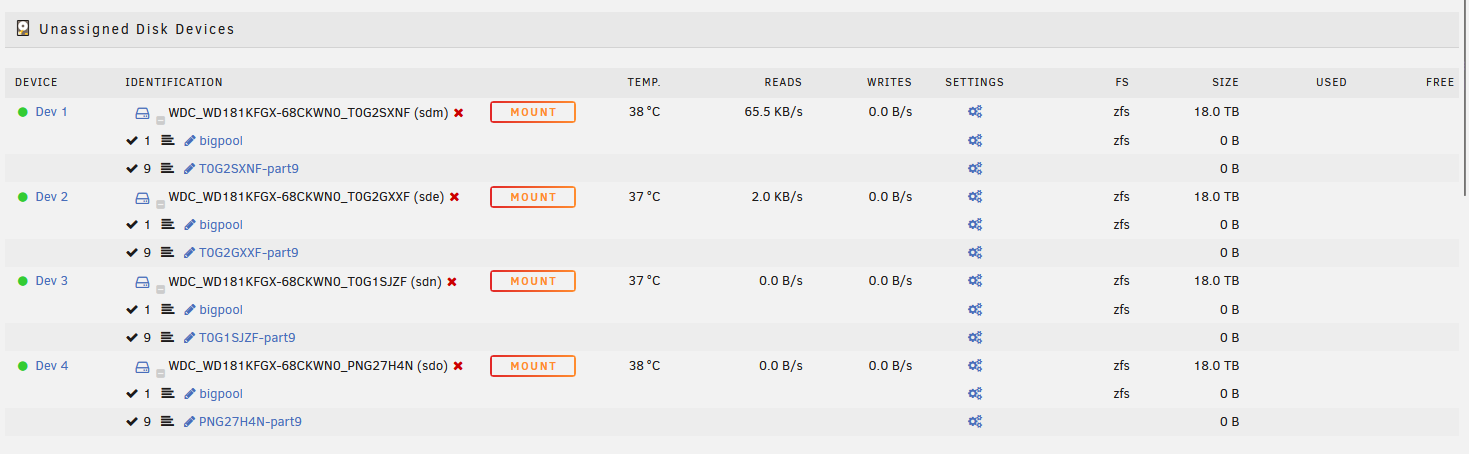

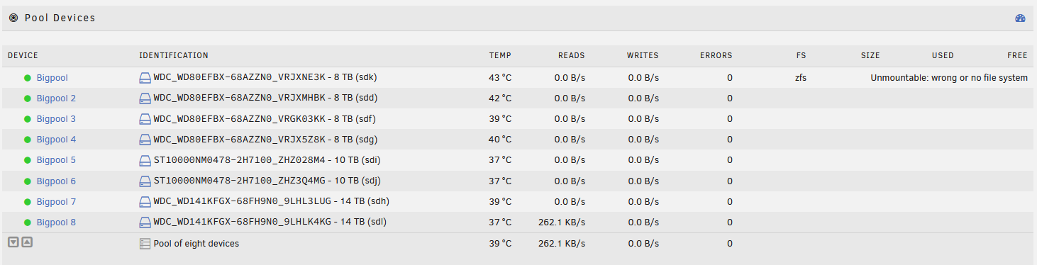

  1. I'm running 7.2.4. Have this issue where I've got 12 drives in a zpool, but only 8 of them are showing up in the Pool Devices section. The other 4 show as unassigned. They're definitely all in the same zpool though. Is there any way to rectify this? The other issue is this "Unmountable: wrong or no file system" error. I did manually create this zpool via the command line a while back, due to the limitations of the webUIs ability to handle different sized drives at the time. Each of the mirror sets in the pool are using identical drives. Edit: Adding Diag server-diagnostics-20260307-0717.zip
