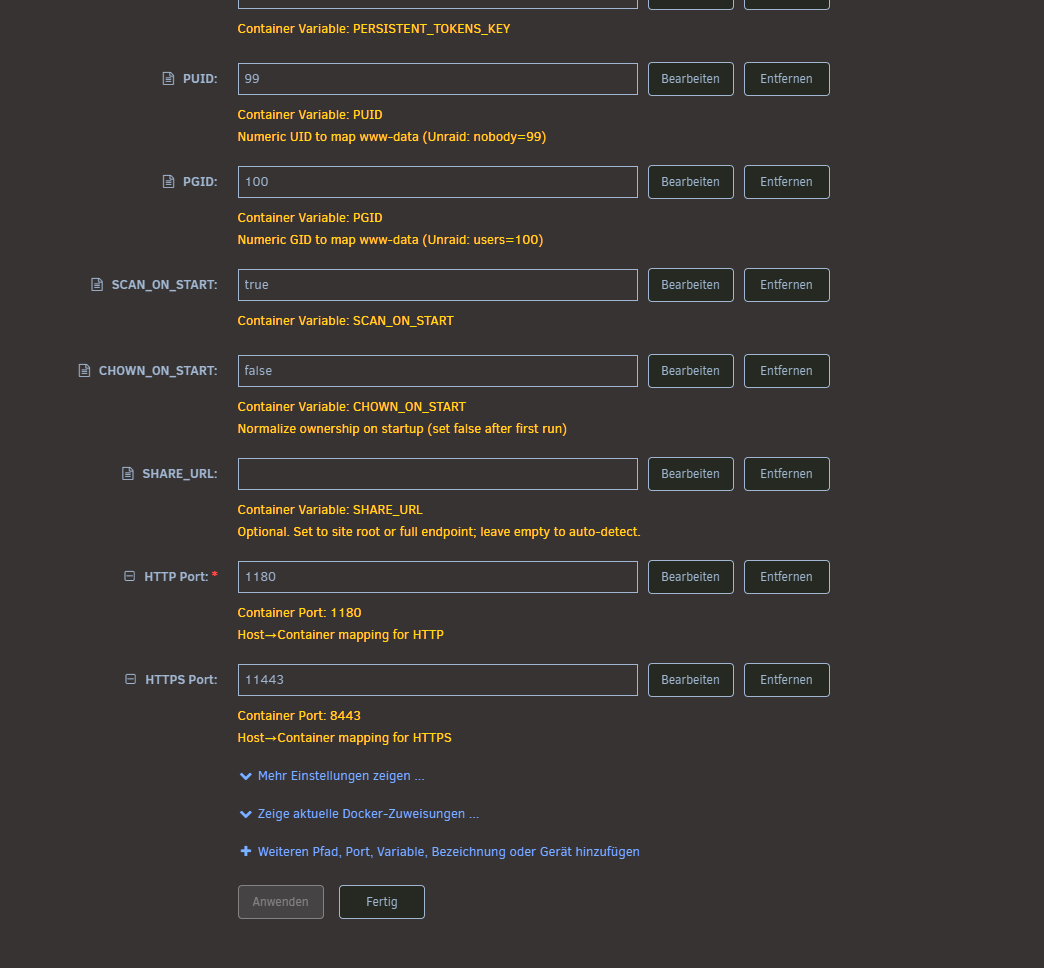

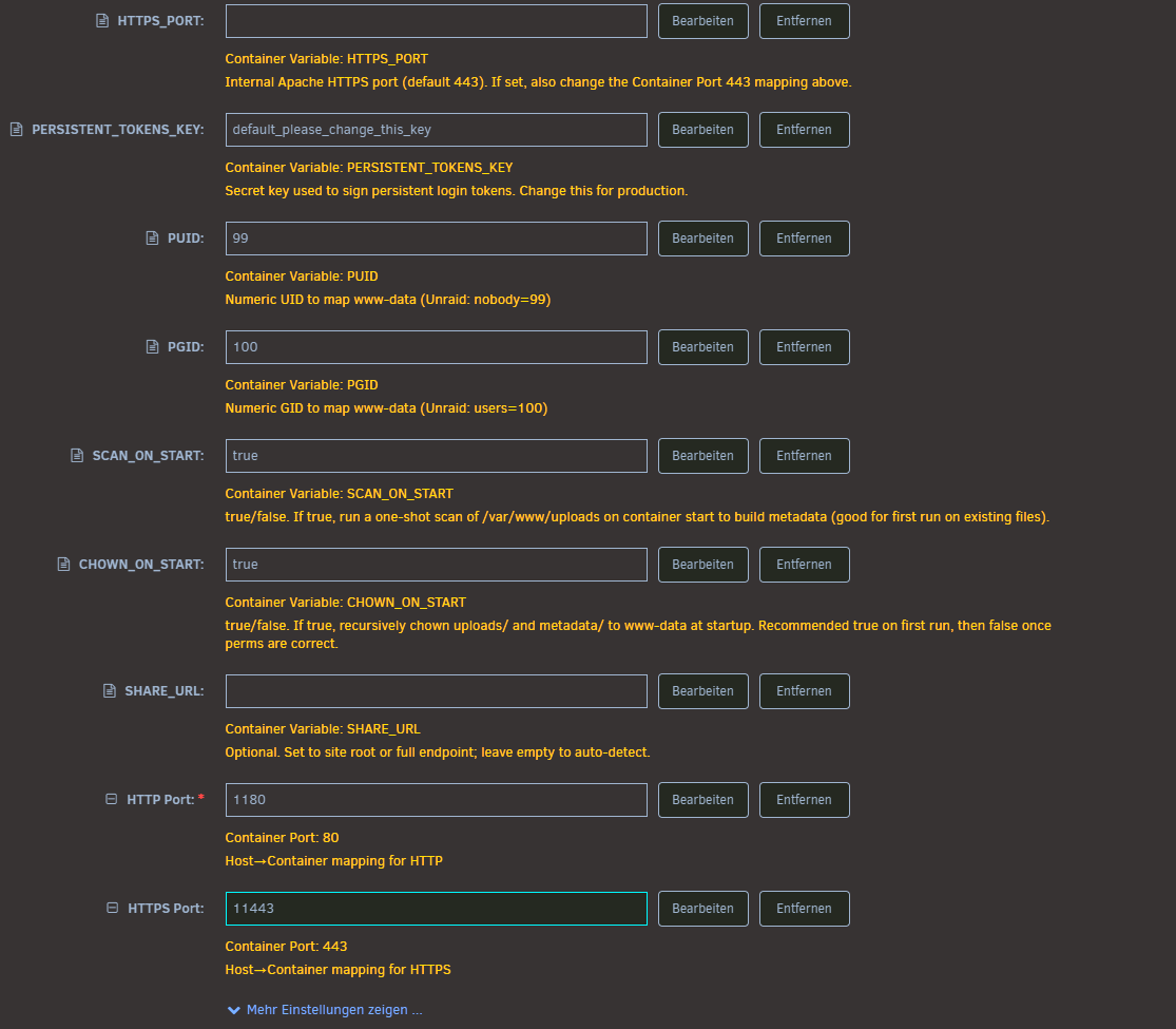

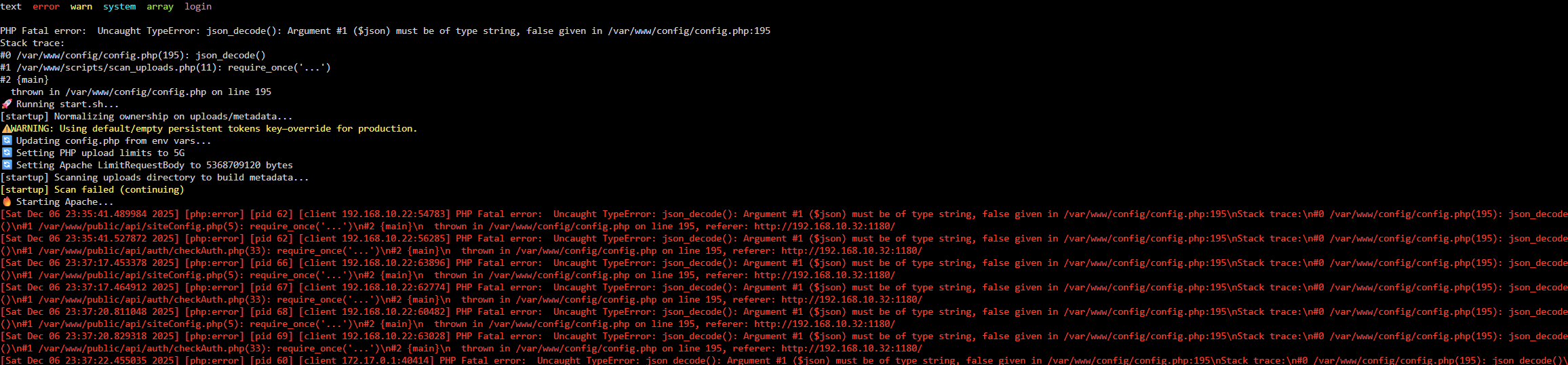

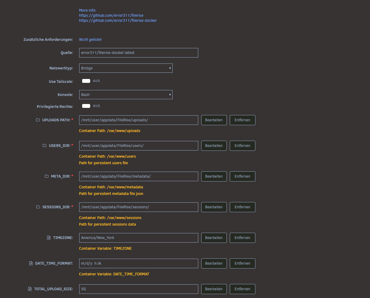

  4. reinstalled it sometimes again and again, but still the same problem. i dont get what is going wrong. i didnt change the ports. everything is like in my screenshot but still not working

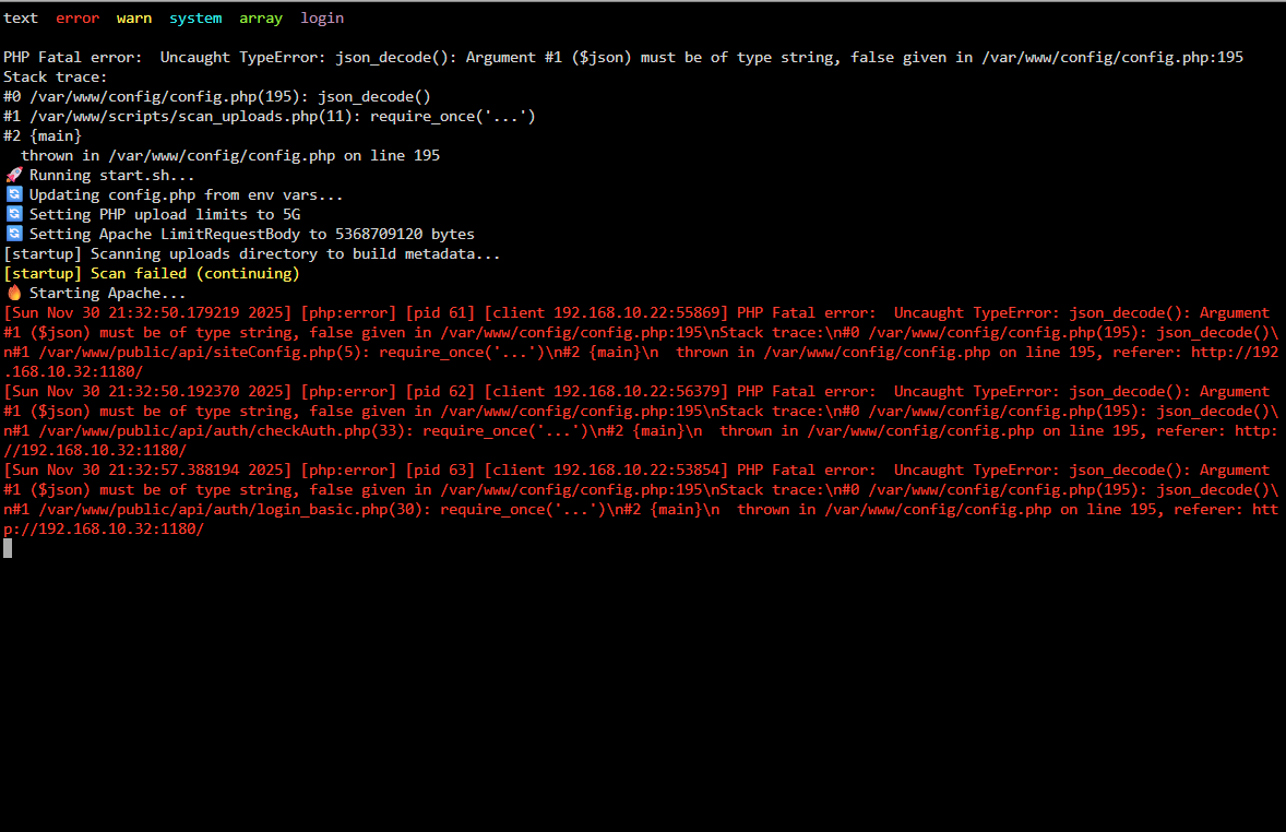

  5. now filereise deleted, new installed over apps in unraid: now it works with clicking on webui on the container, but my admin account cant login, "login failed" but also i see still this in the protokoll:
  6. ok i will try it in few minutes, but what about port 80 and 443, what if this ports are allready in use from an another container ? because you mean leave http port and https port default 80 and 443
  7. the screenshots from fileise edit: for Number 3. : yes of course i can connect the the local IP:Port and on this way to the container web ui ( the filerise loginpage ) but there i cant login, if i try that i get everytime the login error. Where exactly i can find devtools ?

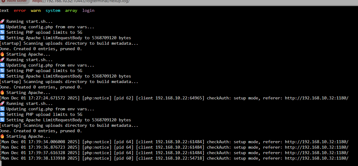

  8. i get the same result an a new private window / tab, other devicelike smartphone or laptop etc. on everyone comes the session not established error. if i try to open the container directly from dockerpool it dont opens because then docker gives me a site with port 10443 but i changed this to 1180. i have also a running nginx, now i tryed to use a redirect . thats works, also with login, but ony over the redirect adress, also not over the internet ip. then i would to look into the log file maybe it shows me somethings, there is see than that: i dont get whats the problem maybe somethings with the ports ?

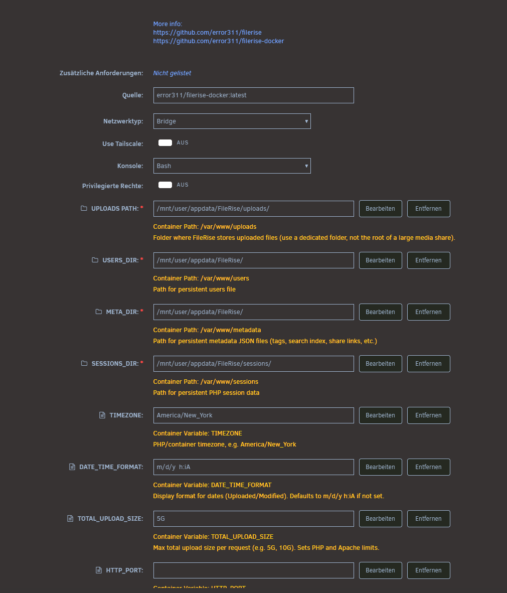

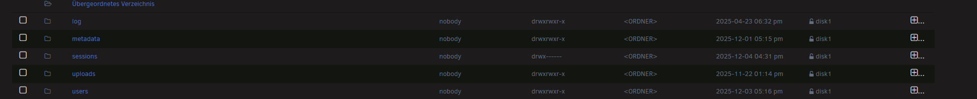

  10. i think here is everything right the host folder was not there, i created it manual in ../filerise/users/ i stopped the container and startet it after few minues fresh but still dont want to work
  11. ok this way brings me a little bit foreward, 2 steps maybe.. now the red Protokolls are gone, a New User added with Admin rights, but if i try to login, i get Error "Login session not established" in Container Edit" CHOWN_ON_START:" is allready set to "false", it was on true after reinstall and the first run and first Account setup but now, i restart the container sometimes. and try it again to login with the new created account, i get everytime this error After some restarts and trys i see in the protokoll that

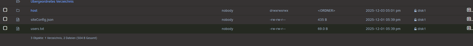

  12. i dont have a folder named user. only a file named users.txt, directly in appdata/filerise that users.txt i deleted now, also the file metadata.json isnt in a folder named metadata, thats also directly in appdata/ filerise. ok then how can i repair the broken files ? i havent a folder namend user. only a file directly in appdata/filerise i deleted it now again and installed it new but no changing

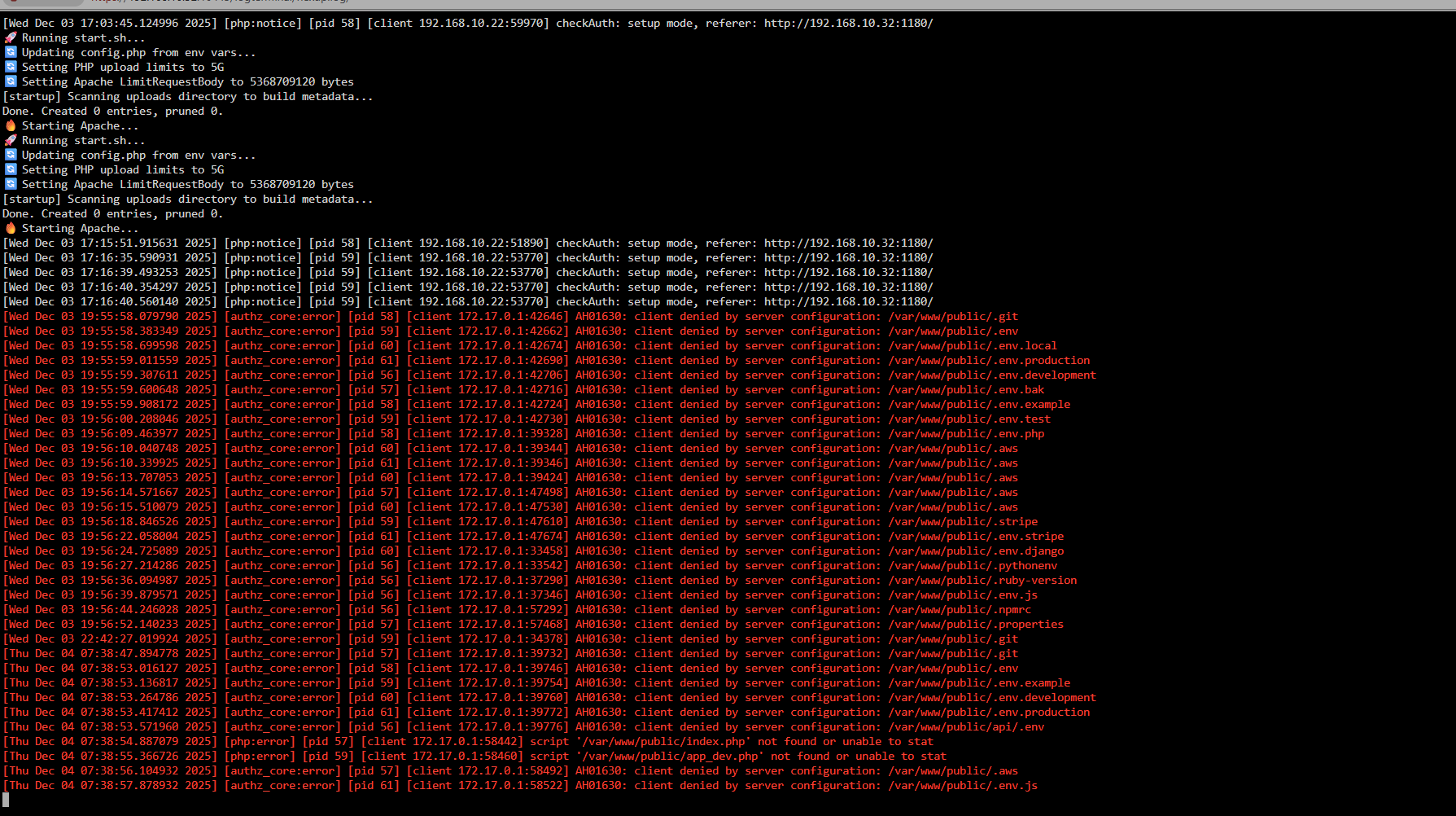

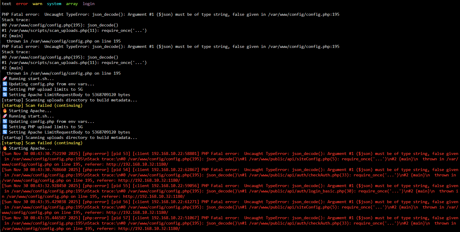

  13. i see, some updates was installed but without changes by me, so i reinstalled it and now it looks much different then before, but now i cant login with my account, the old password not works and also is it not possible to create a new admin account, can i delete somethings the user accounts will be resetted ? i looked now to the protokoll and it shows me this : its strange because i see there the ports are changing everytime the same like the pid numbers everytime i reload the webui , a new errorline comes in, but the webui opens normal, but the login dont works i dont remember i chance anything before at the first install. i reinstaled it now again but the error still stay
