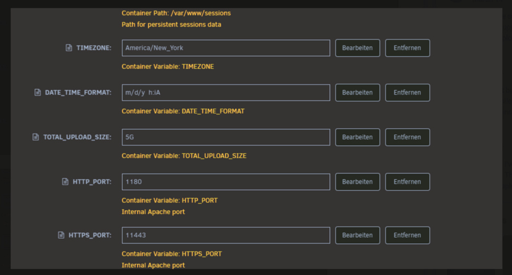

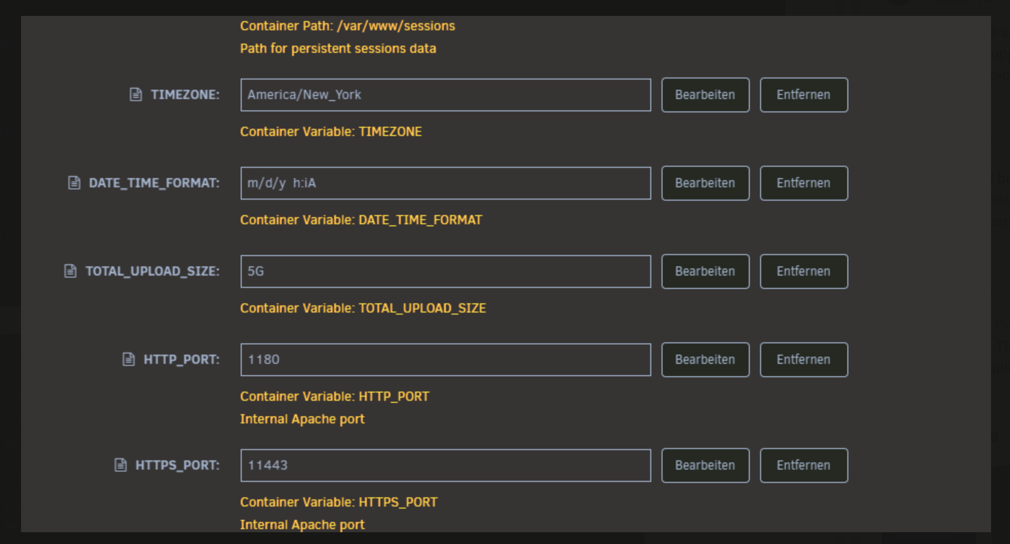

  6. Dont change these from your picture the Internal Apache port keep those as 80 and 443.
  7. @Eichhorn To simplify things and rule out all the weird edge cases, can you reset the container to a “known good” setup: 1. Stop and remove the current FileRise container (keep the appdata folders). 2. Re-add FileRise from the Unraid template with these settings: Network: bridge DO NOT change the internal Apache ports: Leave HTTP_PORT and HTTPS_PORT empty (defaults to 80/443 inside the container). Port mappings: Host 1180 > Container 80 (HTTP) (Optional) Host 11443 > Container 443 (HTTPS) PUID=99, PGID=100 (Unraid defaults) Set CHOWN_ON_START=true at least for this run, so the container can fix permissions on uploads/metadata/sessions. 3. Start the container, wait for it to finish the initial scan + chown in the logs. 4. In your browser, go directly to: • http://SERVER-IP:1180/ You should see the FileRise login page. 5. Try logging in again. Once this works on http://SERVER-IP:1180/, you can put a reverse proxy (nginx/Nginx Proxy Manager) in front if you want, but keeping Apache on 80/443 inside the container is the simplest and most tested layout.

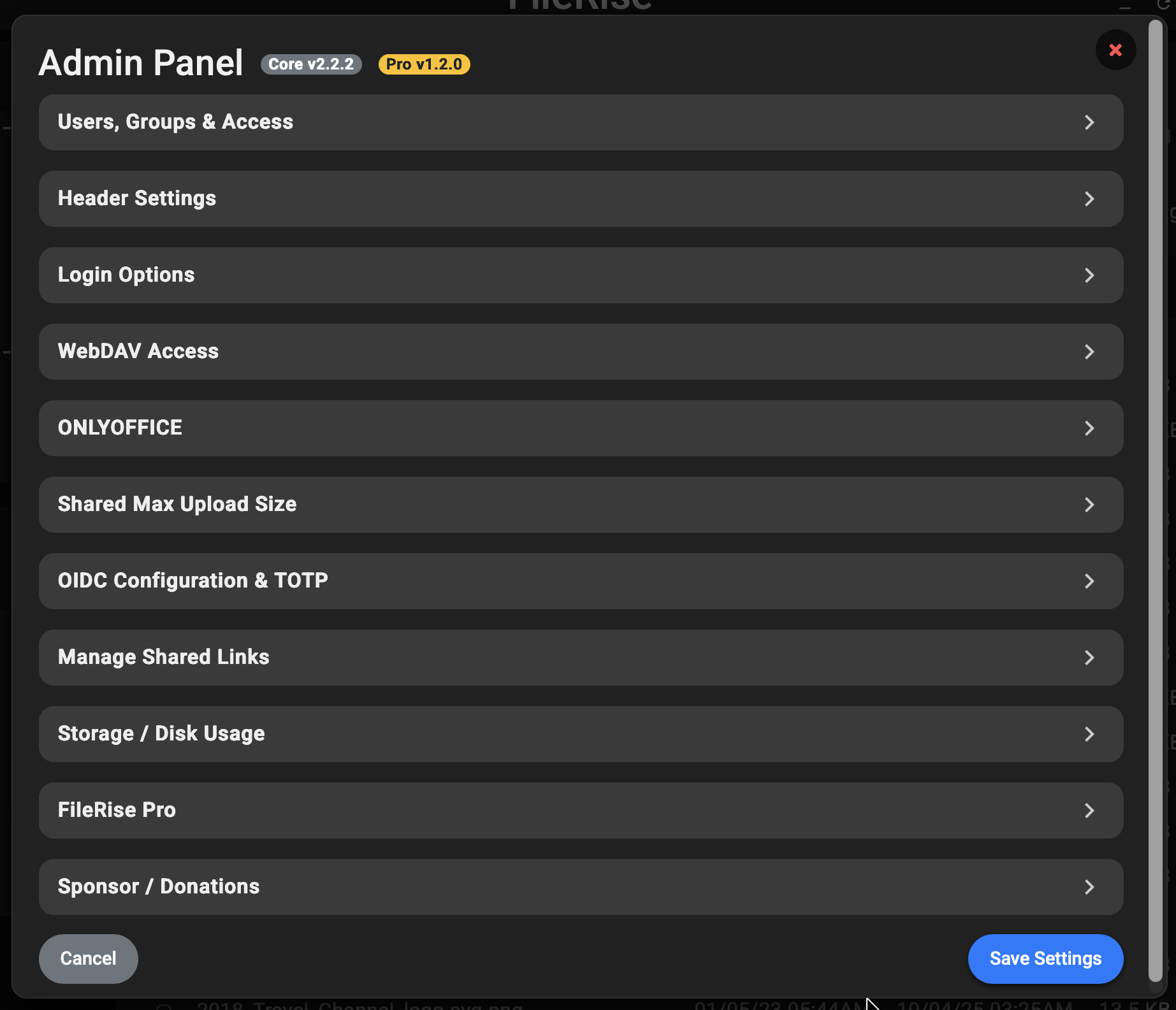

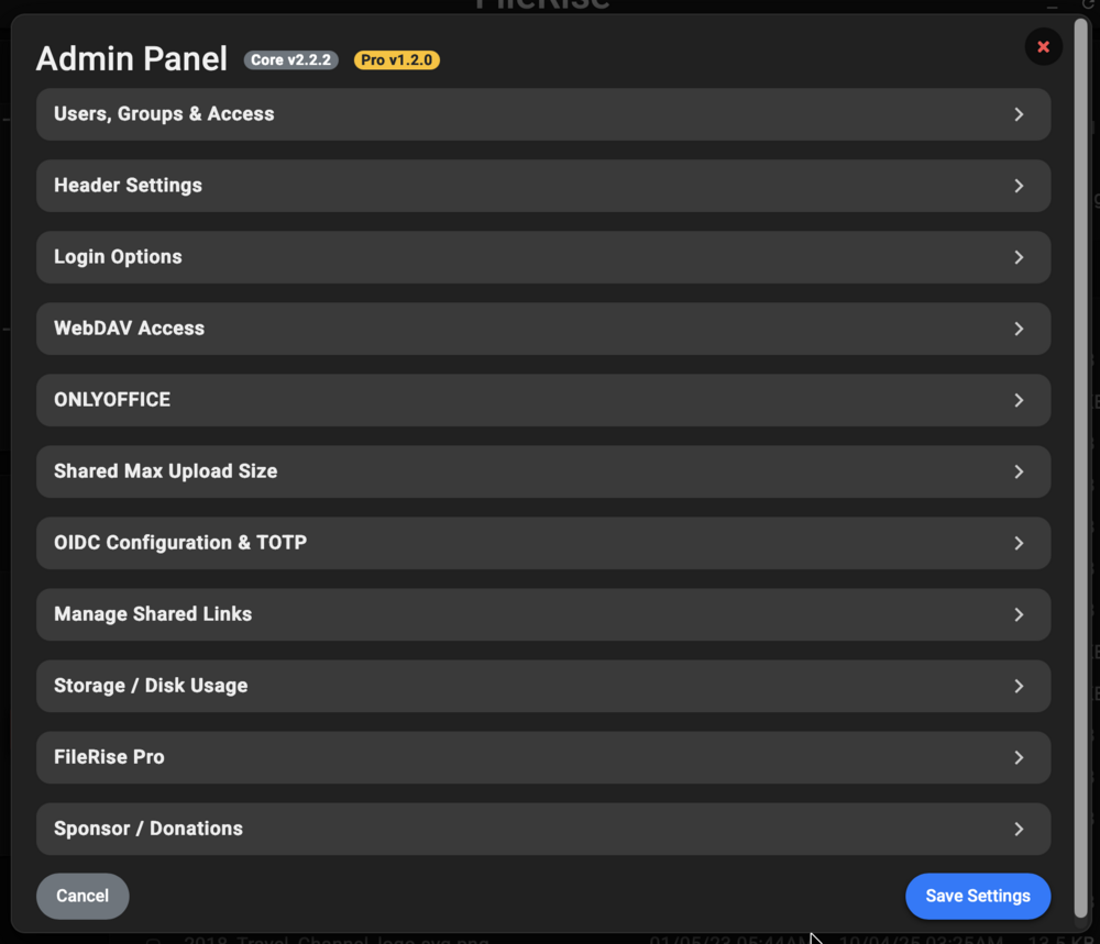

  14. @Eichhorn Every release change is here https://github.com/error311/FileRise/blob/master/CHANGELOG.md and Admin Panel shows the version here:
  15. No this is not normal and I did find/fix the bug. This is fixed in v2.0.3. Thank you for reporting the issue @Eichhorn
