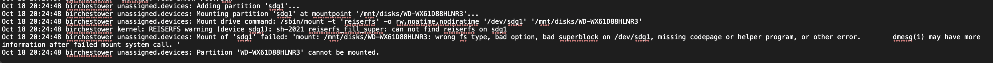

When I tried to mount the original 6gb drive that I messed up, which is now shows in unassigned devices I get this when I try to mount it Does this give any clues to what might be wrong?

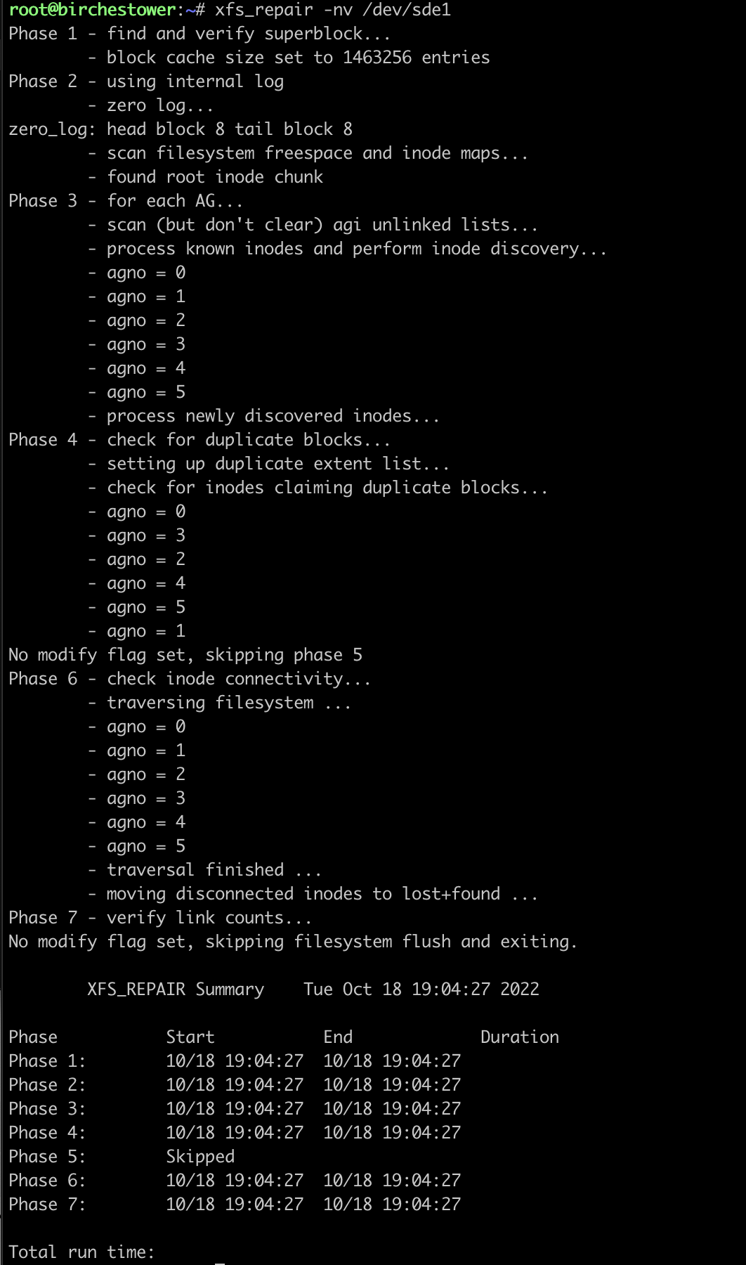

The rebuilt against the new drive finished but it shows as unmountable Reiserfsck is still giving error Unknown code er3k 127 so looking at another thread where some did the same as me I spotted the xfs_repair command. So running xfs_repair -nv /dev/sde1 I do get a readable output. Could it be worth trying to run xfs_repair without the n option? Or is it worth trying stop the array, edit the drive and change the format back to XFS? I'm grasping at straws I know

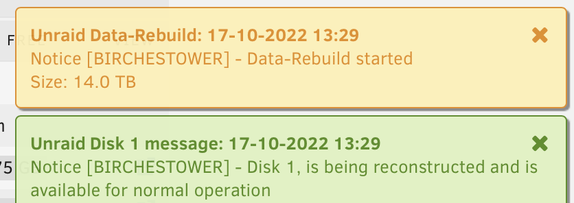

I've switched my new 14tb disk into disk position 1, replacing the one I was trying to change from reiserfs to XFS and it's showing the FS as ReiserFS and doing a data rebuild. Might I be lucky enough to end up with data on the new drive (albeit using the wrong format of reiserfs) at the end of the rebuid? If so I can worry about sorting that out later - which I guess involves coping the data off to one of the old 6gb drives (one reformatted to XFS) and showing as empty - then reformat the new 14tb drive and then copy back?

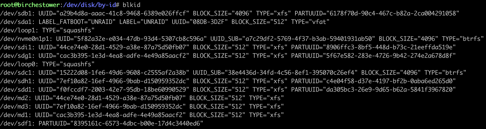

Attached are the logs after running reiserfsck --rebuild-sb /dev/md1 I've also ran the blkid command and that's still showing as all devices being XFS - but the device in question MD1 does show as being reiserfs in the UI Many thanks birchestower-diagnostics-20221017-1053.zip

I've looked at the thread above and another but whenever I try to use the command reiserfsck --rebuild-sb /dev/md1 I'm getting the error below. Unknown code er3k 127 Looks like I'm running reiserfsck 3.6.27 With the array stopped I'd changed the format from XFS back to ReiserFS and started the array in maintenance mode. Is that correct or would I need to start normally and do another format back to reiserfs back from XFS for the reiserfsck program to work correctly. Thanks for the input so far.
