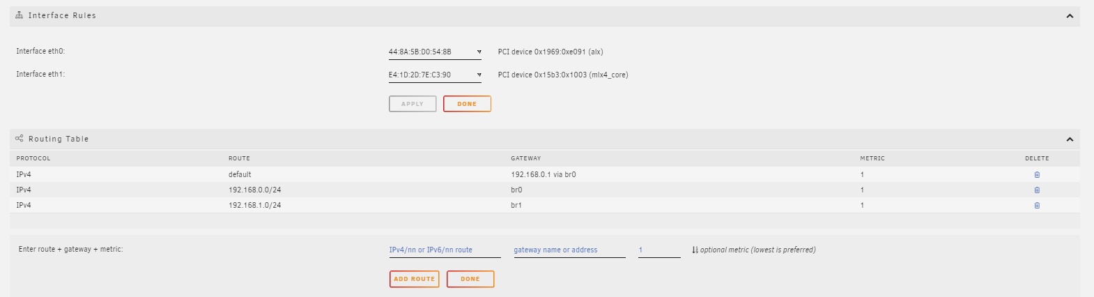

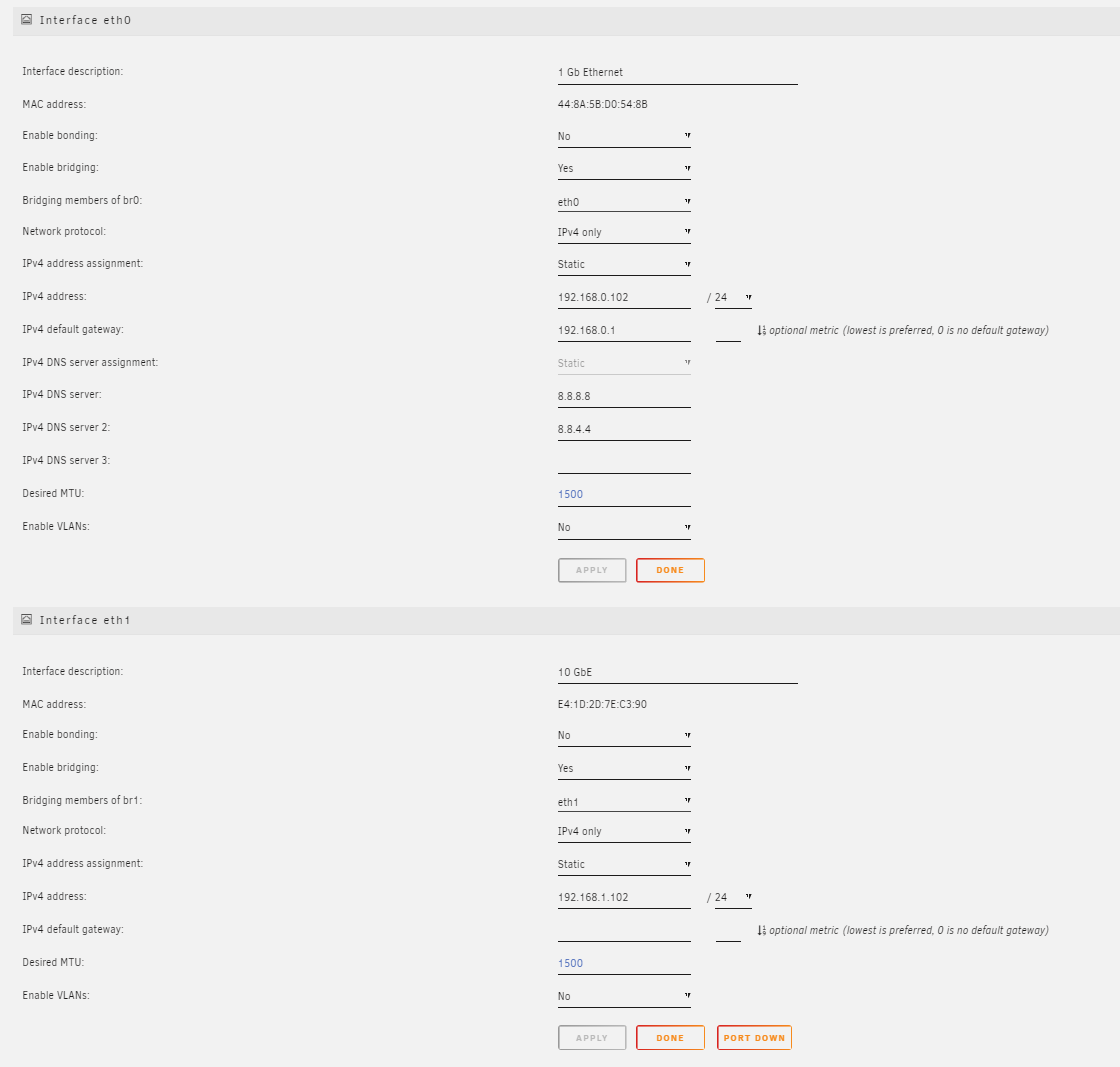

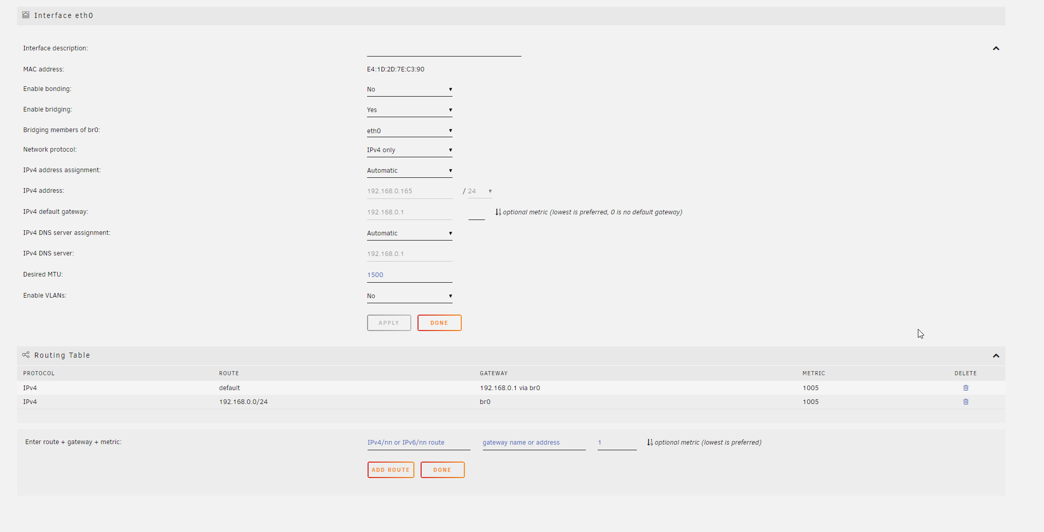

  8. And then these are my PC network settings. First one is Wi-Fi [should-be-]internet-only connection: And this is for the Mellanox 10GbE card: My cabling is as you described. PC has Wi-Fi USB adapter to router, and then 10GbE SFP+ cable running to server. Server has a 1 Gb ethernet cable running to router (via Powerline adapter, if that matters), and then that 10Gbe SFP+ cable running into the PC. Anything amiss that you're seeing in any of these screenshots? Let me know if you'd like another diagnostic report or anything. Thank you
  9. Okay, yeah that's what I thought... And that's exactly what I had set up and was trying to make work (maybe I didn't explain it well). My setup is based off this YouTube video (Windows version & Mellanox) : But yeah, for some reason my PC seems to think that the traffic from both of those network connections is linked or something. Seems very strange that the purely local 10GbE traffic would somehow interfere with the speed of the purely online traffic... Is there perhaps a PC setting or something that will tell my computer to stop associating the two? These are the Network Settings I had set up... I had a suspicion that it might be the Routing Table that needed adjusted, but it wouldn't let me add/edit anything, which is why I tried deleting the network.cfg originally:

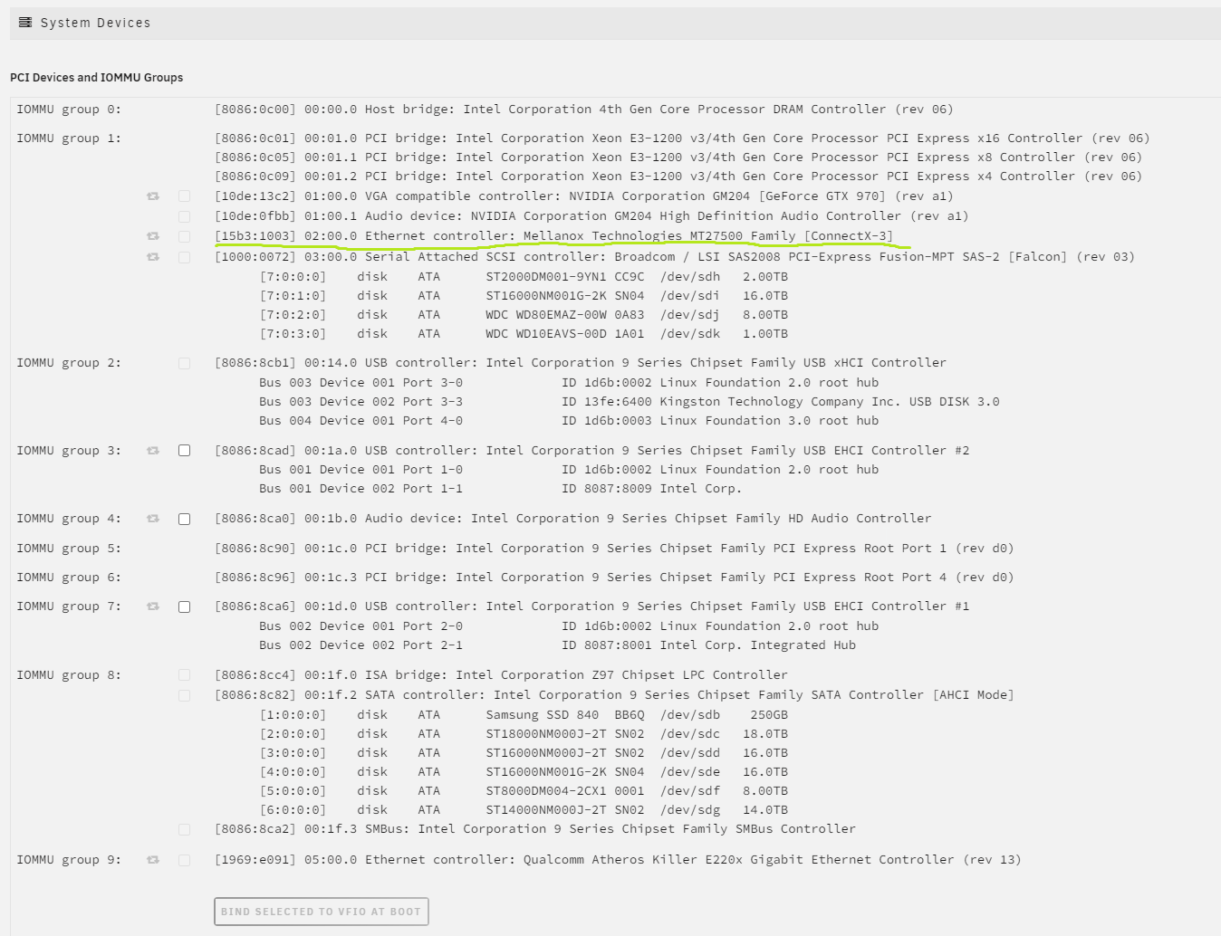

  11. Update: Didn't have any luck with deleting the network.cfg and rebooting, but I looked up the specs on my motherboard, and indeed the PCIe lanes weren't enough to power all 3 devices I had plugged in. I decided to just remove my graphics card entirely, and bump my MBA and the Mellanox up a slot. Bingo, worked like a charm. Apparently, the card was only working before because my network settings had already been established when I installed it. Deleting/resetting the network.cfg seems to have revealed my PCIe limitation there. I then went back and tried the solution @MAM59 mentioned to my original problem, bridging the 10GbE and regular ethernet connections. It does work pretty well, and I've been testing it the past couple days. But it still seems like there's a bit of interference between the two connections (heavy server usage affects my internet speed and vice versa). Is there any way to simply isolate the 2 connections from each other? Have one line into my PC for internet, one line out to my server, and have the bandwidth from each not affect the other at all? I appreciate all your guys' help so far.

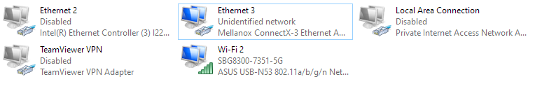

  12. Hmm... Thank you for the response. That sounds like it might be a good solution to what I was trying to accomplish originally. And I tried it just now to be sure, but it appears that my 2nd issue still remains... That I'm not able to use my Mellanox connection to connect to the Unraid server in the first place (caused by whatever happened when I deleted the network.cfg file). Since then, it's stopped showing up in my Network Settings at all, no matter how I've tried to configure it. (I lose access to the Web GUI when I try to connect any way except for through my Wi-Fi and the server's default ethernet<->router connection) This is what I'm seeing in the Web GUI. And yet it looks like it's still being detected in System Devices... And this is what I'm seeing in Windows Network Connections: Any other ideas as to what might be causing this?
