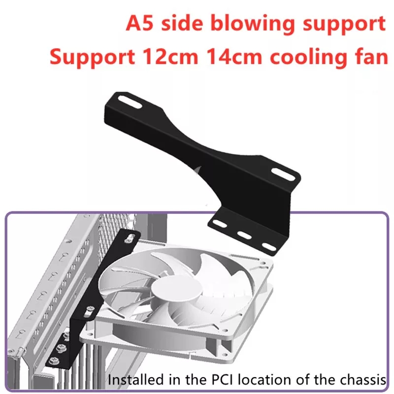

  6. Motherboard has more free fan connectors. But the tower case has no place to screw another fan onto the side of the case, which could blow air to the cards from top direction. I'm thinking on top cooling fan like this: Vertical heat dissipation of North South Bridge, Support 12cm 14cm cooling fan: https://a.aliexpress.com/_mtUjYPK This might be placed over the LSI card to provide further cooling.

  8. I use Thermaltake Armor tower case. It does not seem to be possible to attach side fan: https://www.newegg.com/amp/black-thermaltake-armor-series-atx-full-tower/p/N82E16811133154
