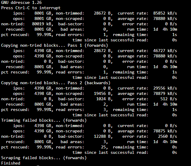

  4. Ok, finally got all the files transferred and did the repair. Server still stuck at mounting on disk2 when trying to start the array with the new cloned HD in the disk3 spot. Am I missing a step? I let it try to mount all night. reaper-diagnostics-20230319-0837.zip
  5. oh snap! I think we are getting somewhere!
  6. Oh, I did ddrescure with the array stopped. My apologies for the mix up. Should I try it on the parity drive?

  10. Ok, I did ddresucre, I'm a bit confused because it finished instantly.. Was this drive empty?

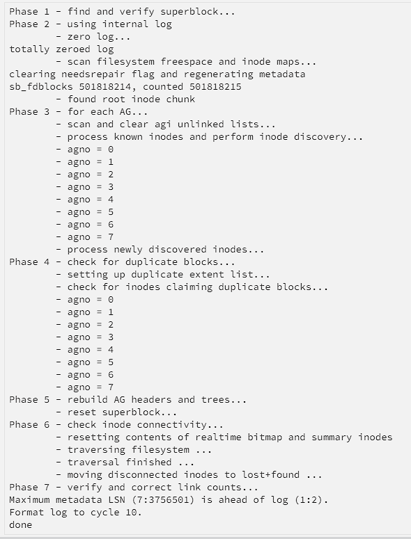

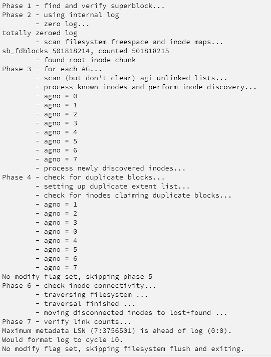

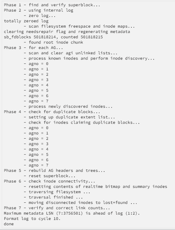

  18. This is what I got. This was with -L and the previous post was with -n

  20. Ok, I did a new config and have the parity syncing. I will let you know the outcome in like 15 hours! Thank you!!!
