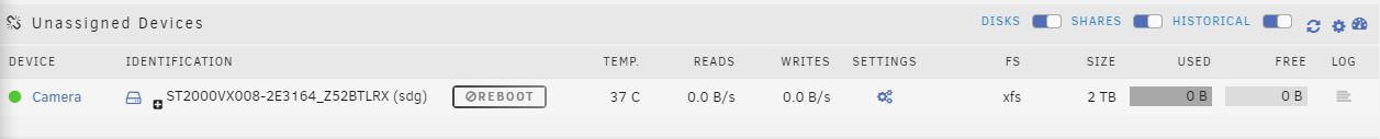

  6. No, all 4 of my sata ports are used😒. I can try and buy a pci sata or usb card
  7. I changed the cable and the port but no succes. If i'm correct i get this because the disk is disconnecting? Attached a full diagnostic server-diagnostics-20221024-1436.zip
