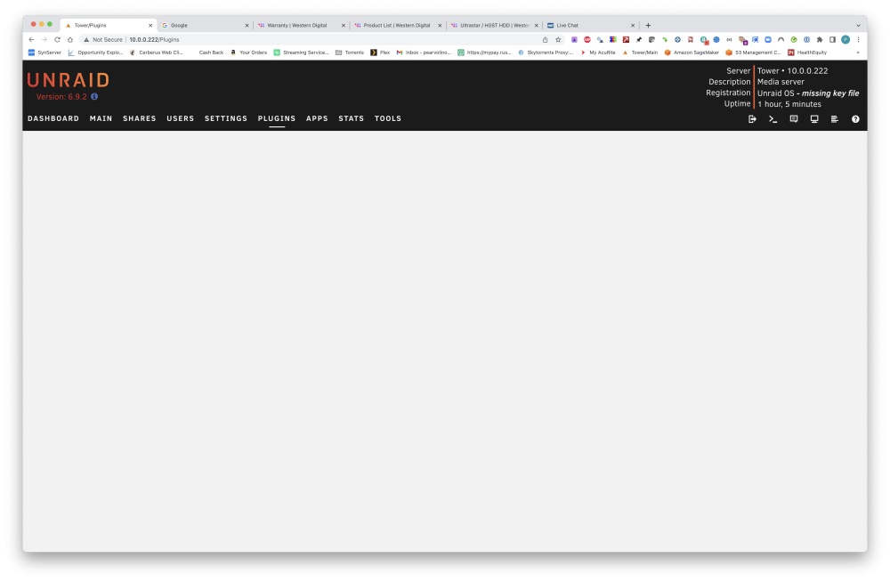

  7. OK, I have done this. all disks up except parity. one last thing, i hope: I am apparently now missing a key.
  8. never mind, i got the new config to work. starting array now

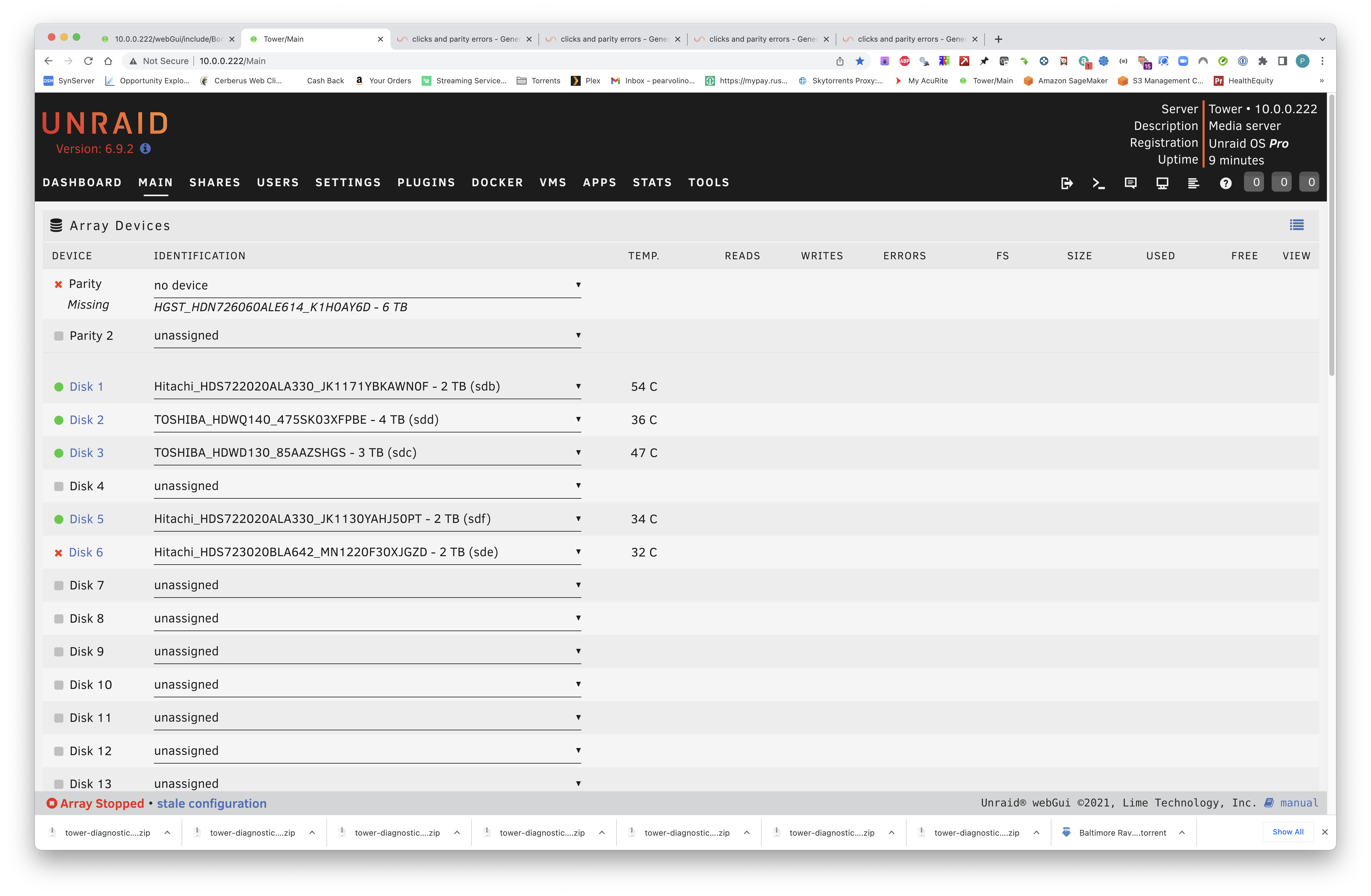

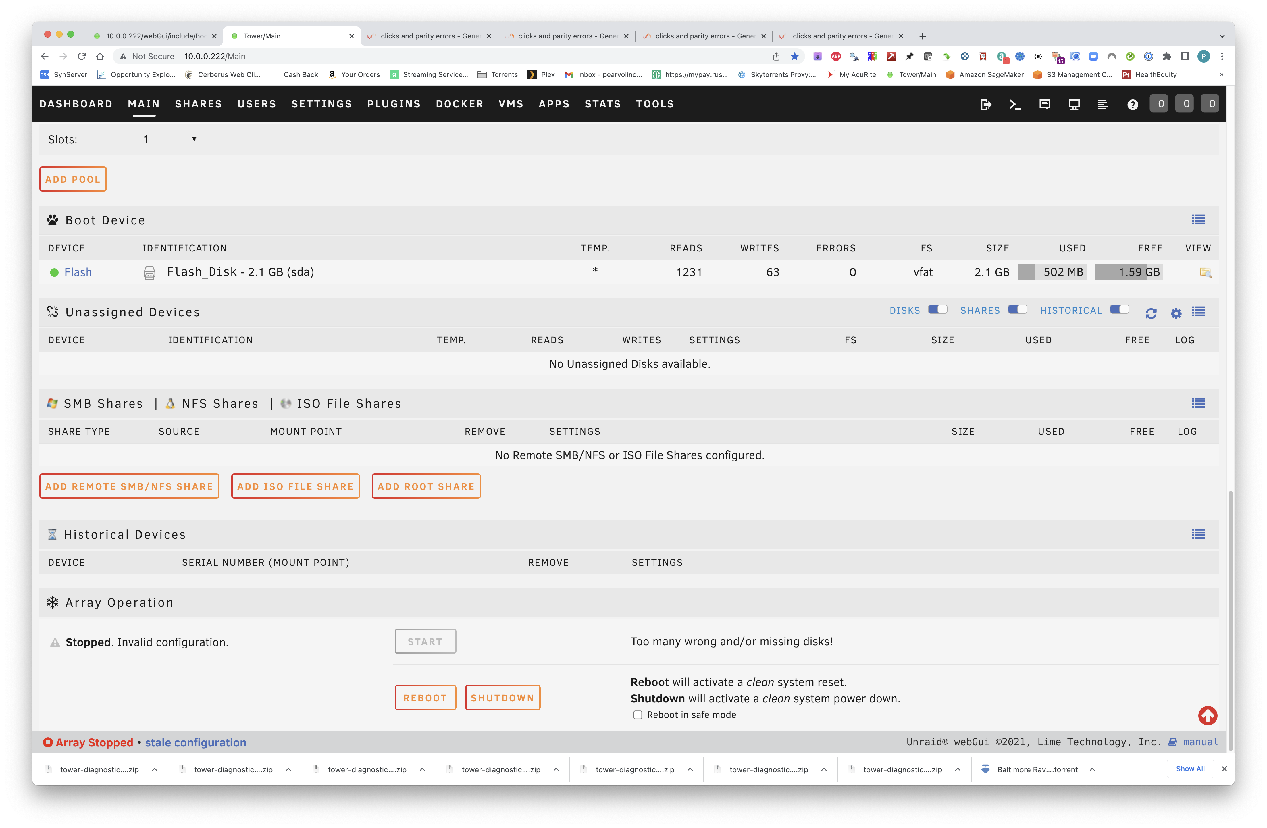

  9. Start button still grayed out. screenshot. At least disk 6 is not italicized (is selectable in the dropdown menu: see screenshot).
  10. If I were to get disk 6 fixed (command line utilities), wouldn't this be the same scenario as replacing a failed parity drive?

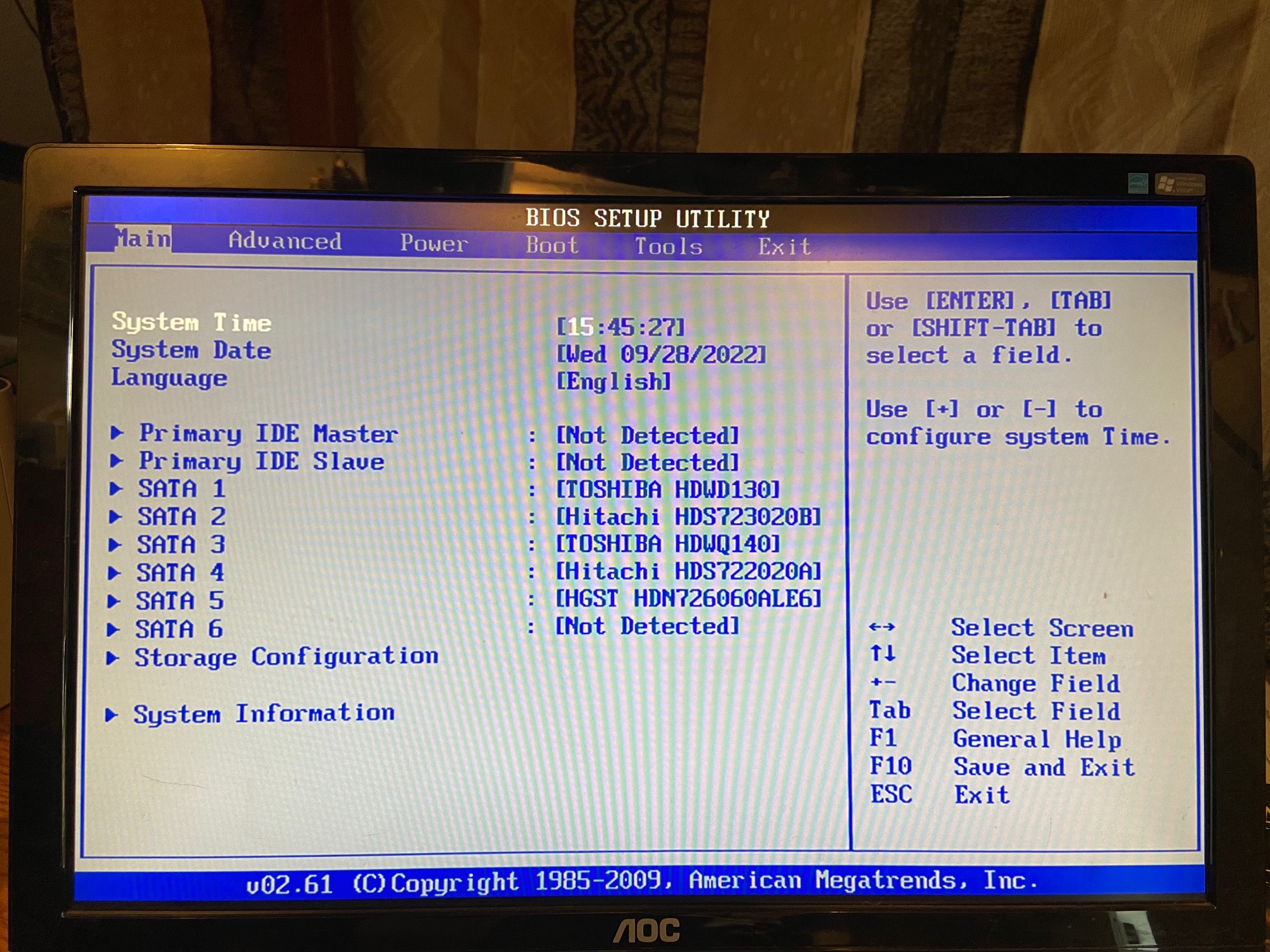

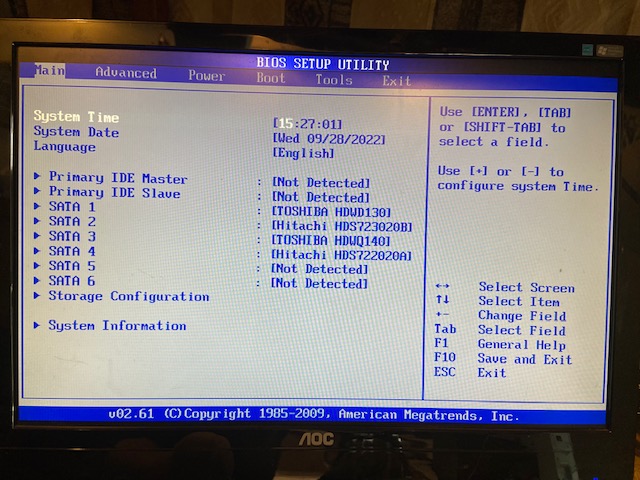

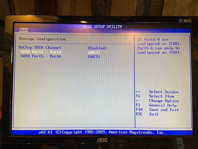

  12. Parity still not detected. diags attached could it be a problem with the drive itself? wouldn't it at least be recognized? tower-diagnostics-20220928-1130.zip
  13. It was SATA5, which is now, after setting to ahci, no longer being recognized (it was being recognized earlier, on the BIOS SETUP UTILITY screen like above, before changing to AHCI). Resetting SATA5 and SATA6 to IDE and rebooting now shows the parity drive (HGST on SATA5). screenshot attached.
  14. I have attached the screen display after boot from flash drive. Per that it looks like I have all SATA devices. Also screen shot in BIOS utilty.
