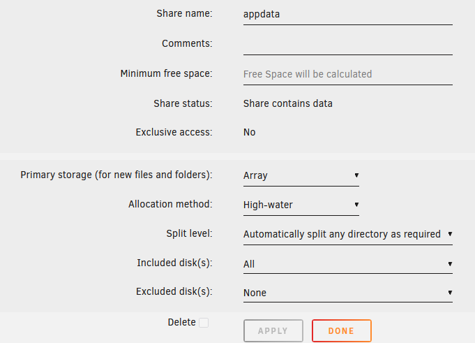

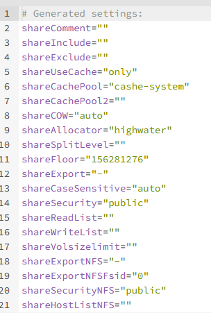

  7. So, I shutdown the server, took the flash drive out and viewed the file .cfg file on my laptop. The first image is from the flash drive and the second is from the appdata share after reboot. Notice how the primary stoarage has been changed to "Array" !!!!
  8. I definitely applied the changes then hit the done key. The image above is from the config/shares/appdata.cfg from the flash drive and contains the change to the primary storage which was "Array" after the reboot and the date on the .cfg file also reflects that 14/5/2025.

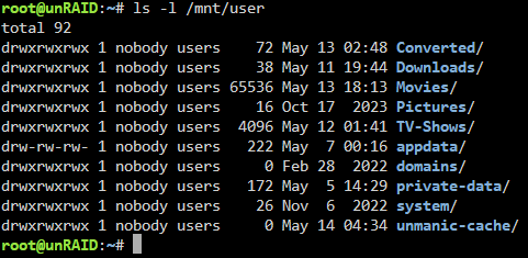

  9. This is what I see now accessing the flash drive from within UNRAID. It looks fine to me. Is it possible that the changes I did to the share after the reboot are cashed and are not being written to the flash drive? I can shut down the server and check the flash drive on another computer just to make sure.
