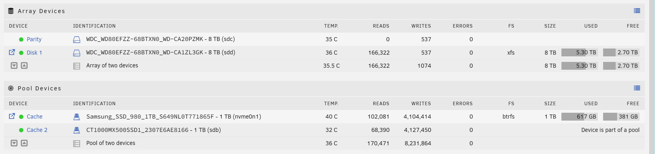

  3. Here is what I understand the SSD I added seems to be faulty. My plan is the following. Move back to only the NVME drive and format the cache pool. Check the SSD and RMA it if faulty. I also realised when re-reading the docs that I should have setup a weekly scrub I will of course do this moving forward.

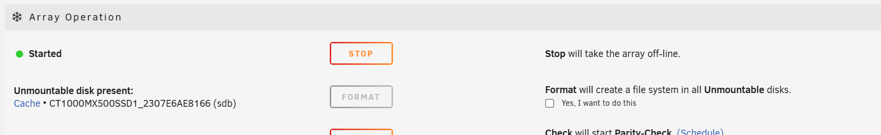

  5. Here it is : No valid Btrfs found on /dev/nvme0n1p1 ERROR: open ctree failed Tried enabling the cache again for appadata but seeing this warning again in the logs : Sep 11 20:33:00 Tower kernel: BTRFS error (device sdb1: state EA): parent transid verify failed on logical 719207088128 mirror 1 wanted 823173 found 822614

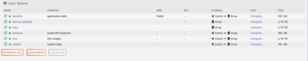

  8. Ok so for the moment I've set everything to array only to get my services back online. Not too sure what to with the cache drives at the moment.
  9. It's still connected yes but I removed it from the cache.
  10. Should I set back my cache pools to the two SSDs ?
  11. Here is the output : Label: none uuid: dfdf7994-b9ed-4e6b-b3da-0ead374259ce Total devices 1 FS bytes used 702.71MiB devid 1 size 20.00GiB used 1.52GiB path /dev/loop2 Label: none uuid: 2fd959e1-0d66-4d1a-9b0f-746a3f6520fb Total devices 1 FS bytes used 412.00KiB devid 1 size 1.00GiB used 126.38MiB path /dev/loop3 warning, device 1 is missing Label: none uuid: facc2023-c5f7-4fe2-936d-d24631bef1c6 Total devices 2 FS bytes used 574.28GiB devid 2 size 931.51GiB used 605.03GiB path /dev/sdb1 *** Some devices missing

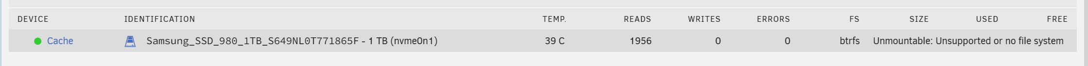

  13. Ok so I shutdown my server and unplugged my non NVME SSD thinking it was maybe the issue but it looks like my NVME drive is bad.
