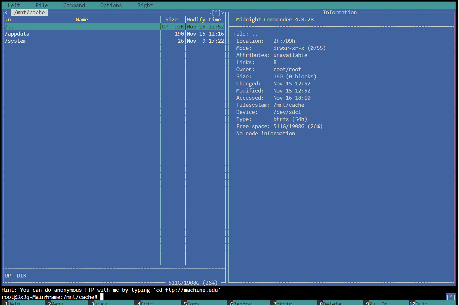

  8. Right, that's my point. The .img data still appears to be on the cache disk as it should be, but the path reference to that data is gone. Unless the Mover utility is a flawless piece of code, my suspicion is that Mover for some reason thought it had successfully moved the .img from cache to array and removed the original reference to it.
  9. Is it possible that the Mover may have (for some reason) tried to move it from cache to disk and, because VM was running, it messed up the moving process? The vdisk data does not seem corrupted, since it's still booted and running perfectly. It's almost as if the path to the vdisk .img file has been forgotten by Unraid, and the phantom .img file isn't being overwritten/corrupted by new data because it's still in use.

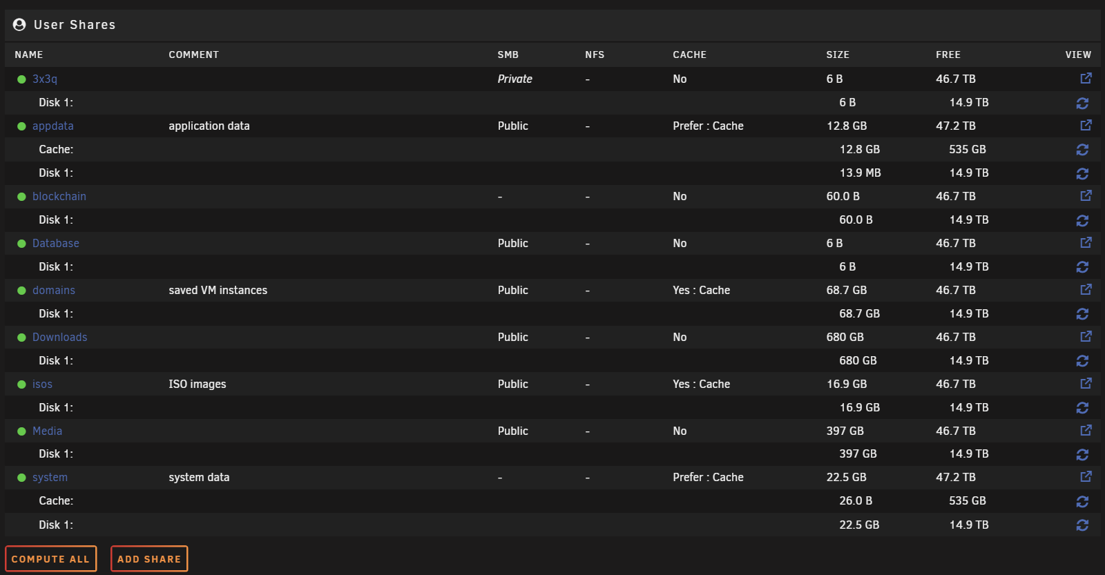

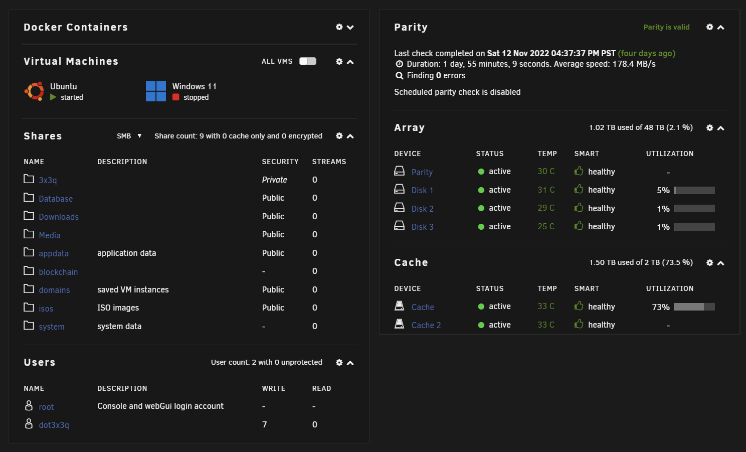

  12. Here are my shares computed, along with a fresh diagnostics file. What's interesting is that my cache is reporting that there's roughly 0.5 of 2TB free, which would be consistent with a 1.5TB .img file existing on the cache somewhere. Obviously the domains share only reporting anything on Disk1 is a problem. I've just gone through my drives again without detecting the vdisk, but the VM is still running and cranking away. Thanks for your reply Jorge. 3x3q-mainframe-diagnostics-20221117-0943.zip
  13. 3x3q changed their profile photo

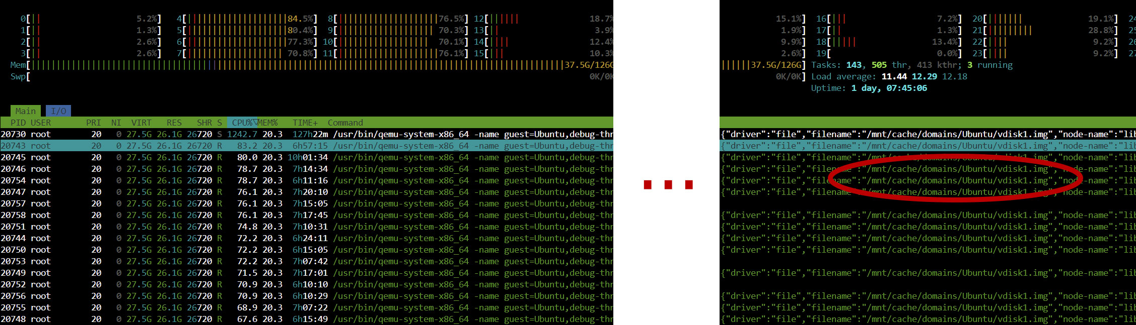

  14. Thought I'd follow up with some more info on my setup. Like I said, the VM is currently RUNNING, with no apparent vdisk on any of my drives. The last screenshot is of HTOP showing the VM processes, and also of its perceived location on my disk. Someone please just tell me that the .img file will appear after shutting the VM down and the data consolidates... or something like that. You may have noticed that Ubuntu is under heavy CPU/SSD load, and that's because it's processing things that are very special and important to me. EDIT: Following up with Ubuntu VM log file, in case it helps with anything. Ubuntu VM Logs.txt
  15. I believe this is happening to me right now. My Ubuntu VM is currently running just fine, but by pure chance, I noticed that I could not find the vdisk.img for this VM. Google'd "disappearing vdisk" and found this thread full of people who've had this happen. Now I'm terrified to shut down the VM for fear that it'll be lost into the abyss. Ubuntu vdisk was installed to /mnt/user/domains/Ubuntu/ on cache pool. The domains share is set to prefer the cache. Is there any situation where the vdisk still exists, but it just isn't displayed in Unraid? Is it just not showing up because it's currently running? Thanks! EDIT: I should also mention that this VM .img file is around 1.6TB in size, so it's very large. I wonder if that has something to do with it? 3x3q-mainframe-diagnostics-20221116-1726.zip
