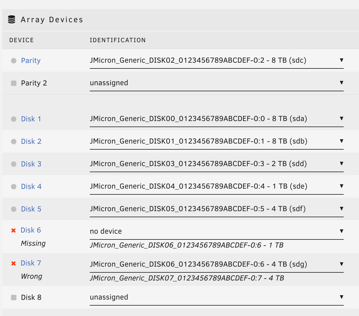

  8. Hi there. My old USB drive started to fail, so I swapped it but I am getting an error when trying to replace the key. I guess in the mean time I'll put the dodgy one back in.
  9. Yeah. I realise that they’re not recommended but needs must. Out of interest - why is it not possible for unraid to use the Linux block device UUID to identify drives?
  10. Nevermind. I found the "New config" option in tools. Thanks anyway!
  11. Hi folks. I have a home build which uses one of these 8 bay USB enclosures from Orico. I bought three new 8TB drives and stuffed the remaining ports full of whatever I had lying around. It's been running fine for several months. I decided to pull one of the older 1TB drives (it is empty anyway) to make room for adding a second parity drive (soon - I haven't ordered it yet) however it appears that the device ID's are based on the order that they're iterated and not the slot that they're in (which is annoying in and of itself). Is there any way to start the array having removed Disk 6 and pointed Disk 7 at the same device but with now a different device ID? To be clear, Disk 7 is in the same physical slot as before - I simply removed the drive from the slot next to it. In the mean time I'll put the 1TB drive back in the enclosure so that I can start the array. Thanks!
