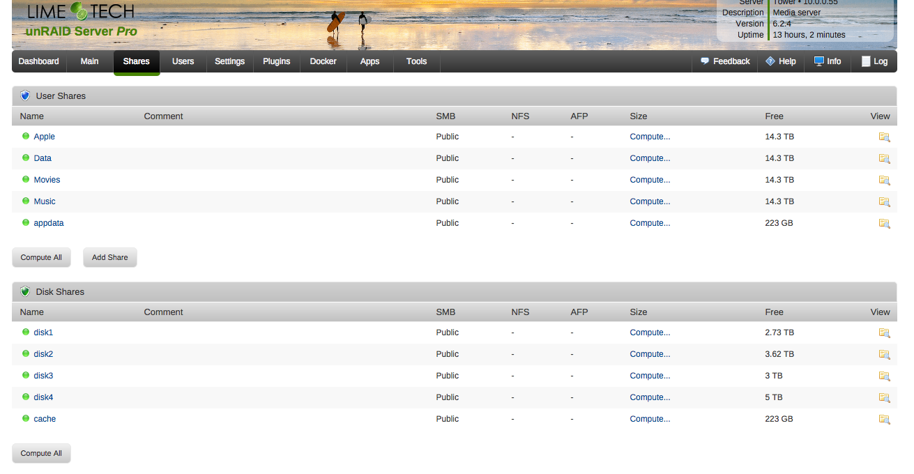

  15. Too Large for both - Screen shot below:
  16. Sorry Trurl, In a "rush", got called to hospital for a case. I did try to get a log file but it was too big to include. User Shares/diags attached. Parity re-check still in process. My bad, Dave tower-diagnostics-20161218-0539.zip
