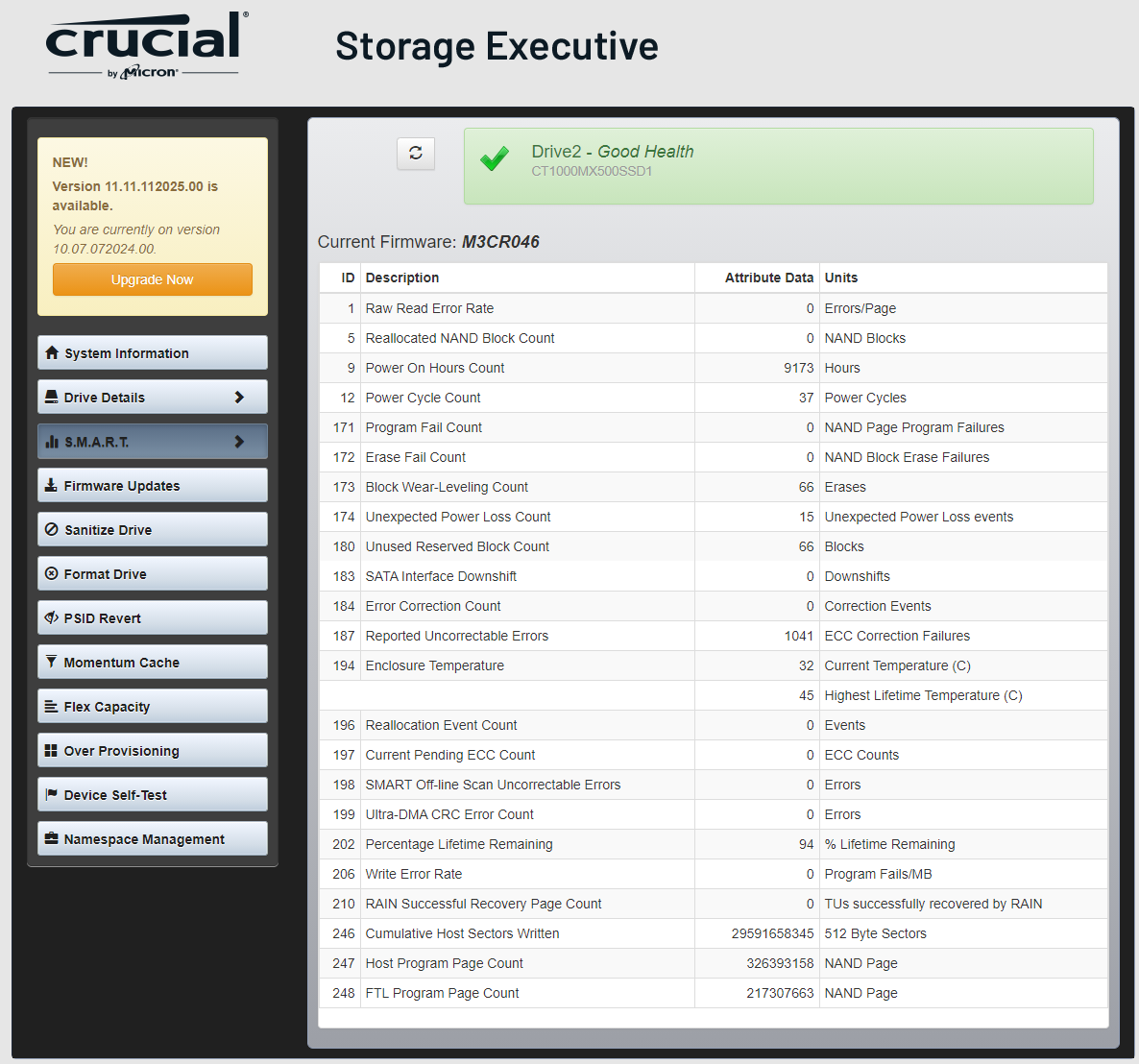

Crucial MX500 uncorrectable errors, drive still in "good health"?
thank you, that was good to know. i'll put the drive back in and see if it causes more problems. thanks @JorgeB @whipdancer
but if data is getting corrupted during read/write, then the drive is essentially unusable. will they replace it only if the drive is completely dead due to hardware failure? they guy is saying that the uncorrectable errors is not of concern but didn't explain what those errors mean. i feel cheated.
Last week my cache pool failed and i had to replace this drive and reinstall all my dockers. I sent a complaint to Crucial since the drive is still under warranty (less than 2 years old). They asked to use their Storage Executive software and send them the SMART information (which i attach here). They came back with this reply: I don't understand how they can say the drive is fine, don't the uncorrectable errors mean something? I believe the SATA connections were fine since there were no UDMA CRC errors before this. there were no problems after I swapped the replacement drive to the same slot. Does any one have some experience with this?

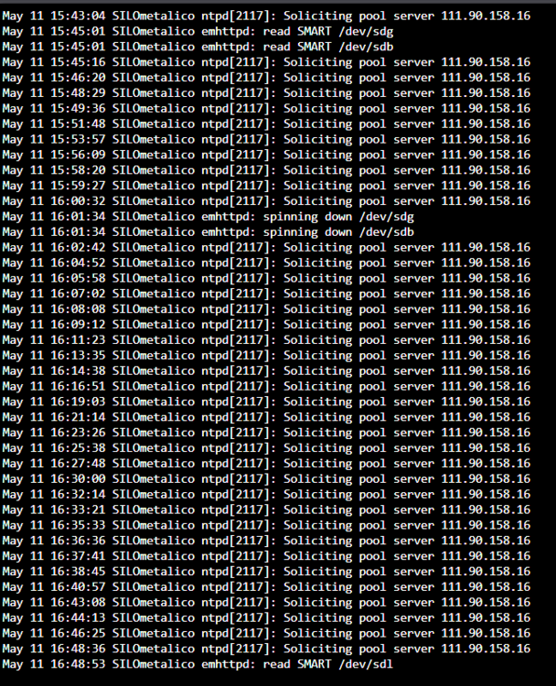

Logs full of "Soliciting pool server" events after upgrade to 7.1.1
it was using the default pool.ntp.org and was getting replies when pinged from unraid terminal. anyway i changed it to time.google.com and see how it goes. so far, its been 5 minutes and the messages have not appeared so maybe changing it google NTP server fixed it. thanks guys.
I upgraded from 7.0.0 to 7.0.1 yesterday. Everything went smoothly, and I didn't encounter any problems. However after the upgrade my logs are full of "Soliciting pool server" events, they repeat about every minute. Any idea what's the reason for this? Thanks.
