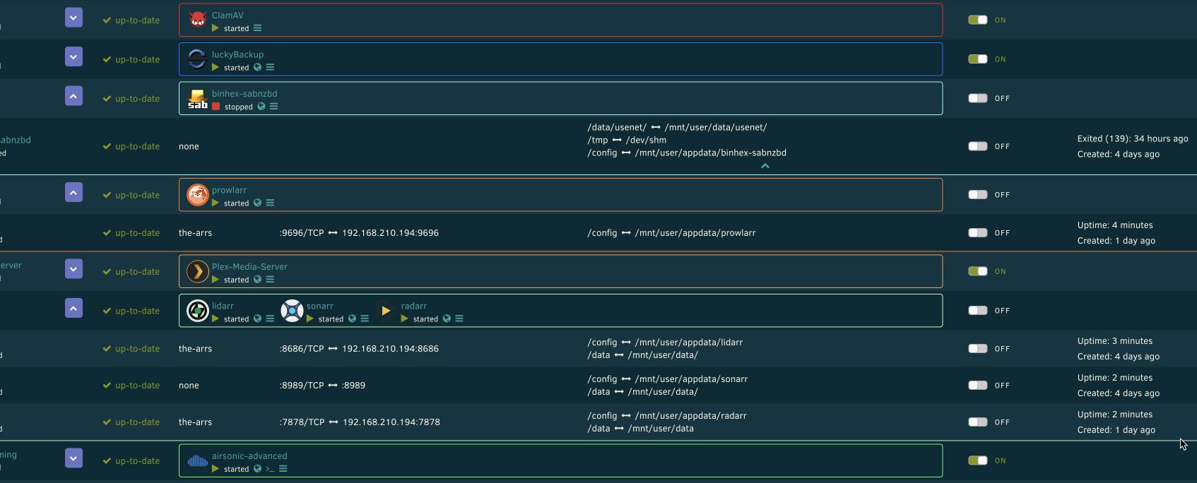

  5. Hi bmartino1, After very carefully following your guide to step 6 this is the situation I find my self in. With the containers running even though the network is now appearing the containers are not getting an IP. I've attached my cli output showing the steps I took. binhex-sabnzbd is still having a problem with the network despite the config having the correct network, strange. root@Locutus:~# docker network disconnect the-arrs prowlarr root@Locutus:~# docker network disconnect the-arrs radarr root@Locutus:~# docker network disconnect the-arrs lidarr root@Locutus:~# docker network inspect the-arrs [ { "Name": "the-arrs", "Id": "781daf242b174d8022d621313fdf7343d7b63a93e5b8de2aa790c2e1eccb28a8", "Created": "2024-11-16T13:23:48.915916839Z", "Scope": "local", "Driver": "bridge", "EnableIPv6": false, "IPAM": { "Driver": "default", "Options": {}, "Config": [ { "Subnet": "172.19.0.0/16", "Gateway": "172.19.0.1" } ] }, "Internal": false, "Attachable": false, "Ingress": false, "ConfigFrom": { "Network": "" }, "ConfigOnly": false, "Containers": {}, "Options": {}, "Labels": {} } ] root@Locutus:~# docker network rm the-arrs the-arrs root@Locutus:~# docker network ls NETWORK ID NAME DRIVER SCOPE 4eb6e48fe60b br0 ipvlan local 4974d5e68b6a bridge bridge local c23f590356ad host host local 9d85fee46172 none null local root@Locutus:~# docker network create \ > --driver bridge \ > --subnet=172.19.0.0/16 \ > the-arrs ff54bf2796fe949fcc49124e6259b89caa3a9ef31c3aa9f26af6a4e4d16f0b8f root@Locutus:~# docker network inspect the-arrs [ { "Name": "the-arrs", "Id": "ff54bf2796fe949fcc49124e6259b89caa3a9ef31c3aa9f26af6a4e4d16f0b8f", "Created": "2024-11-21T11:35:26.223788051Z", "Scope": "local", "Driver": "bridge", "EnableIPv6": false, "IPAM": { "Driver": "default", "Options": {}, "Config": [ { "Subnet": "172.19.0.0/16" } ] }, "Internal": false, "Attachable": false, "Ingress": false, "ConfigFrom": { "Network": "" }, "ConfigOnly": false, "Containers": {}, "Options": {}, "Labels": {} } ] root@Locutus:~# docker ps CONTAINER ID IMAGE COMMAND CREATED STATUS PORTS NAMES bb703c44083a amir20/dozzle "/dozzle" 31 hours ago Up 10 hours 0.0.0.0:8085->8080/tcp, :::8085->8080/tcp Dozzle 7c6c0b758afa lscr.io/linuxserver/homeassistant "/init" 31 hours ago Up 10 hours Home-Assistant 3fabd2296c29 jlesage/mediainfo "/init" 2 days ago Up 10 hours 0.0.0.0:7817->5800/tcp, :::7817->5800/tcp, 0.0.0.0:7917->5900/tcp, :::7917->5900/tcp MediaInfo 0e8f497546bc mikenye/picard "/init" 3 days ago Up 7 minutes 0.0.0.0:5800->5800/tcp, :::5800->5800/tcp, 5900/tcp MusicBrainz-Picard d1c398636e7b clamav/clamav "/init" 3 days ago Up 10 hours (healthy) 0.0.0.0:3310->3310/tcp, :::3310->3310/tcp, 7357/tcp ClamAV 2fb3c6591525 plexinc/pms-docker "/init" 4 days ago Up 3 days Plex-Media-Server 001aa28cca90 securecompliance/gvm:11.0.1-r3 "/bin/sh -c '/start.…" 4 days ago Up 10 hours 0.0.0.0:8088->9392/tcp, :::8088->9392/tcp frak-gvm 24458a4d2933 binhex/arch-krusader "/usr/bin/dumb-init …" 4 days ago Up 10 hours 5900/tcp, 0.0.0.0:6080->6080/tcp, :::6080->6080/tcp binhex-krusader d11a68f18fe2 ghcr.io/recyclarr/recyclarr:latest "/sbin/tini -- /entr…" 4 days ago Up 10 hours recyclarr 1fc6c5bc70e1 jlesage/qdirstat "/init" 4 days ago Up 10 hours 0.0.0.0:7815->5800/tcp, :::7815->5800/tcp, 0.0.0.0:7915->5900/tcp, :::7915->5900/tcp QDirStat 9ed27c22c1df ghcr.io/home-assistant-libs/python-matter-server:stable "matter-server --sto…" 4 days ago Up 10 hours matter-server 3023f45d5b67 ich777/luckybackup "/opt/scripts/start.…" 4 days ago Up 10 hours 0.0.0.0:8086->8080/tcp, :::8086->8080/tcp luckyBackup 5109a81c570d jbartlett777/diskspeed "catalina.sh run" 4 days ago Up 10 hours 8080/tcp, 0.0.0.0:18888->8888/tcp, :::18888->8888/tcp DiskSpeed 763aeb21b35c jlesage/czkawka "/init" 4 days ago Up 10 hours 0.0.0.0:7821->5800/tcp, :::7821->5800/tcp, 0.0.0.0:7921->5900/tcp, :::7921->5900/tcp Czkawka 93aae5cb1024 lscr.io/linuxserver/airsonic-advanced "/init" 4 days ago Up 10 hours 0.0.0.0:4040->4040/tcp, :::4040->4040/tcp airsonic-advanced root@Locutus:~# docker ps CONTAINER ID IMAGE COMMAND CREATED STATUS PORTS NAMES bb703c44083a amir20/dozzle "/dozzle" 31 hours ago Up 10 hours 0.0.0.0:8085->8080/tcp, :::8085->8080/tcp Dozzle 9209317f760a ghcr.io/hotio/radarr:latest "/init" 31 hours ago Up 3 minutes radarr 337973fe3bac ghcr.io/hotio/prowlarr "/init" 31 hours ago Up 5 minutes prowlarr 7c6c0b758afa lscr.io/linuxserver/homeassistant "/init" 31 hours ago Up 10 hours Home-Assistant 3fabd2296c29 jlesage/mediainfo "/init" 2 days ago Up 10 hours 0.0.0.0:7817->5800/tcp, :::7817->5800/tcp, 0.0.0.0:7917->5900/tcp, :::7917->5900/tcp MediaInfo 0e8f497546bc mikenye/picard "/init" 3 days ago Up 14 minutes 0.0.0.0:5800->5800/tcp, :::5800->5800/tcp, 5900/tcp MusicBrainz-Picard d1c398636e7b clamav/clamav "/init" 3 days ago Up 10 hours (healthy) 0.0.0.0:3310->3310/tcp, :::3310->3310/tcp, 7357/tcp ClamAV 2fb3c6591525 plexinc/pms-docker "/init" 4 days ago Up 3 days Plex-Media-Server c7172ee53700 ghcr.io/hotio/lidarr:latest "/init" 4 days ago Up 4 minutes lidarr 001aa28cca90 securecompliance/gvm:11.0.1-r3 "/bin/sh -c '/start.…" 4 days ago Up 10 hours 0.0.0.0:8088->9392/tcp, :::8088->9392/tcp frak-gvm 24458a4d2933 binhex/arch-krusader "/usr/bin/dumb-init …" 4 days ago Up 10 hours 5900/tcp, 0.0.0.0:6080->6080/tcp, :::6080->6080/tcp binhex-krusader f3790ad35636 ghcr.io/hotio/sonarr:latest "/init" 4 days ago Up 3 minutes sonarr d11a68f18fe2 ghcr.io/recyclarr/recyclarr:latest "/sbin/tini -- /entr…" 4 days ago Up 10 hours recyclarr 1fc6c5bc70e1 jlesage/qdirstat "/init" 4 days ago Up 10 hours 0.0.0.0:7815->5800/tcp, :::7815->5800/tcp, 0.0.0.0:7915->5900/tcp, :::7915->5900/tcp QDirStat 9ed27c22c1df ghcr.io/home-assistant-libs/python-matter-server:stable "matter-server --sto…" 4 days ago Up 10 hours matter-server 3023f45d5b67 ich777/luckybackup "/opt/scripts/start.…" 4 days ago Up 10 hours 0.0.0.0:8086->8080/tcp, :::8086->8080/tcp luckyBackup 5109a81c570d jbartlett777/diskspeed "catalina.sh run" 4 days ago Up 10 hours 8080/tcp, 0.0.0.0:18888->8888/tcp, :::18888->8888/tcp DiskSpeed 763aeb21b35c jlesage/czkawka "/init" 4 days ago Up 10 hours 0.0.0.0:7821->5800/tcp, :::7821->5800/tcp, 0.0.0.0:7921->5900/tcp, :::7921->5900/tcp Czkawka 93aae5cb1024 lscr.io/linuxserver/airsonic-advanced "/init" 4 days ago Up 10 hours 0.0.0.0:4040->4040/tcp, :::4040->4040/tcp airsonic-advanced root@Locutus:~#
  6. Hi bartino, the result of running docker network ls root@Locutus:~# docker network ls NETWORK ID NAME DRIVER SCOPE 4eb6e48fe60b br0 ipvlan local 4974d5e68b6a bridge bridge local c23f590356ad host host local 9d85fee46172 none null local 781daf242b17 the-arrs bridge local root@Locutus:~# and now docker inspect network the-arrs root@Locutus:~# docker inspect network the-arrs [ { "Name": "the-arrs", "Id": "781daf242b174d8022d621313fdf7343d7b63a93e5b8de2aa790c2e1eccb28a8", "Created": "2024-11-16T13:23:48.915916839Z", "Scope": "local", "Driver": "bridge", "EnableIPv6": false, "IPAM": { "Driver": "default", "Options": {}, "Config": [ { "Subnet": "172.19.0.0/16", "Gateway": "172.19.0.1" } ] }, "Internal": false, "Attachable": false, "Ingress": false, "ConfigFrom": { "Network": "" }, "ConfigOnly": false, "Containers": { "337973fe3bac029155e79631848b04dee6ae3d441a5fabbea187f24ce11c0aec": { "Name": "prowlarr", "EndpointID": "1ba201437c5be293706424bb4fb67e60dcd7bc17a84987ea35c4a0baae61aa63", "MacAddress": "02:42:ac:13:00:03", "IPv4Address": "172.19.0.3/16", "IPv6Address": "" }, "9209317f760a9aa9fd69e8b1aab73472bd71ac8ce499c896f89843e555bbfe29": { "Name": "radarr", "EndpointID": "1686a7f67091ace56dfbf03a3968eda60ad9766b4d508ed2bb1cd37e2d1b8248", "MacAddress": "02:42:ac:13:00:04", "IPv4Address": "172.19.0.4/16", "IPv6Address": "" }, "c7172ee53700618f540ed19859ff07635ffa1c3e42ed198467647052035c8bbb": { "Name": "lidarr", "EndpointID": "ff85813ae4d9bc1e8d0d760ccc9caa1c3bde582d79a6502bd96e0ae94f593aa2", "MacAddress": "02:42:ac:13:00:02", "IPv4Address": "172.19.0.2/16", "IPv6Address": "" } }, "Options": {}, "Labels": {} } ] Error: No such object: network Thanks for your help with this.
  7. Hi all, JorgeB help me get my docker image rebuilt but now I have a different issue. Before installing al my applications I made a custom docker network called the-arrs that I use to run my media applications so they run in there own network. Now that the containers are running all but one or two have an IP address and I can't connect to them. Anyone have any ideas whats going on and how I can fix this.

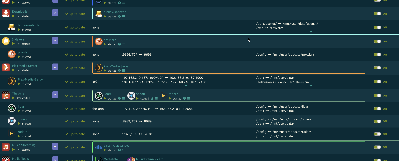

  9. Hi GorgB, Docker Image recreated and a application installed as per the links in your last post. All dockers container are running but strangely there is no network for Prowarr, Sonarr, Radarr, binhex-sabnzbd but Lidarr does. This has completely confused me to what has happen as it was all aging very well. I do run a custom docker network for above media application which I created before in stalling any application. I've attached a net diag but I guess as the server has been running a while won't show the detail requyired.locutus-diagnostics-20241117-0923.ziplocutus-diagnostics-20241117-0923.zip
