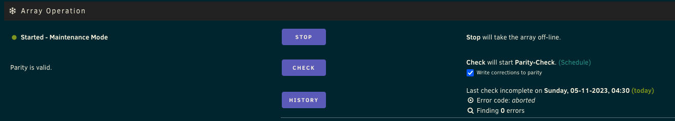

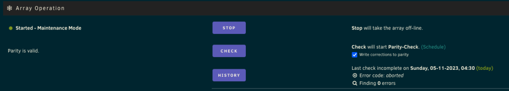

Hi Guys, System crashed again so as requested I have attached the syslog file from the flash drive. I've restarted unRAID and put it into maintenance mode but it seem happy that the Parity is okay so I will put it back into normal mode and see what happens. Lets hope you find a clue in the logs, Also just noticed that it was running a scheduled task - see attached picture. syslog

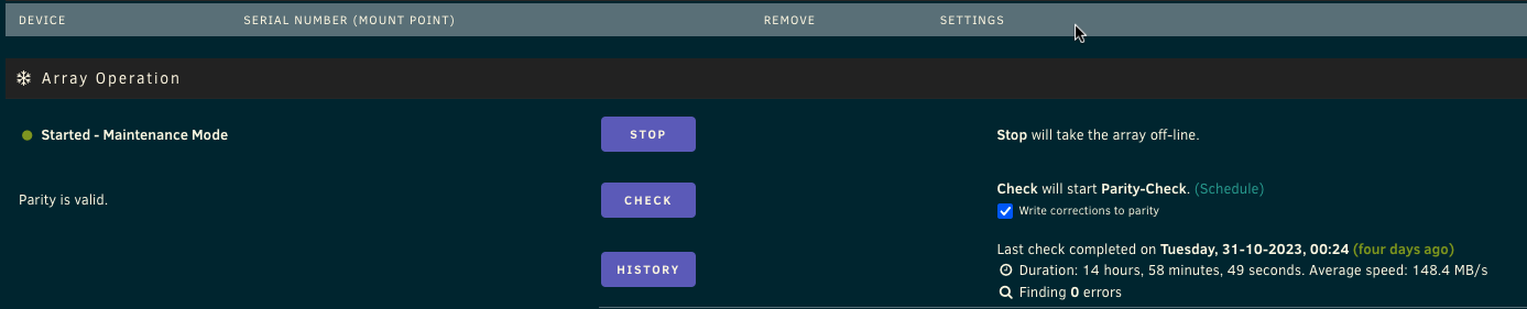

@JorgeB RE: UNRAID 6.12.4 CRASHING WITH KERNAL PANIC- NEED ASSISTANCE, My previous post. As of last Tuesday all was working fine but on Wednesday around the Kernal panic issue retuned and the system halted. At that point I had to switch the server off and it's been off for the last couple of day, I have just powered it back on into maintenance mode as I though it would need to do a Corrective Parity Check but it has not as the Parity is showing as VALID which is strange as I has a "unclean shutdown detected" I would like to find out what is the root cause of the crashes I am thinking it might be an add-on or a docker issue. locutus-diagnostics-20231104-0715.zip
