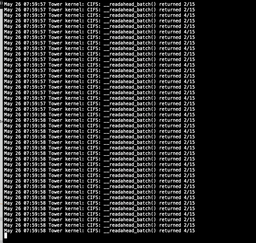

May 28 16:27:44 Tower kernel: CIFS: __readahead_batch() returned 4/15
Large MTU might be your issue
What version of SMB is being used on the Synology? If you unmount the SMB share and remount it, the Log will show you the negotiation that goes on in the process. My DroboFS is old enough that it is still using SMBv1. When a shere there mounts, the log shows it started with SMB latest and then negotiates down until it gets to SMB v1. Hope this helps shed some light. Dennis
Where are these messages in the log coming from. Yes, this is probably from SMBv1. They completely fill the log after a while. Any way to shut these off? Looks like they are informational. Thanks Dennis
