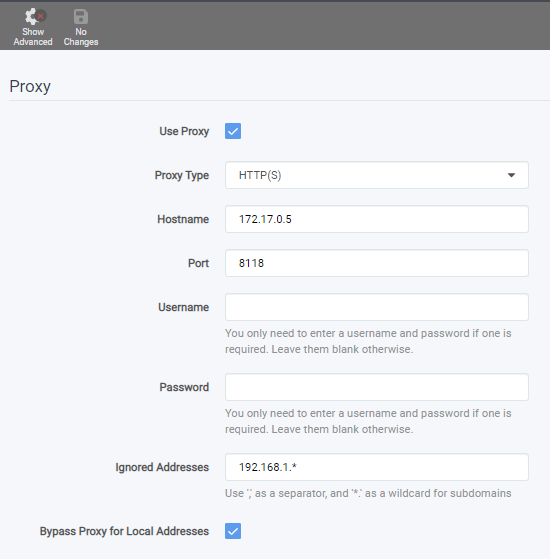

  8. Fresh download of radarr, my settings are below my qbit hostname ends in a 5 instead of a 1 like yours, guessing because I've done so many container attempts. when i use the curl ifconfig.io command from the radarr console, it's still showing my actual ip, not the one that the qbitvpn console shows. is that still the right way to test this?
  9. I guess I'm dumber and noober than I thought. How do I get to the WebUI at all for an arrr in order to make these changes? Am I following the spaceinvader video to a certain point, .ie, still listing None for network and adding the extra parameter? Or am I installing it as is with a Bridge network setting to get to the UI temporarily?
  10. First off, thanks for responding. I have no preference for how this is set up, I'm just trying to get it all through one device, which is what I thought that video was for, so I'll start from scratch again. Is there a step-by-step guide somewhere that explains how to set it up using privoxy? I'm sure Ive made a mess with all the custom settings and port changes required in the video, so I should start form a clean slate.
  11. Yes, I've done everythign in q24 and q25, but I am not clear on the notes below those. Where do I make these changes? Is it on the qbit docker hosting the vpn, or the arr docker being hosted, or somewhere else entirely? "Please keep in mind that when defining connections from an application to another application in the same VPN container network that you will need to set the host to 'localhost' and NOT the LAN IP address, this is because the applications are now bound to the same network and thus should communicate over 'localhost' and NOT the unRAID host IP address."
  12. I am officially flailing and getting quite desperate here having made no progress in 3 weeks. Qbittorrentvpn is confirmed working through the NordVPN via a TorGuard check my torrent ip test. I have watched the SpaceInvaderOne video at least a dozen times, and have been able to confirm that the Arrs are also using NordVPN via the Qbit container. But I am absolutely 1000% stumped as to why I cannot get the the WebUI of an Arrr. It seems that something changed earlier this year when iptables were introduced, and the correct method is now explained in bits and pieces across youtube videos, reddit, and these forums. Can anyone spare a few minutes to look at my setup and give me any insight at all? Would rather not abandon this, but without some guidance I'll have to. Redacted logs are below. Thank you in advance for anything at all. QBIT supervisord.log Sonarr supervisord - Copy.log
