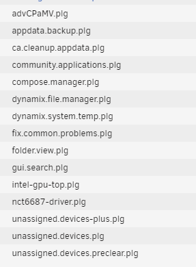

  2. The plugins I have installed are the following: (screeshot grabbed from the /boot/config/plugins folder) Do you see any plugin that usually causes trouble? I will be reenabling them one by one as per your advice. I noticed there was a /boot/config/plugins-error folder with a file called docker.patch.plg file inside, containing the following: GNU nano 7.2 docker.patch.plg <?xml version="1.0" standalone="yes"?> <!DOCTYPE PLUGIN [ <!ENTITY name "docker.patch"> <!ENTITY author "Andrew Zawadzki"> <!ENTITY version "2023.01.28"> <!ENTITY github "Squidly271/docker.patch"> <!ENTITY pluginURL "https://raw.githubusercontent.com/Squidly271/docker.patch/main/plugins/docker.patch.plg"> ]> <PLUGIN name="&name;" author="&author;" version="&version;" pluginURL="&pluginURL;" icon="bug" min="6.11.0" max="6.11.5" support="https://forums.unraid.net/topic/134016-fix-to-a-small-issue-with-updating-oci-docker-images/"> <CHANGES> ###2023.01.28 - Initial Release </CHANGES> <FILE Run="/bin/bash"> <INLINE> echo "Patching Docker Client" sed -i 's/application\/vnd.docker.distribution.manifest.list.v2+json,application\/vnd.docker.distribution.manifest.v2+json/application\/vnd.docker.distribution.manifest.list.v2+json,application\/vnd.docker.distribution.manifest.v2+json> echo "----------------------------------------------------" echo " &name; has been installed." echo " Copyright 2023, Andrew Zawadzki" echo " Version: &version;" echo "----------------------------------------------------" echo "" </INLINE> </FILE> <!-- The 'remove' script. --> <FILE Run="/bin/bash" Method="remove"> <INLINE> echo "" echo "You must reboot for the changes to take effect" echo "" </INLINE> </FILE> </PLUGIN> Everything seems to be OK, right?

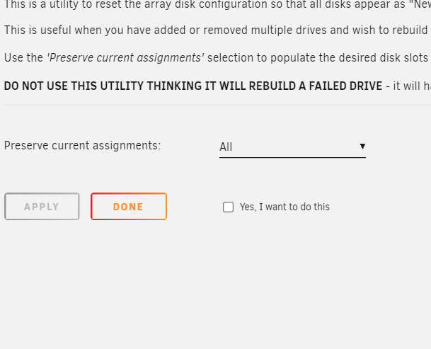

  9. I should proceed like this? There's a dialogue screen after this where I can re-assign the disks WITHOUT data loss?
  10. Okay, here's the diagnostics! By new config... could you be more specific, JorgeB? I'm under the impression that with a new config I would lose data... About the HDD in question: it's a data HDD, part of the array. This array is pretty small and has no parity drive (it has a cache SSD though) How do you think I should proceed? As per Unraid's documentation and some community posts, I get the impression I can rebuild the array using the "new config" tool, which is non-destructible... but could you confirm me this information and help me configuring the tool? This HDD has lots of family stuff I'd rather not lose😅 Thank you in advance! tower-diagnostics-20230607-1623.zip
