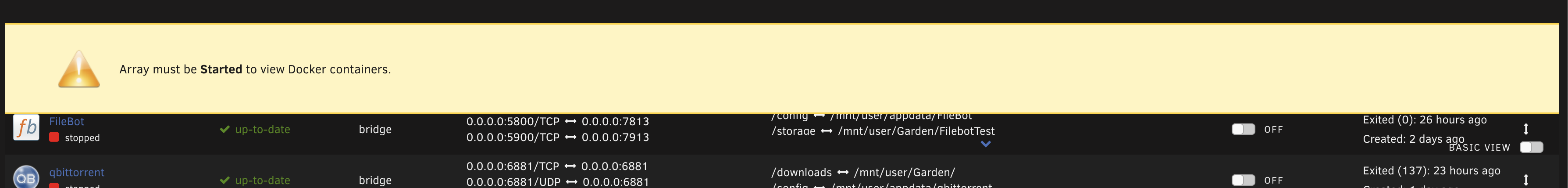

  4. It's a little weird right now. It seems to be partially started and partially not. Parity sync is running, and I'm able to access my data on the server via SMB. However, if I go to the shares tab, it says that the array has to be started to view shares. If I go to the Docker tab, it says that the array has to be started to see containers, yet the containers are visible under the message. Also, the only buttons available on the bottom of the main tab are reboot and shutdown. There are no visible buttons, not even grayed out ones, relating to starting or stopped the array or parity sync. It's acting strange right now, probably because I hit "new config", but I'm hoping it starts working normally after the parity sync finishes and I restart. That will take a couple of days though because I'm also transferring files to the share which has brought parity sync to a crawl. I did do them in separate steps, or at least I thought so. I removed the parity drive and replaced it with the new one. I started the array up and it worked fine. I didn't let parity sync finish because it seemed like it would be pointless to build the parity right before adding a new driving and having to build it again. I stopped the array and still couldn't add the drive. I've tried restarting and now I've tried "new config". Do I have to let the parity sync finish before I can add another drive? vortex6-diagnostics-20230115-1336.zip
