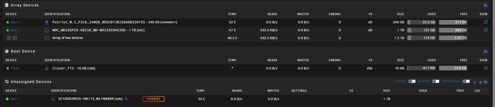

  3. In general. I replaced the hard drive with another one, also SMP, and the problem went away. I connected the problem disk directly to the board, added it to the array, and when downloading torrents, every couple of GB, the speed drops to 0, but for a couple of seconds, while it does not slow down the system like when working from a plug-in! I understand that something is wrong with the disk! But in the array it works fine, but not through the plugin!
  4. thanks) I know the problems of smr disks, but I use it via a usb disk, I have a maximum speed of 70mb) all the more so the same disk in the array (also via usb) works stably, without any problems)
  5. Nope. Nope I understand what you mean, but that's not the point here. For example, I set download movies to 50 GB. It downloads 5-10 GB normally (speed 60 mb per second) Then terrible brakes of all system begin. The speed drops to 0, and does not rise again. even if I close the torrent, and after half an hour if I start the same torrent or another, it can download at a speed of 1-2 kilobytes. There seems to be a problem with the plugin.
  6. I understand your idea, but I add the same disk to the array, and everything is ok, everything is without problems. also, the write speed is a maximum of 70-80 megabytes per second, I think any hard drive can support this speed I just can't understand why the same disk in the array works fine, but through the plugin it starts to terribly slow down the system. Moreover, the speed is not higher than 70 mb per second
  7. hm, maybe. I can not find info. HDD ST1000LM035 Even if there is SMR, why does everything work ok in the array, but such problems in the plugin?

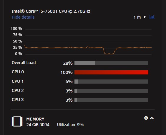

  8. I use NTFS external usb 3.0 hdd 1TB to media library. (I sometimes need to disconnect it, and use it with a media box) For this I use the plugin Unassigned Devices. But there is a problem: When Deluge downloads files to this external drive, at first it downloads at normal speed, but after a 5-10gb the speed drops to 0-0.5 megabytes, and I can't do anything else with the disk, even unmount it. Even if I turn off Deluge completely, stop all containers, etc., unRAID seems to slow down a lot, SMB share slow down a lot (share of all hdd un array). And the system shows that 1 or 2 cores are constantly loaded at 100%. But through the htop console, there is no load at all. If I add this disk to the array, there are no such problems. The disk is fully functional. Problem only in plugin Unassigned Devices I thought the problem was in NTFS, but I format it in XFS, and the situation is almost the same. But if you add a disk to the array, there is no problem. Can someone help? I need the torrent client to download to an external USB drive, since from time to time I need to connect it to another device.
