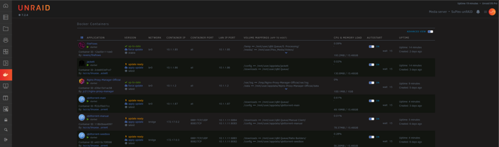

  1. Mines on the left, not the top right. I just found it..

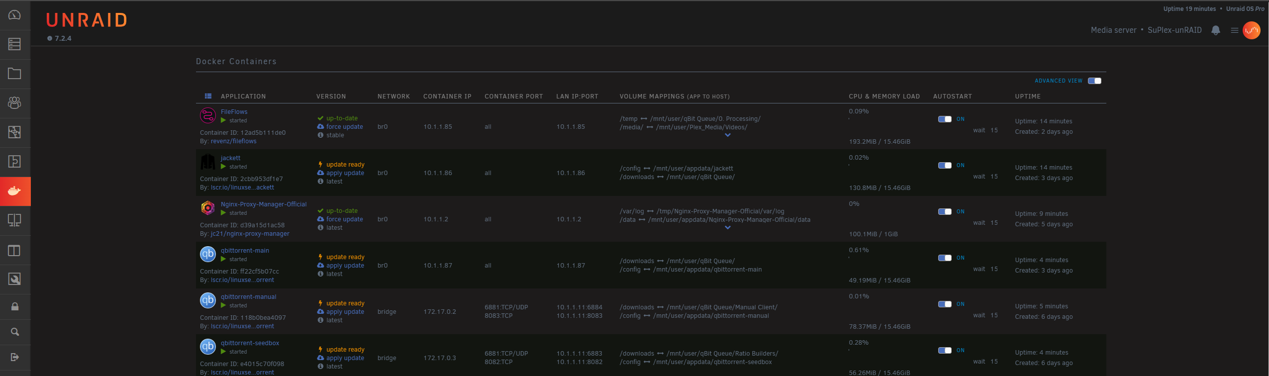

  2. Such a dumb question but everything I see says to look for a lock icon. Literally no where on my system to be found.. How the hell do you reorder docker startup on v7.2.4? Not at the bottom, not at the top. There's no relevant button at the bottom. Zero info in the documentation.. All I want to do is have my nginx start first..
