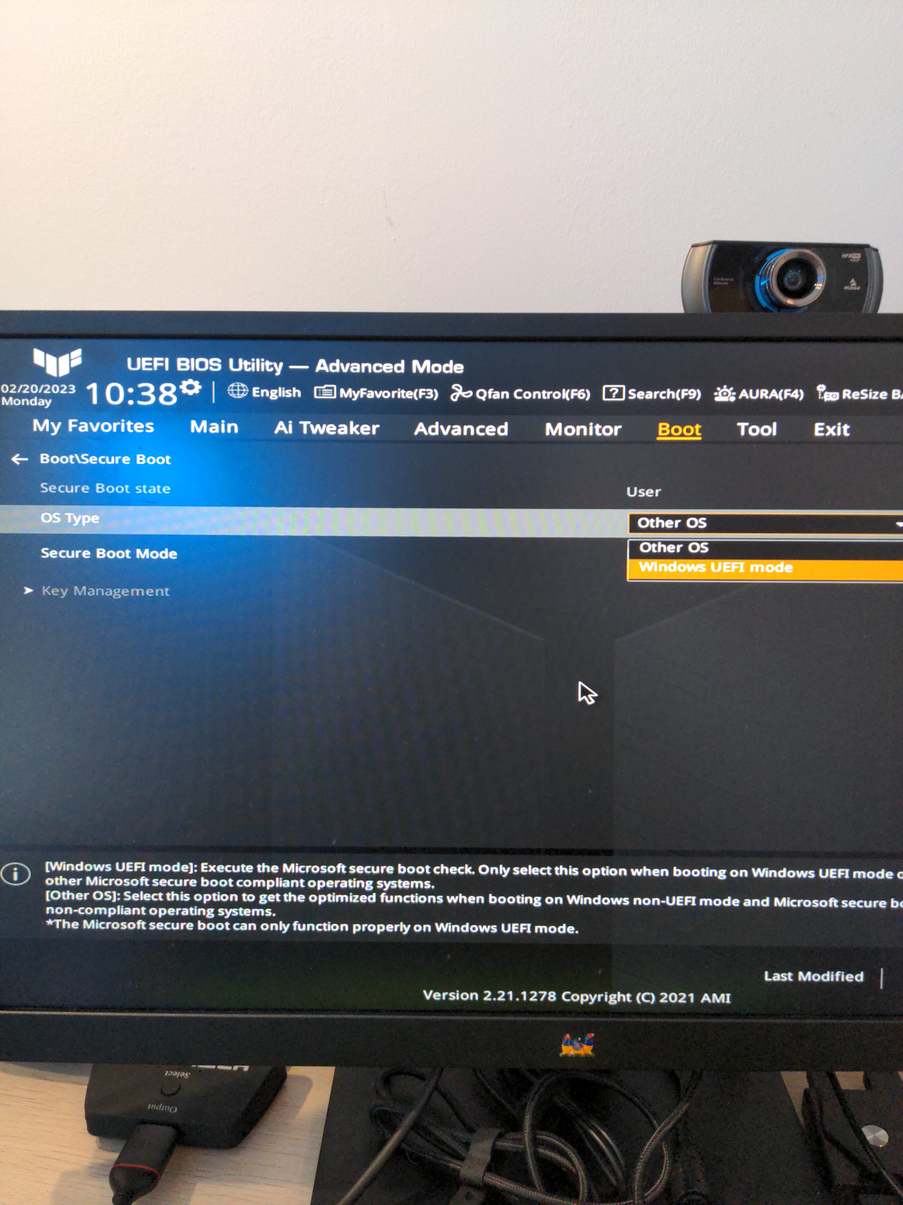

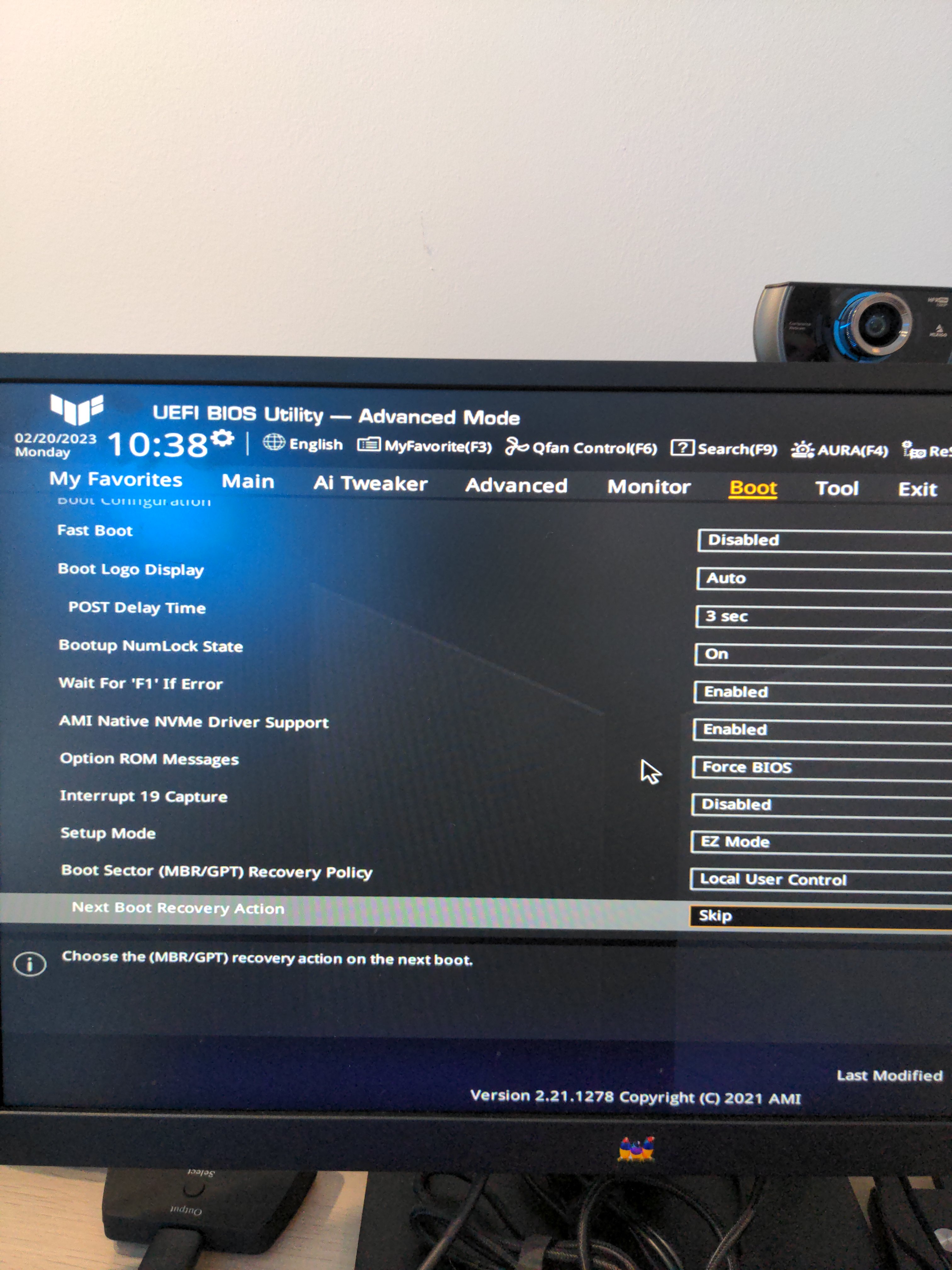

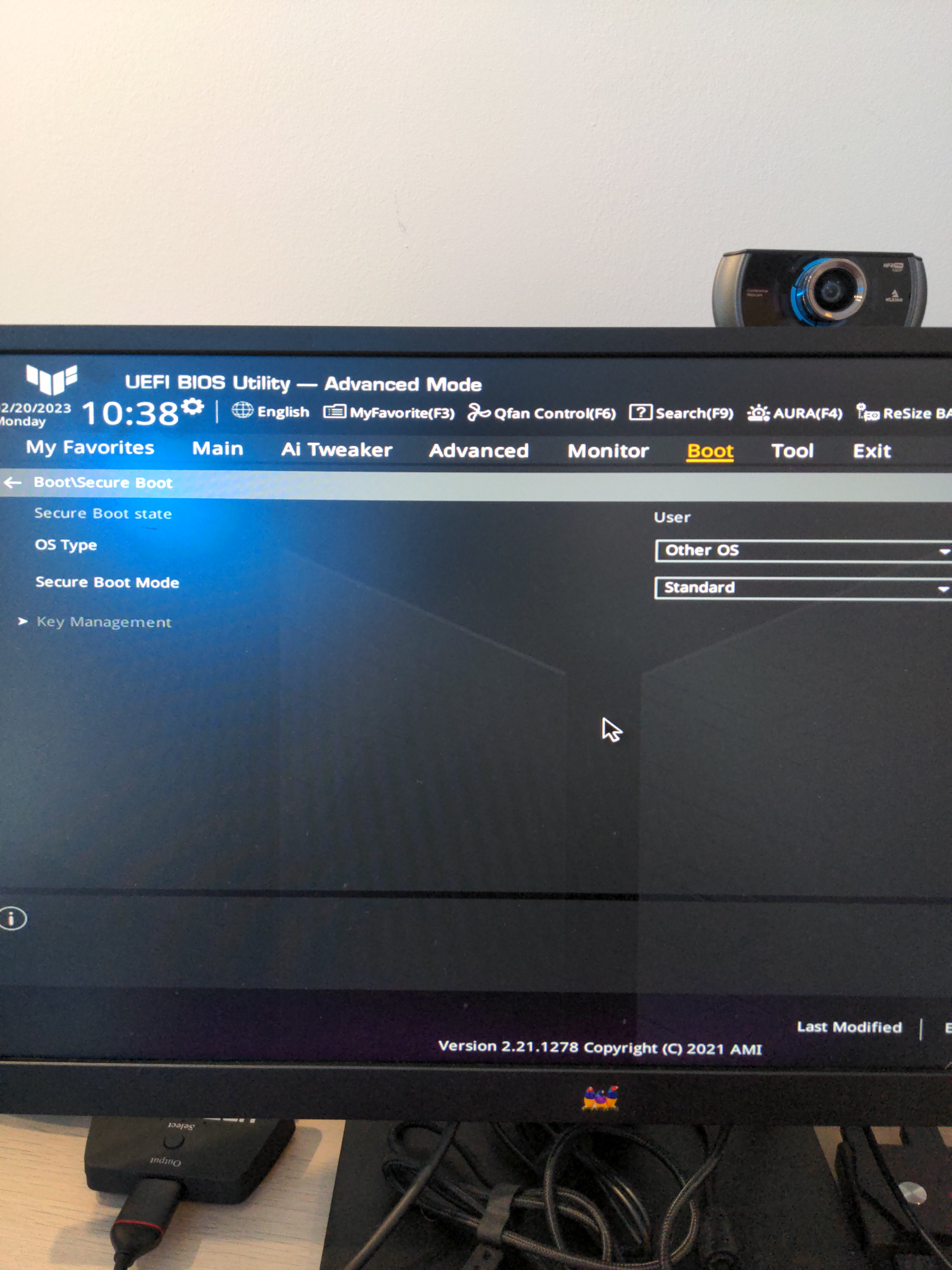

  2. These are my setting options in my BIOS. I have tried the OS type as Other OS and Windows UEFI. Every time I save and exit, I just get brought right back to the BIOS. Do you see any settings that I might have wrong?

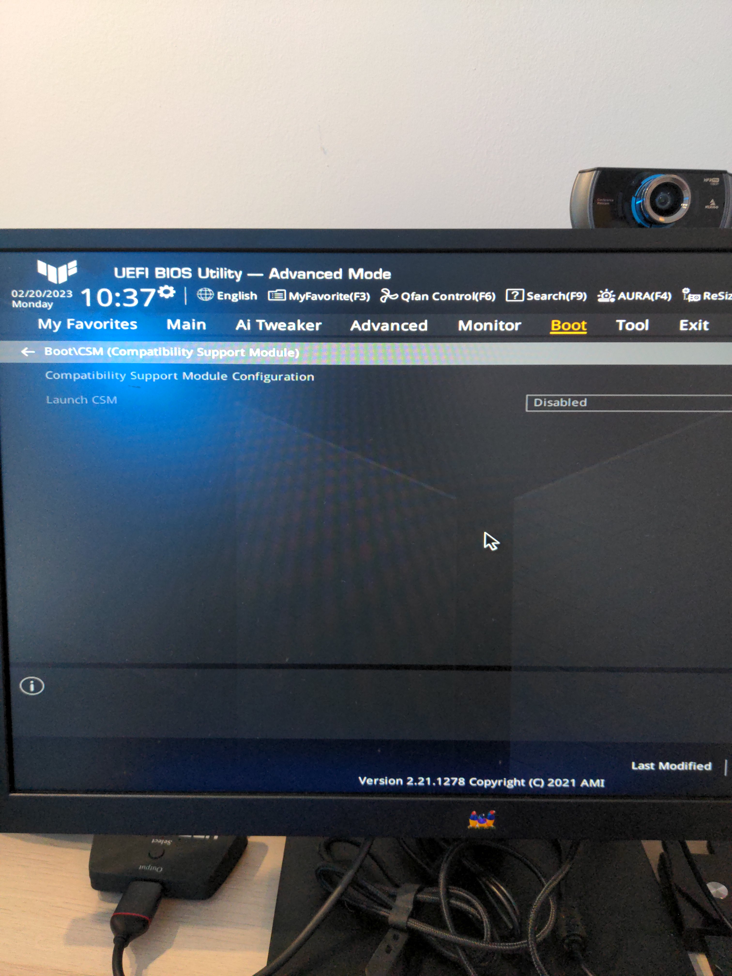

  4. My machine won't boot the USB with memtest86 on it. From what I understand I need to change my Compatibility Support Module from Legacy to UEFI. But, this option is always greyed out in my BIOS. I've seen some others mention that having a cpu with igpu causes this. But I don't have anything to swap out with. Any suggestions?

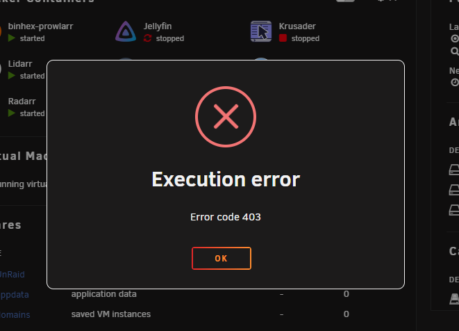

  6. My server ran fine all last week, but then on Friday and again on Sunday it will just randomly shut down every docker container. When I try to restart them I get an Execution Error, error 403. I've attached my diagnostics zip from Sunday afternoon. I have also tried to run memtestx86 from the boot up options, but all it does is restart my system. My motherboard screen comes back up and then I get the choices of booting UnRaid. Do I just have bad RAM? It was bought brand new, but this is what I am currently thinking Specs Asus Z590-P plus Wifi Intel I3-10320 G Skill D4 3600 2x8Gb 3x10TB Seagate Exos 1 128GB IPSG Sata SSD Be Quiet Pure Power 11 500W tower-diagnostics-20230219-1753.zip
