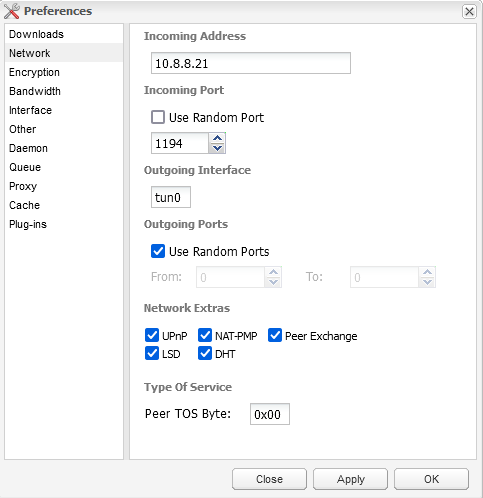

  1. Have now - same result. Just sits at between 0.6 & 1.3MB/s This is what I've done: Incoming port not defined correctly - it is (as above) Upload rate set too high/unlimited - My upload speed is 48Mb/s so I've set this in Deluge to 20000Kb/s Use GCM cipher instead of CBC - added "cipher aes-128-gcm auth sh**A256 ncp-disable" Disable in/out utp - Disabled both via itconfig plugin Rate limit overhead enabled - Was unticked anyhow VPN endpoint has low bandwidth - Getting 548Mb/s via browser with vpn connected Highly fragmented disk - Doubt my disk would have that much effect on the download speed - especially as with the VPN off I get 40-50Mb/s Name Resolution not working - Am using NAME_SERVERS=84.200.69.80,37.235.1.174,1.1.1.1,37.235.1.177,84.200.70.40,1.0.0.1 - are these ok? unRAID - I'm not using unRAID Router/Realtek NIC - again, works without the VPN Again, thanks for your time on this. M PS And again it breifly went up to 10MB/s, i thought "it's working" and then it wne tright down to 200kb/s before settling at 1MB/s. core.conf uk_manchester.ovpn supervisord.log
  2. Ok, really sorry about this but I'm crying into my computer. I've bought PIA and installed Deluge fresh with the following: docker run -d \ --cap-add=NET_ADMIN \ -p 8112:8112 \ -p 8118:8118 \ -p 58846:58846 \ -p 58946:58946 \ --name=arch-delugevpn \ -v /share/CACHEDEV1_DATA/Data/Multimedia/:/data \ -v /share/CACHEDEV1_DATA/Data/Deluge_Config/:/config \ -v /etc/localtime:/etc/localtime:ro \ -e VPN_ENABLED=yes \ -e VPN_USER=HIDDEN \ -e VPN_PASS=HIDDEN \ -e VPN_PROV=pia \ -e VPN_CLIENT=openvpn \ -e STRICT_PORT_FORWARD=yes \ -e ENABLE_PRIVOXY=no \ -e LAN_NETWORK=192.168.1.0/24 \ -e NAME_SERVERS=84.200.69.80,37.235.1.174,1.1.1.1,37.235.1.177,84.200.70.40,1.0.0.1 \ -e DELUGE_DAEMON_LOG_LEVEL=info \ -e DELUGE_WEB_LOG_LEVEL=info \ -e DELUGE_ENABLE_WEBUI_PASSWORD=no \ -e VPN_INPUT_PORTS=1234 \ -e VPN_OUTPUT_PORTS=5678 \ -e DEBUG=false \ -e UMASK=000 \ -e PUID=0 \ -e PGID=0 \ binhex/arch-delugevpn It connects and everything but I'm still only getting c0.6-1.1MB/s. I checked the log file and Manchester in the UK accepts port forwarding. Have attached the Deluge config file. Am I supposed to still do something in preferences and the incoming ports (I thought it was automatically done with PIA - and seems to be from the .conf file)? BTW oddly, at one point the download speed did shoot up to 18MB/s but then quickly went down to 1.1MB/s. Thanks (again) in advance and apologies for taking up your time. M supervisord.log core.conf

  5. Hi there, So I've been on with Surfshark (my VPN provider) and the chap told me my incoming port was 1196. I've completely re-installed the container (as my settings have been changed so much I wanted a fresh install). Anyhow, it didn't work - nothing better than 1.2MB/s. BTW I did a test without the VPN and got an amazing 50.2MB/s I'm not convinced the incoming port bit I was told was right (he said it was because I was using UDP). Any other suggestions - or advice on how to get wireguard working?
