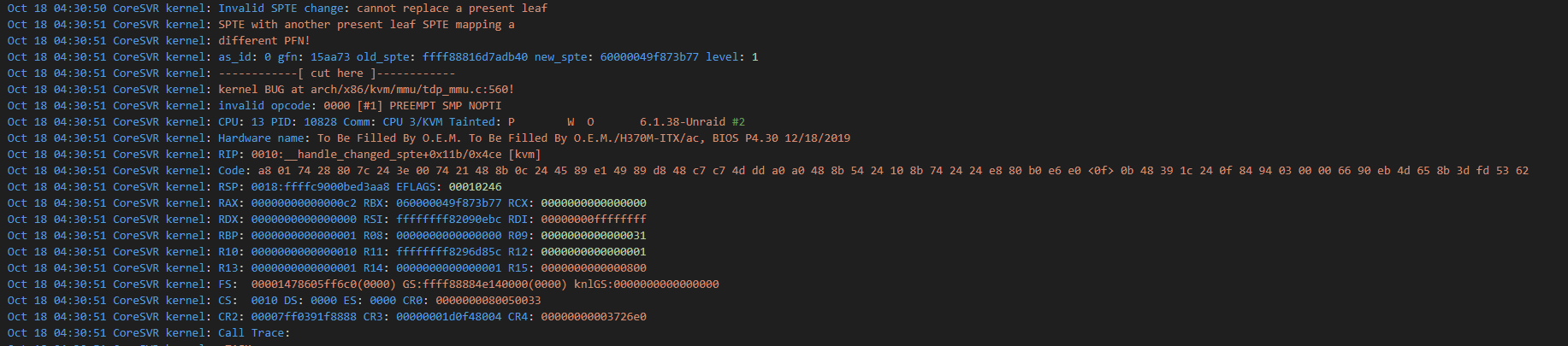

  7. ok....thank you, that's a good hint, but running the server without VM is unfortunately not an option. Can I see which VM instance crashed?
