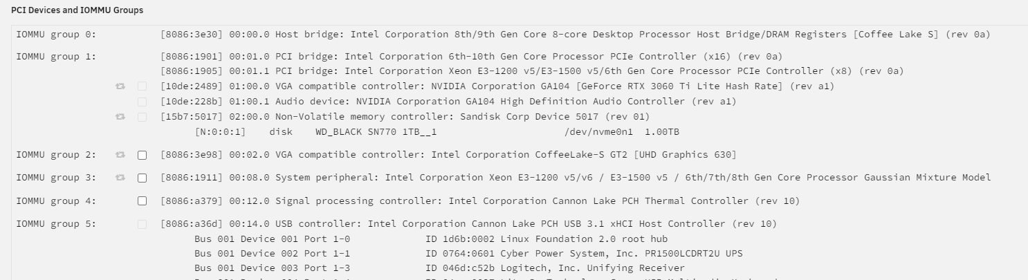

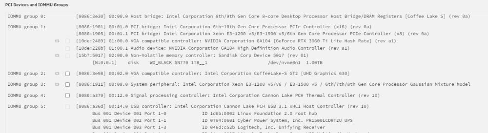

  12. Hi All, I don't even know how to properly categorize this issue, so I'll try the General Anyway, my current is setup is 2x1TB M.2 for Cache (1TB usable) and then I have 2x20TB for Parity and 6 drives for array (3 are 16TB and 3 are 8 TB) making it 72TB usable. SABNZBd is setup to download first to Cache, and then mover will move the data to array. This works excellent. When downloading I hit my max speed of just under 100MB/s. All is well. The issue ONLY arises when and if I am downloading something that's over 1TB. I'll get Cache low space alerts and all that. so if I want to download something that's 1TB I need to go into the data and set it up to use array instead of cache. Well then the download speed fluctuates from a few KB/s to 50-60-MB/s and it constantly goes up and down. For example: I am thinking it's something to do with the I/O since I am downloading directly to Array. Not sure why that would matter since I have 6 disks in array and even before Unraid I'd download stuff directly to HDDs without any issues whatsoever. I am positive the I/O can handle the speed of my max download, like I mentioned 100MB/s. Again, if I am downloading much smaller files to Cache, it flies. The post-processing also happens super fast and all is well. But with 1TB files I cannot download them into the cache (I tried and halfway thru I'd pause the SAB, then kick off the Mover, wait but since half data is downloaded it already started the extraction and because it's not done the mover doesn't move those to the array, until it's fully processed. What I am confused about is why downloading directly to the array causes soooo much D/L variance.... Thanks in advance for all your help.
  13. Yep, changed to Both and now it's working...YAY!!! Thank you kindly
  14. Hmm no go, same error: vfio 0000:01:00.0: group 1 is not viable Please ensure all devices within the iommu_group are bound to their vfio bus driver.
  15. Downstream, Multi or Both? Which one would you recommend? Thanks
  16. Ah ok, let me try that. thank you
  17. No, I can't even get to that part. at the add VM I get the error so it won't even proceed when I click CREATE
