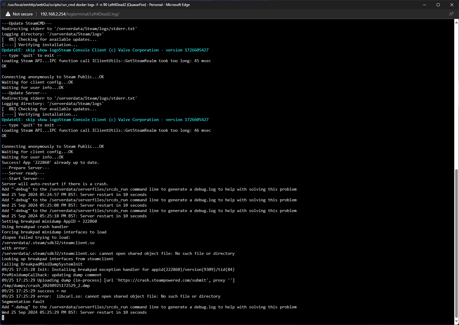

  2. @ich777 thanks for the update - sadly the L4D2 server still does not start, but the error is now slightly different: Success! App '222860' already up to date. ---Prepare Server--- ---Server ready--- ---Start Server--- Server will auto-restart if there is a crash. Setting breakpad minidump AppID = 222860 Using breakpad crash handler Forcing breakpad minidump interfaces to load Looking up breakpad interfaces from steamclient Calling BreakpadMiniDumpSystemInit 09/25 22:19:56 Init: Installing breakpad exception handler for appid(222860)/version(9309)/tid(68) PreMinidumpCallback: updating dump comment 09/25 22:19:56 Uploading dump (in-process) [url 'https://crash.steampowered.com/submit', proxy ''] /tmp/dumps/crash_20240925221956_2.dmp 09/25 22:19:56 success = no 09/25 22:19:56 error: libcurl.so: cannot open shared object file: No such file or directory Segmentation fault Add "-debug" to the /serverdata/serverfiles/srcds_run command line to generate a debug.log to help with solving this problem Wed 25 Sep 2024 10:19:56 PM BST: Server restart in 10 seconds Setting breakpad minidump AppID = 222860 How do I add this -debug flag to the srcds_run command? I can see said file, but I am not familiar with the structure.
  3. So firstly thank you to @ich777 for all the work getting SteamCMD and a load of Steam servers working, it's very much appreciated. That said, I am hoping that somebody can help me out with an issue I have getting a L4D2 server instance running. I should point out that I have instances of Valheim, Icarus, and Killing Floor 2 working just fine - so I know this is not a global SteamCMD issue. I've got the container installed, didn't change (didn't need to) any of the settings - but have also tried with a BR0 network as well as the default Bridge (don't think this is related to networking) and set a custom folder for the main server files (made no difference). But when starting, after updating SteamCMD and then downloading the L4D2 files it tries to start the server - but then hits a fatal error and gets stuck in a loop. The reported error is: I've opened a terminal for the container, and there is no /serverdata/.steam/ directory - not really a Linux guys but I believe that ls -lsa should show all files (even hidden ones starting with a .). I've also included a screenshot of the log showing a bit more than what is entered above. I've uninstalled and reinstalled (even made sure to nuke all files before a reinstall) but nothing has worked. Any assistance that can be rendered will be most welcome!
