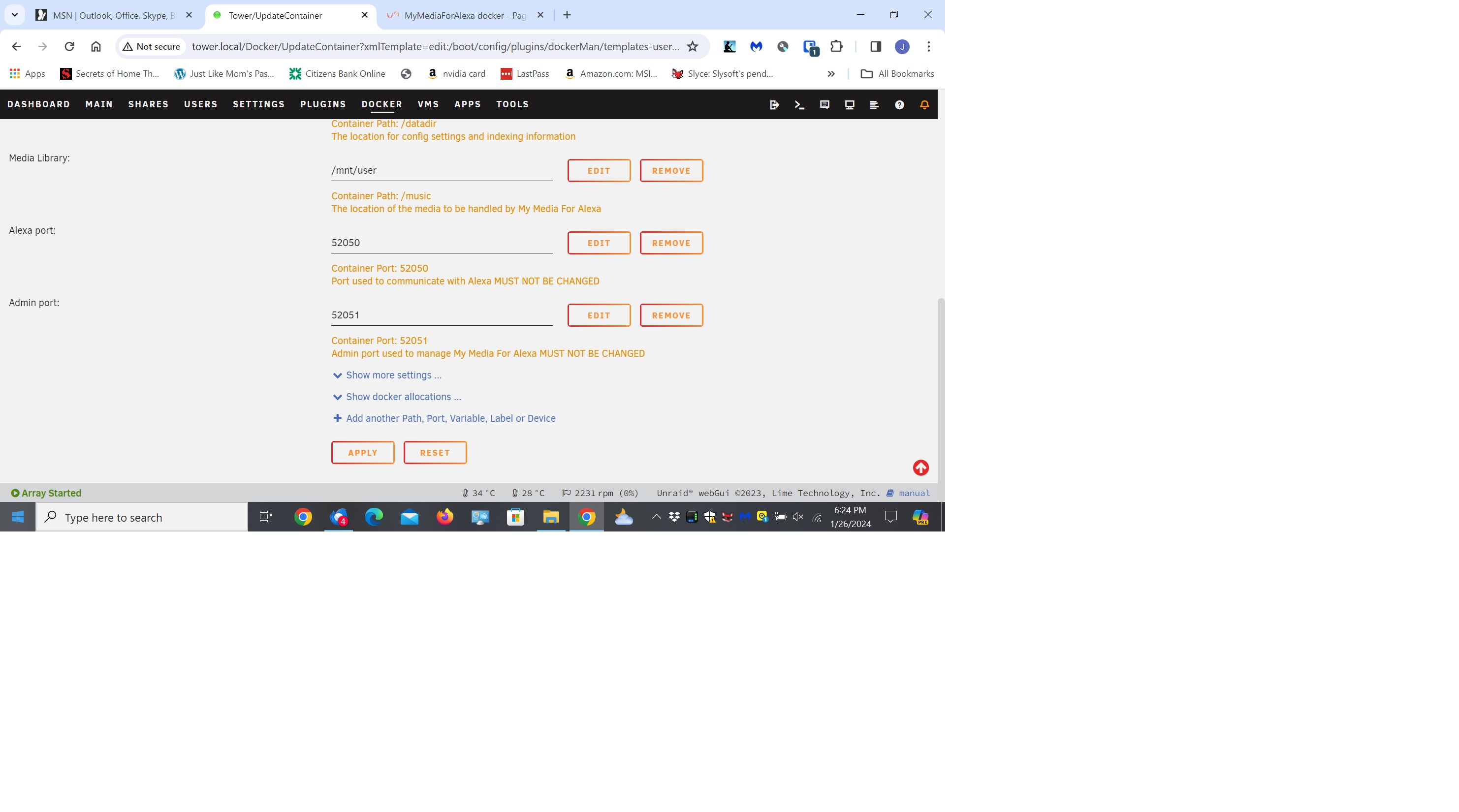

For those having issues with the upper left "not connected' problem, it is probably the settings for media path when you set up the app. I have been playing around with it and the connection only works with the attached screenshot. My problem is how do you get it off queued after you set up a watch folder

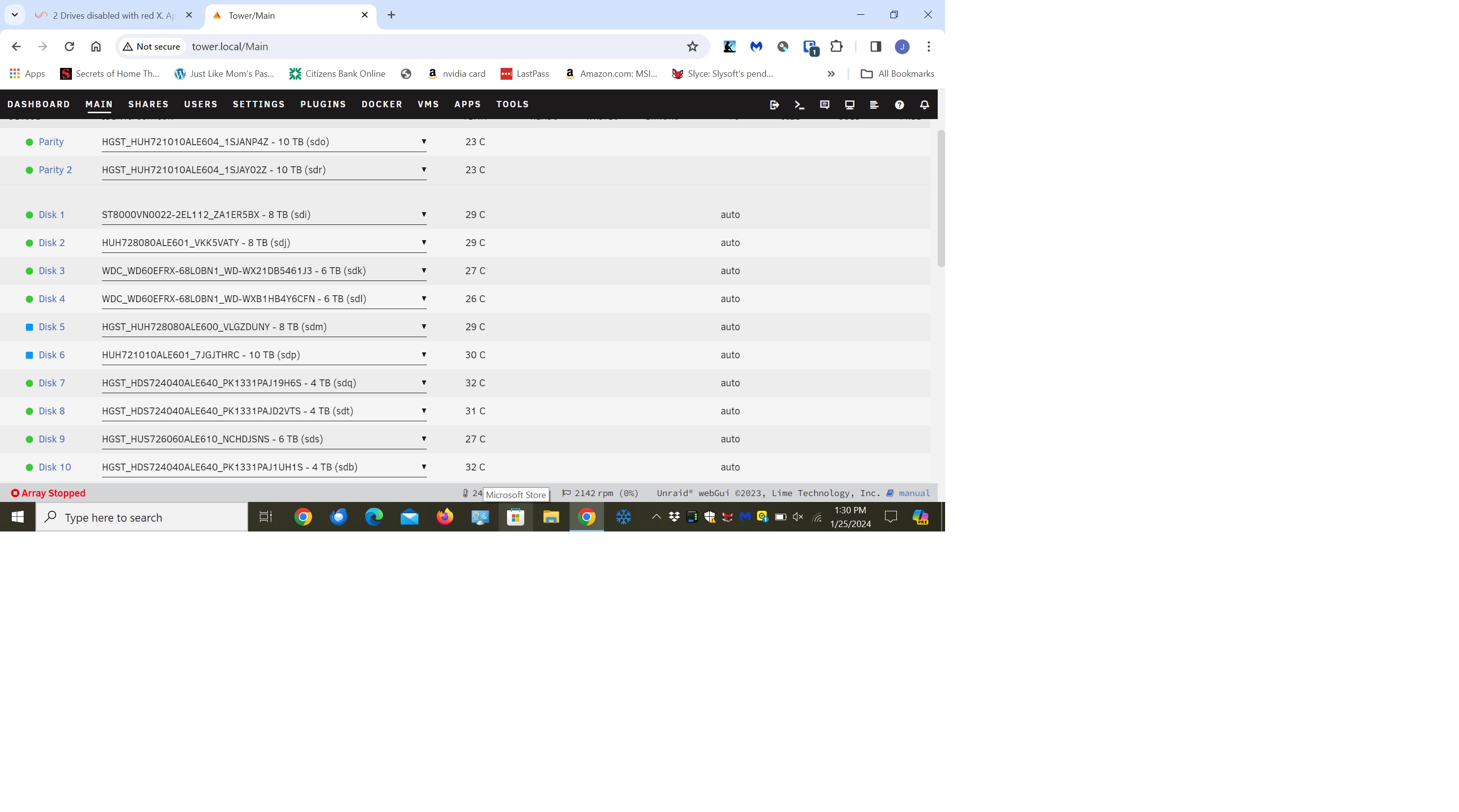

I swapped 7 & 8 with 4 & 6 Diagnostic attached tower-diagnostics-20240124-1545.zip

the first 8 drives use onboard Sata. I then have 2 lsi PCIE SAS cards. Each LSI card have 8 ports a piece. You should see 8 sata drives Including the 2 original drives that I just swapped out. When Unraid disables a drive, does/can it set a flag stating that the drive is unusable? Jumping at straws here.

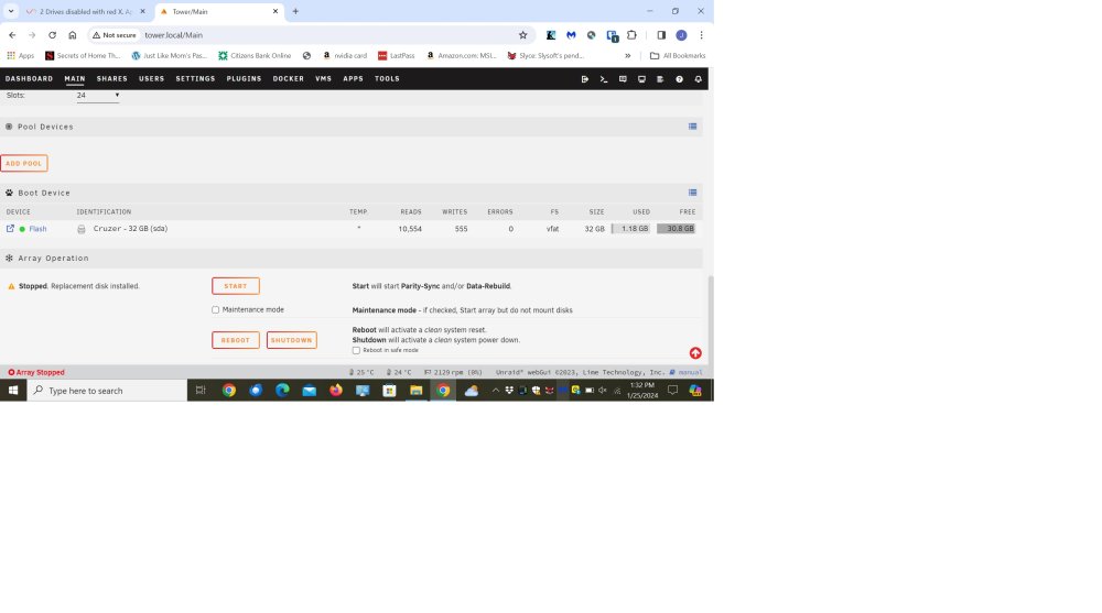

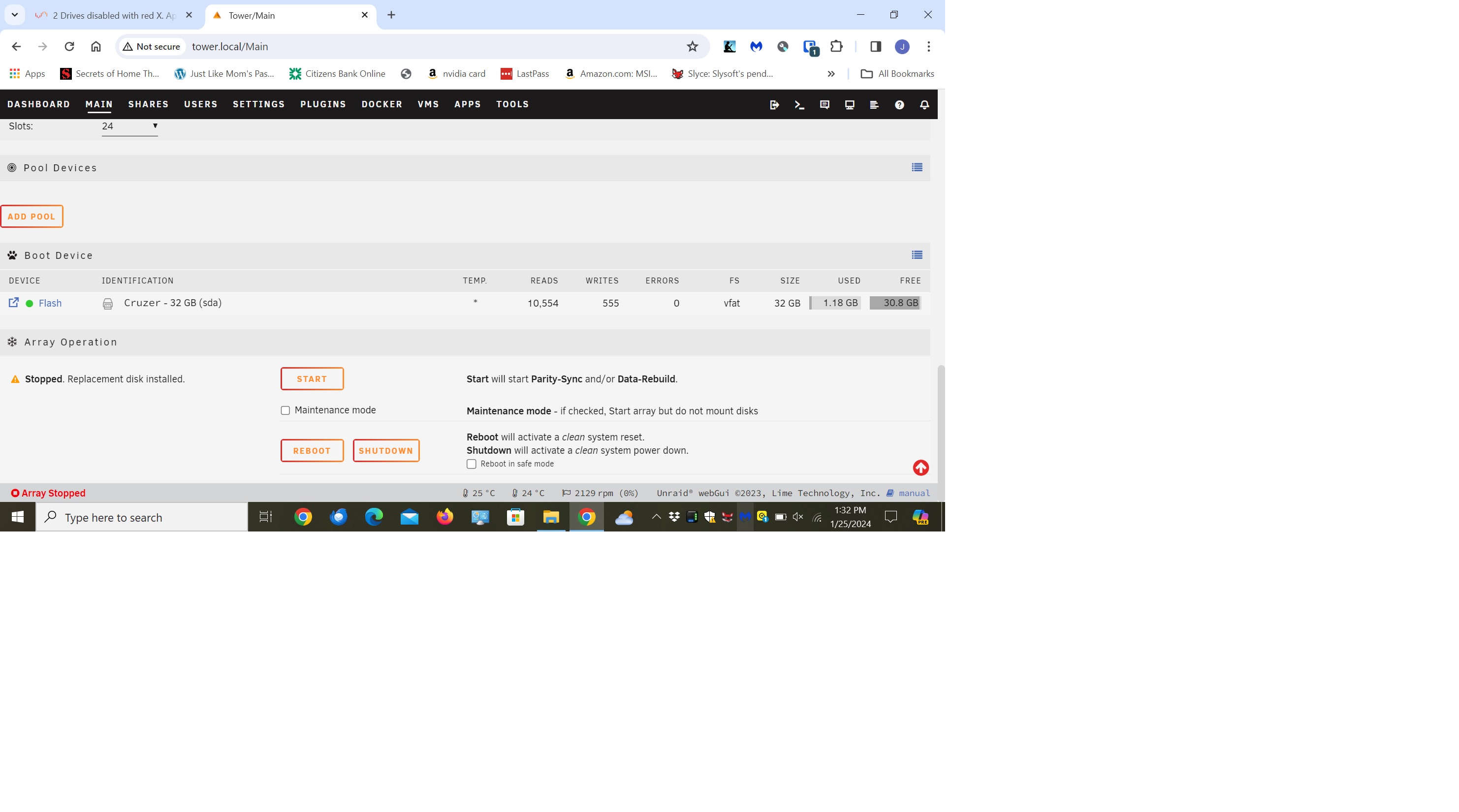

Okay, I swapped out the discs in bays 5 & 6 and still can't see the discs. Want me to check the servers Bios to see if they are there? Heres the newest diagnostics. tower-diagnostics-20240124-1157.zip
