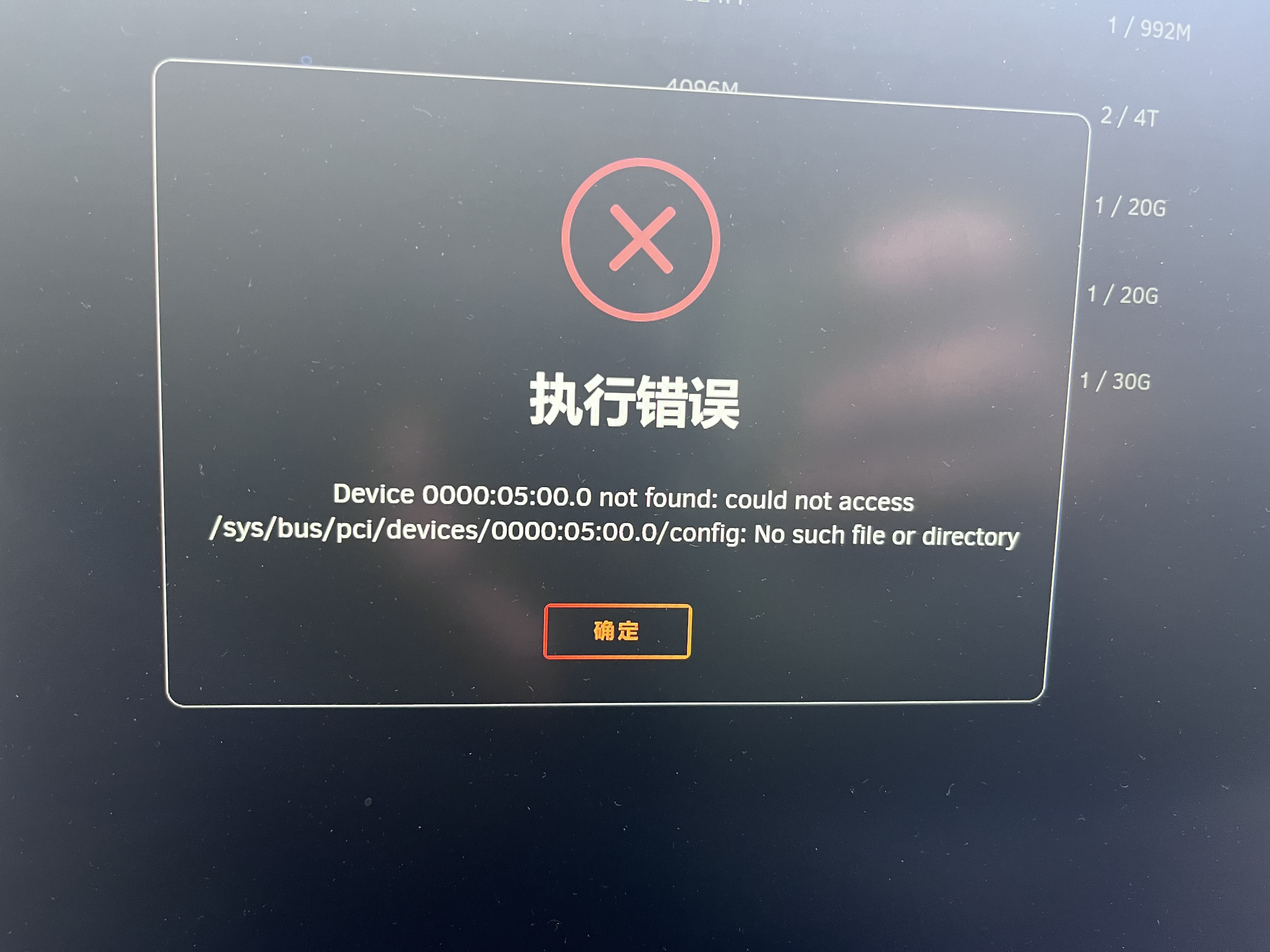

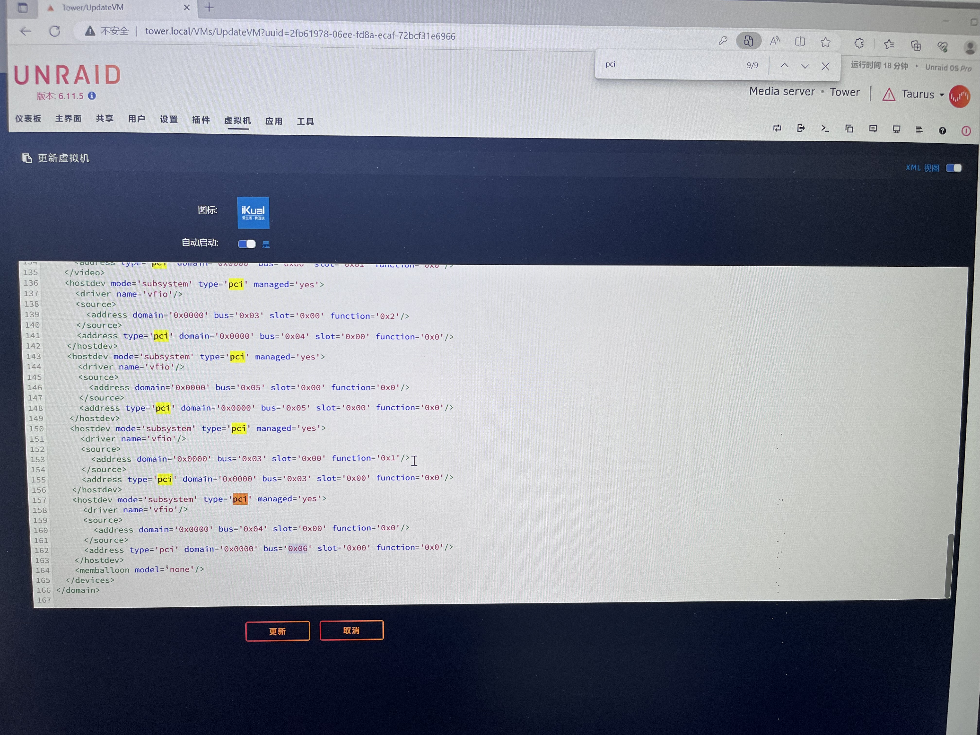

  1. 我最后搞定了,在xml视图里找到hostdev开头的代码,删除掉对应的设备(注意辨别一下需要前几行),删除前备份一下。
  2. I upgraded my PC device for DRAM and NVME SSD, and then find the PCIE no.s were changed. So my VMs can not started, the warning as attached picture. 05.00.0, now is 04.00.0, so how can I change this pcie device no. to this new one? I tried to find this old no. in basic or xml view, But I didn't find it. Could anyone support here? Thanks

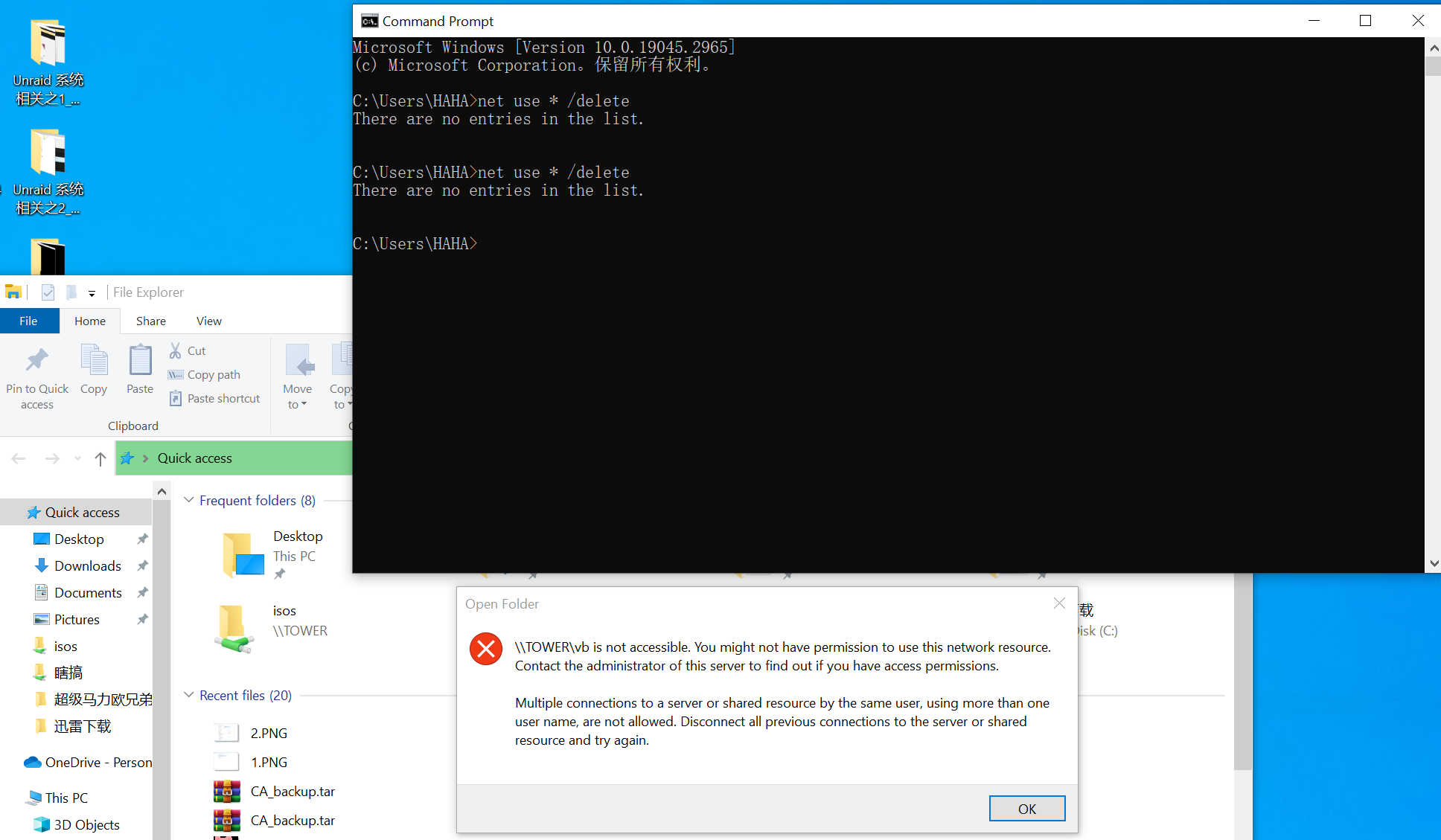

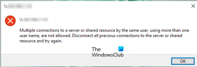

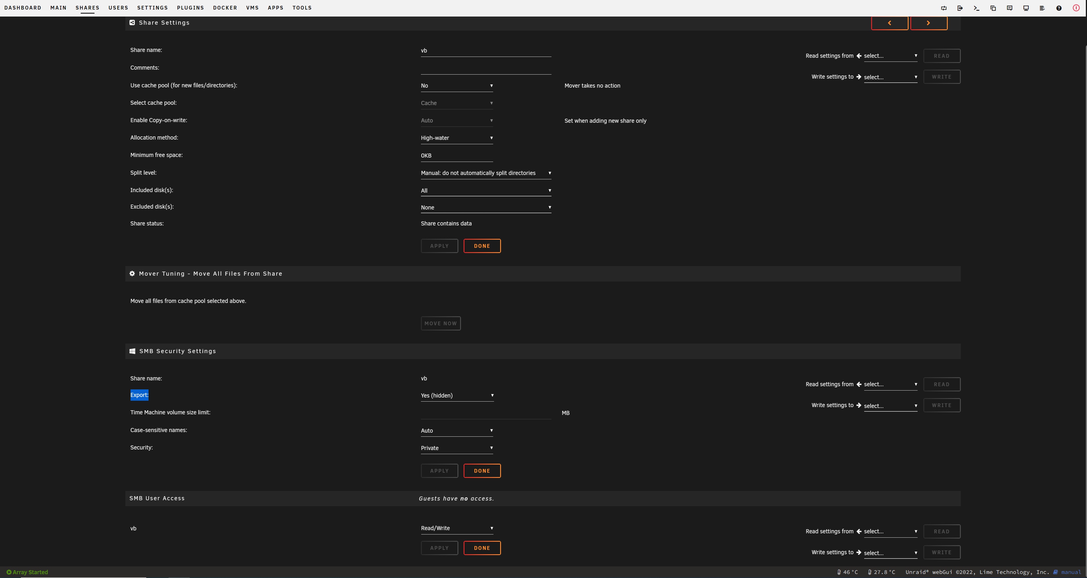

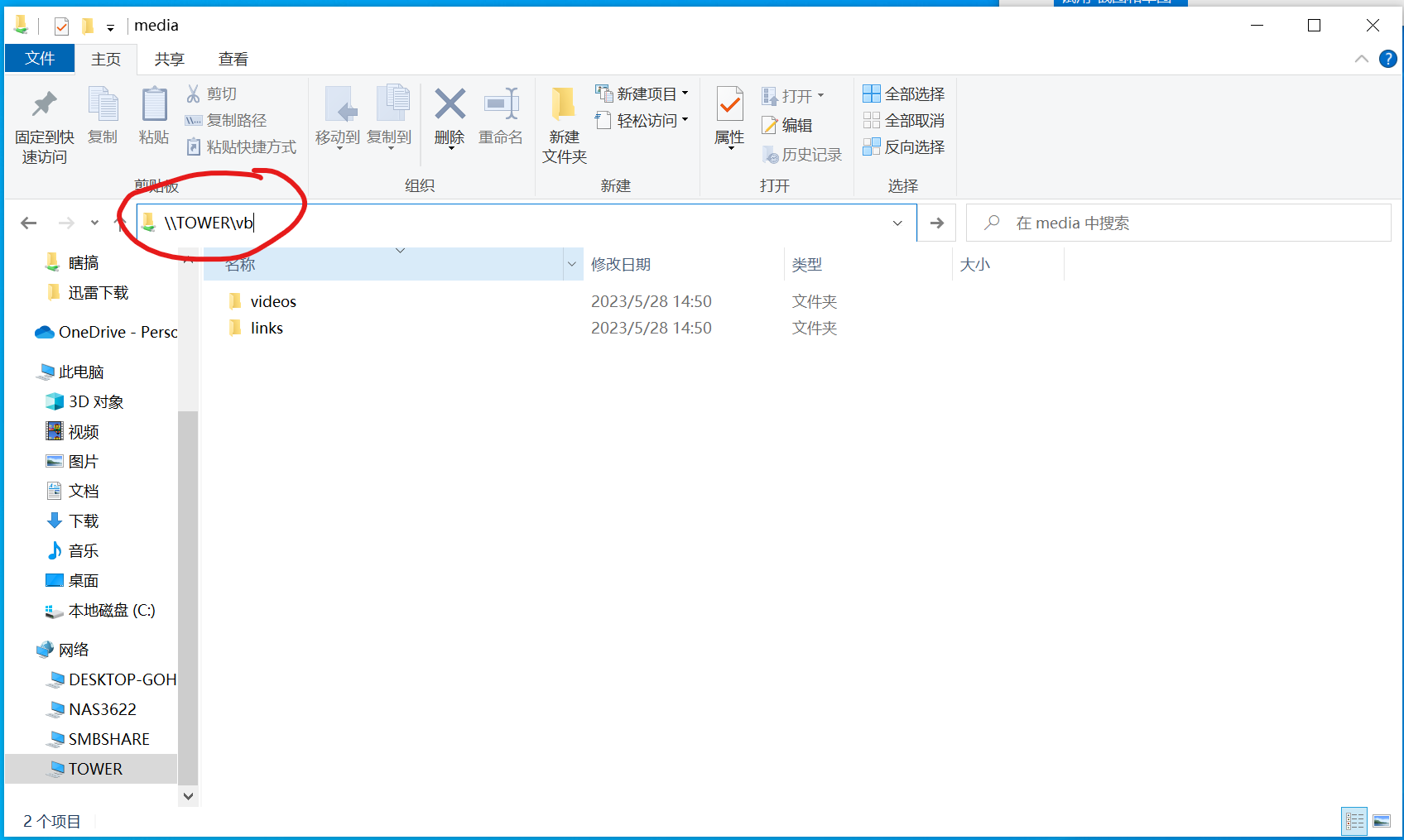

  3. if I use SMB Security Settings -》 Export: -》 Yes(hidden), then I can not login the SMB folder after using account name and password from WIN10. But if I use SMB Security Settings -》 Export: -》 Yes, without hidden, then I can login the SMB folder after using account name and password. So I can not to visit hidden folder with account name and password? or neet some other settings? tower-diagnostics-20230605-2130.zip

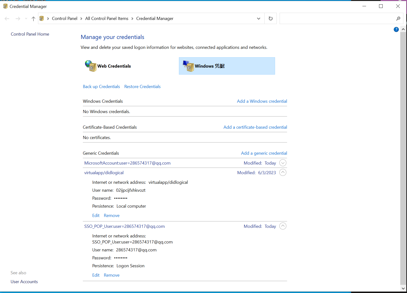

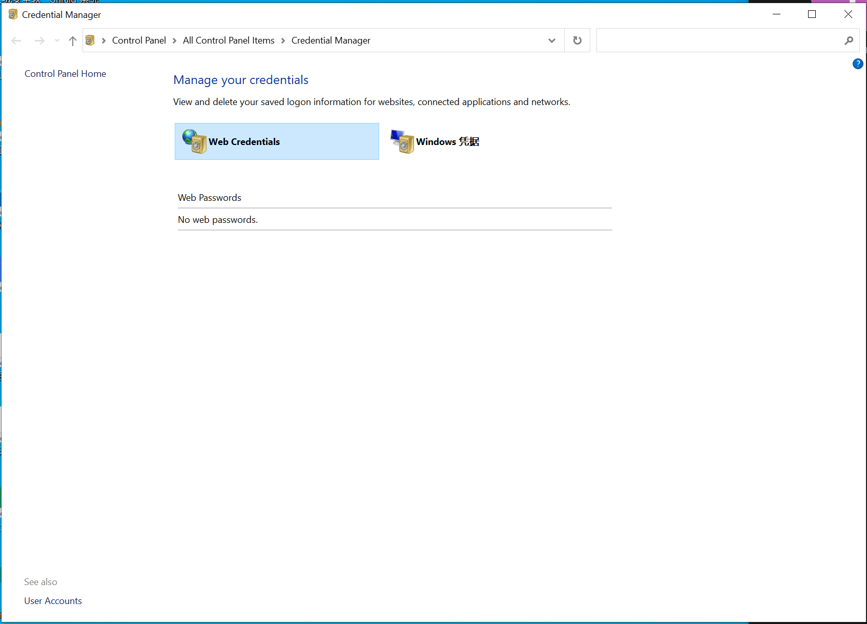

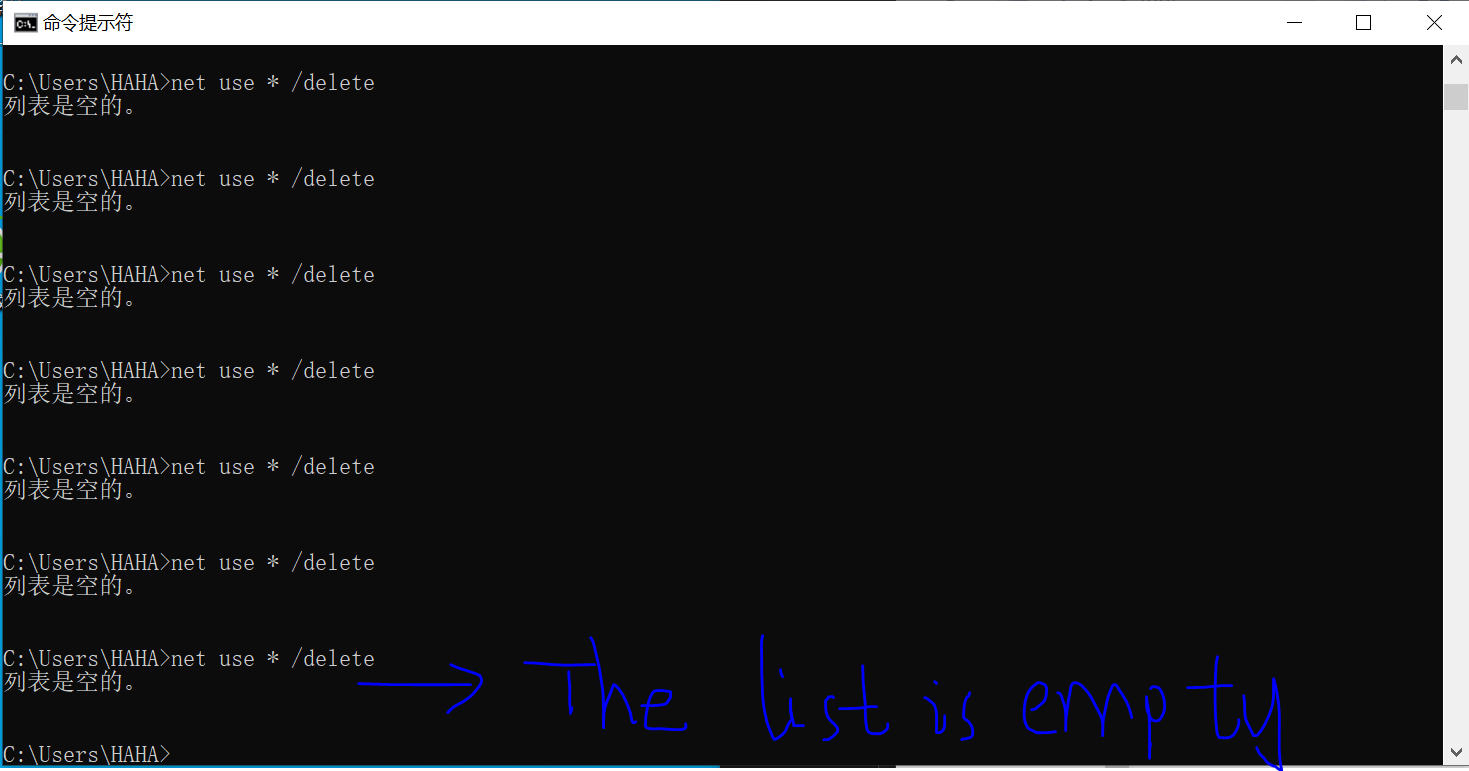

  4. to descirpe the issue clearly, I changed my windows language to ENGILISH. You can see my setting in Credential Manager.
  5. I tried, but the issue was not solved...
  6. I just type the folder addree(due to the folder is hidden), then login with the account 'vb', but after I type the account name and password, then the error happened, just like what I show in this topic.
  7. if I use SMB Security Settings -》 Export: -》 Yes(hidden), then I can not login the SMB folder after using account name and password from WIN10. But if I use SMB Security Settings -》 Export: -》 Yes, without hidden, then I can login the SMB folder after using account name and password. So I can not to visit hidden folder with account name and password? or neet some other settings?
