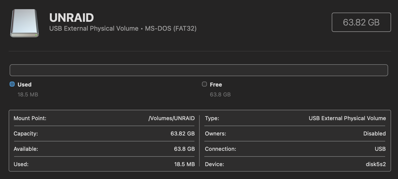

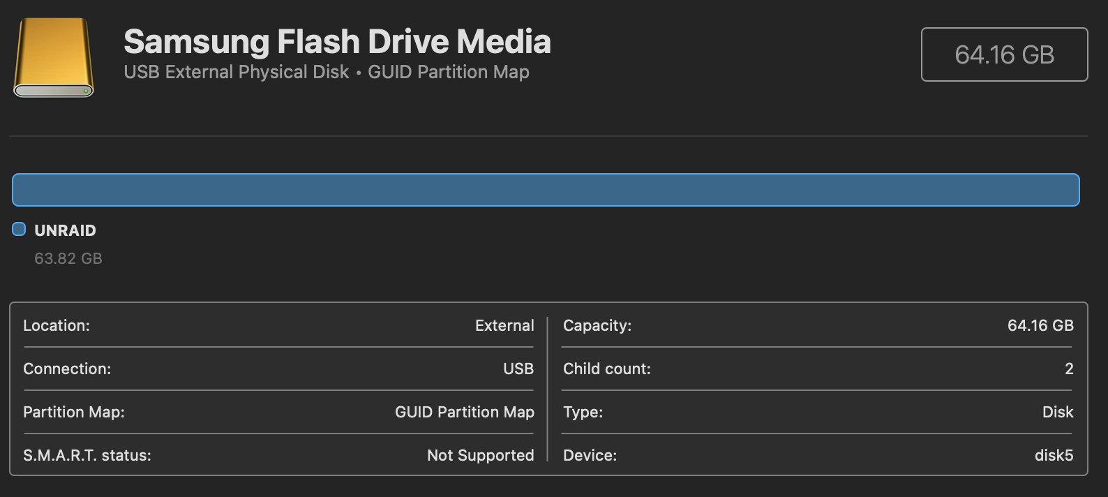

  14. Reformatted drive, now it says "USB External Physical Disk • Master Boot Record" for the Samsung Flash Drive Media 64.16GB "USB External Physical Volume • MS-DOS (FAT32)" for the UNRAID 62.16 partition Downloaded "unRAIDServer-6.12.4-x86_64.zip" from the website. I opened the zip in my download folder and copied the "unRAIDServer-6.12.4-x86_64" folder to USB drive. Removed "-" from EFI- folder. Ran the executable "make_bootable_mac" Terminal output: Transferred USB to machine, turn on straight to BIOS, switched some settings as mention in OP and still batting in BIOS. Awaiting specific settings guidance or further instructions.
