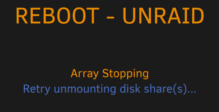

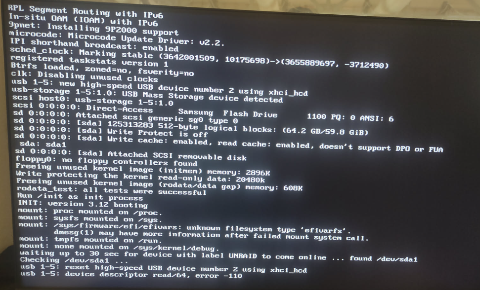

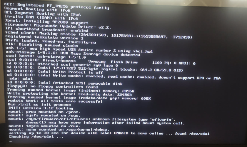

  6. Hello, I have a strange issue with UNRAID not booting after a reboot. If I force it off then start again it's working. The step where is stopping is in the picture below. It stays like that fo a while and then see second picture. I attached the diagnostics also. Did anybody encounter that? What can I do to fix it? fi-tech-diagnostics-20250214-1143.zip

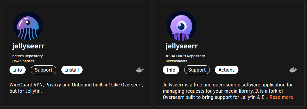

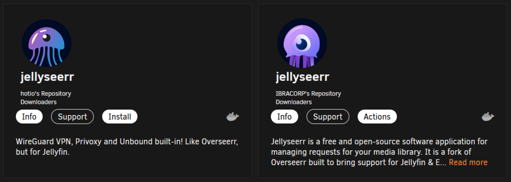

  7. I managed to identify the issue. I'm not sure why but the Jellyseerr container caused the unclean shutdown. I had installed the hotio version. I erased that and replaced with IBRACORP version and now the restarts are ok.
