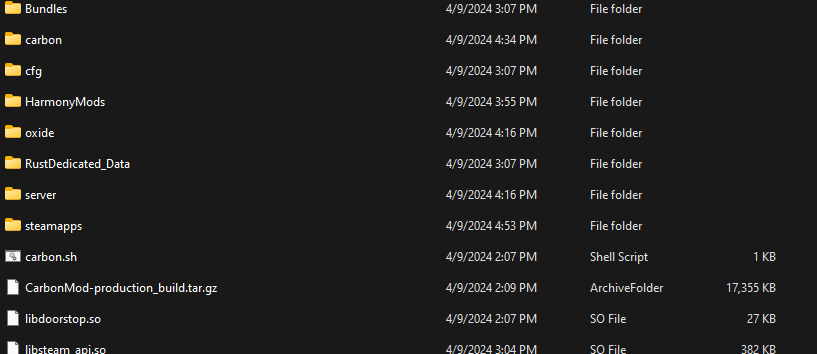

  5. Rust server with the Carbon Mod set to true starts up okay on initial start up. If the container is shutdown for any reason and started again, it says the following. and sits idle. I can confirm carbon is still installed on the server as well in my appdata folder at minimum so not sure what's missiing and why its stating its not found etc.

  9. Yes and no. They put their site up https://carbonmod.gg/ which contains the needed linux/windows files to run the oxide replacement. Oxide itself needs to be removed from the equation and carbon dropped at the RustDedicated file level and is supposed to just go. Ive heard of developers and others stating there needs to be some additions to the Docker variables so things load in a certain order and a specific file is loaded prior to the SteamCMD process kicking off. Built a standalone linux rust server to test and the resource consumption is non-existent compared against Oxide, defiantly going to be the new way to go in the future.
  10. So Codefling just released Carbon for Rust as a more efficient replacement for Oxide. Is there an elegant way to get that running on the Rust Docker App?
