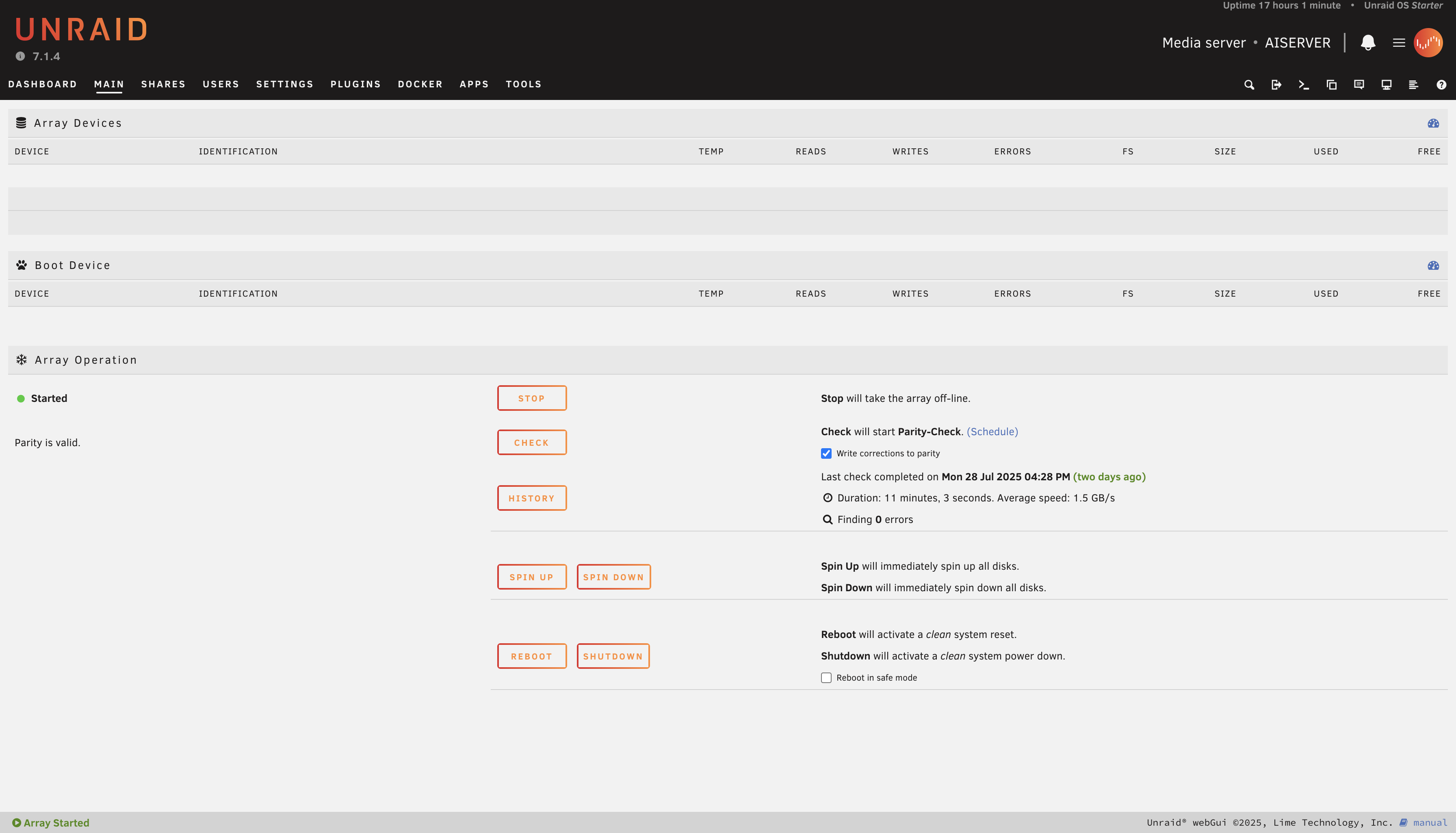

  2. @MAM59 - Yes tried everything almost also inspected the entire page and i could see there is an error at Graphql which is failing to fetch, its not an issue per se but i find it somewhat uncomfortable that the page reloads takes a while to fetch.
  3. Hey @elibosley Thanks for the quick response, Well out of frustration i tried solving the issue and the same was solved after i zipped the dynamix.my.servers and the .plg file components from a working unraid machine and extracted the same on the broken one and installed the plugin manually. The root issue is resolved but i have an UI issue where the "Main" dashboard sort of grays out or the fields load after some considerable amount of time. Attaching the screenshot.
