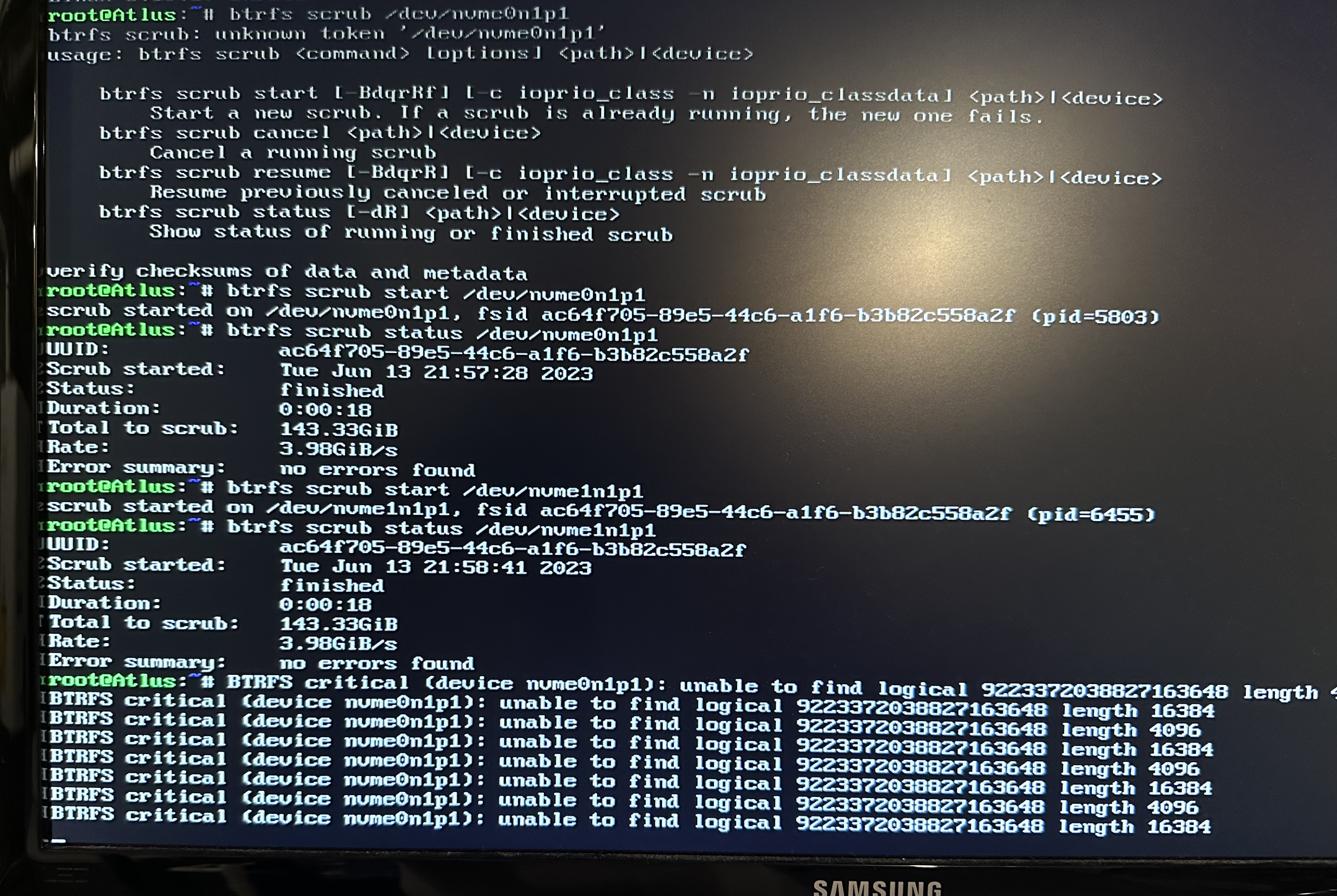

@JorgeB and @trurl I thank you both for your kind attention to my issue. I am very much a layperson with a keen interest in setting up my humble homelab that's grown to this point. I would never have reached this point without these communities. Thank you again. In summary, due to a long standing corruption in the cache from some power outages last year, the docker service finally stopped working. Solution: [1] stop docker and vm, [2] backup all important files from the impacted cache, [3] stop the array, [4] format the target cache, [5] return the files to the cache, and [5] restart docker. My issues resolved at this point and I had no other steps to take.
BTRFS critical: unable to find logical [x] length [y]
I'll back up what's on the cache. For my reference, I notice that there's a file share named system that is set to prefer cache. Is there a safe procedure for me to back up the contents, and then reformat the cache without causing any needless disruption?
I rebooted my router. I also shut off enable bonding under the Network Settings. (no idea if that helped with the earlier messages about bond0) At some point I am now able to log into the server from within the network, which as far as I'm concerned is progress. atlus-diagnostics-20230614-2037.zip
I tried to turn the docker service back on and I am unable to. I also rebooted the server and the docker service doesn't come back.
I haven't really interacted with network settings. Are there some settings I should look over? Is there a how-to to reset the network settings?
