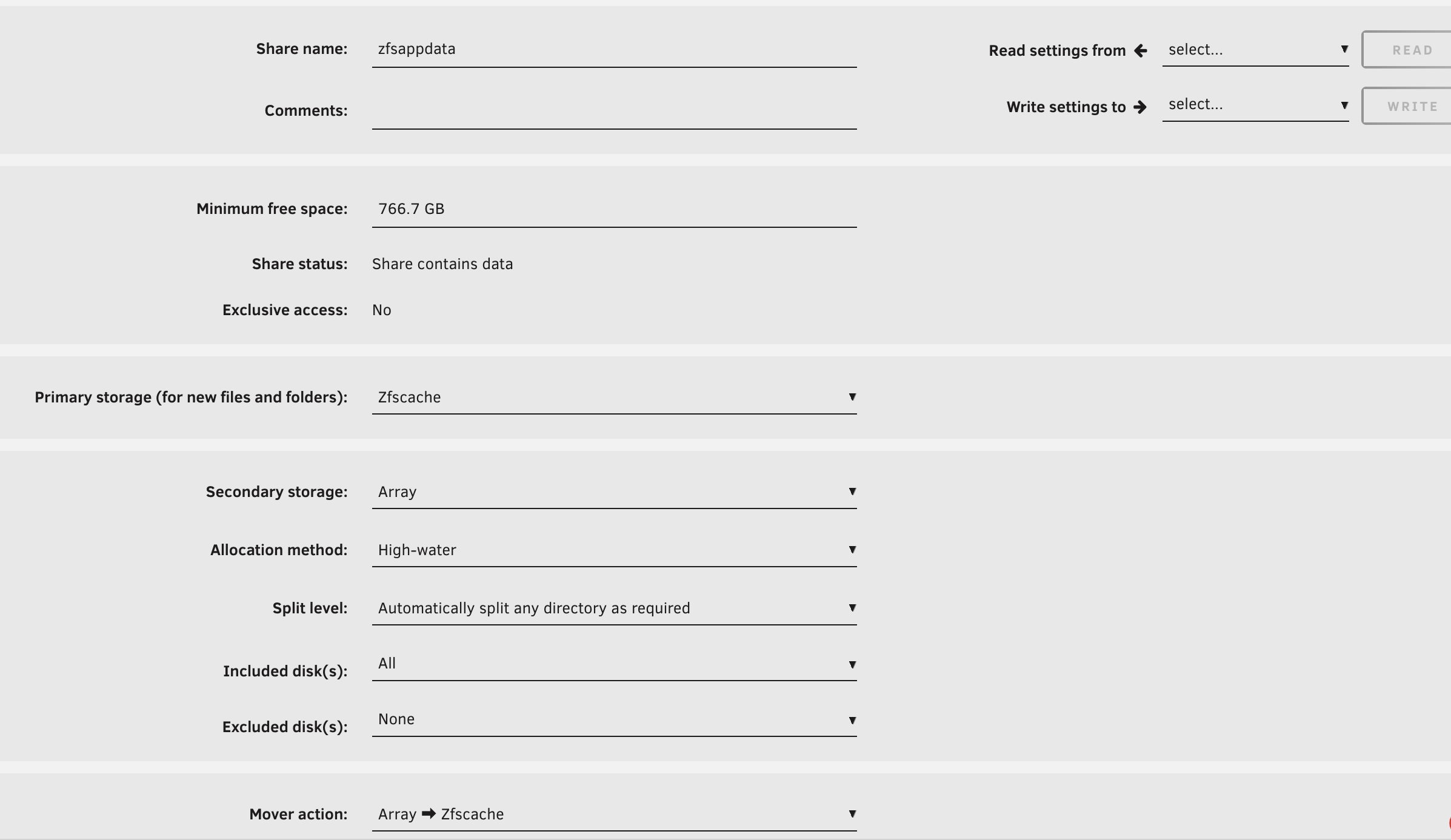

  1. @trurl Thank you for your reply. I'll include the screenshot for zfsappdata share. When I have some time I'll carefully open up the server and check all the connections to the drives. I was never good at cable management so maybe I'll let the side panel of my PC stay loose instead of jamming everything in. I haven't looked at what's in lost+found so I'll check it out. If nothing in there appears important can I safely delete the contents?
