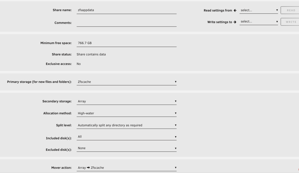

I'll include the screenshot for zfsappdata share.
That share is configured to move files from array to zfscache. But it has no files on the array. Set it to Secondary storage:cache then you should be able to set Mover action to cache->Zfscache. As mentioned
31 minutes ago, trurl said:
Nothing can move open files. Simplest thing is to disable Docker in Settings
Then you can run Mover to get those moved from cache to Zfscache.
