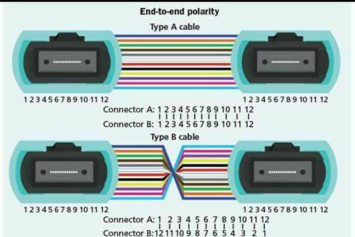

My cable just arrived today from China and the network was picked up immediately upon plugging it in, I needed a 12 core cable instead of a 24 core cable, and a type B cable instead of a type A! Thank you for the help here with narrowing down what could go wrong and the IP range validation and such!

I think standard could mean either of them, they're just listed on ebay for example 'ect ect type a cable' £60 and 'ect ect type b cable' £60 no colour change on the cable, no big description change, it's just as likely you'd hit an A or a B if a person went with top of page result

Trying to find the right cable is a bit of a pain, the ones i'm finding are '8 core' instead of '24 core' and i'm not sure if i need a 'patch cable' or a 'trunk cable' for a direct connection or one of the other types. And then there's 'type B Chanel 1 to Chanel 12' and I guess something else out there. Ugh, i wish the cable I have worked. https://www.fiber-optic-transceiver-module.com/difference-between-fiber-trunk-harness-and-patch-cables.html seems like Patch Cable is fine. Seems like the difference between and A and a B type is important and i have no idea which i need https://community.fs.com/news/type-b-polarity-mtp-cable-user-guide.html I think I need a Type-B Trunk Cable from reading this, I might be completely incorrect though

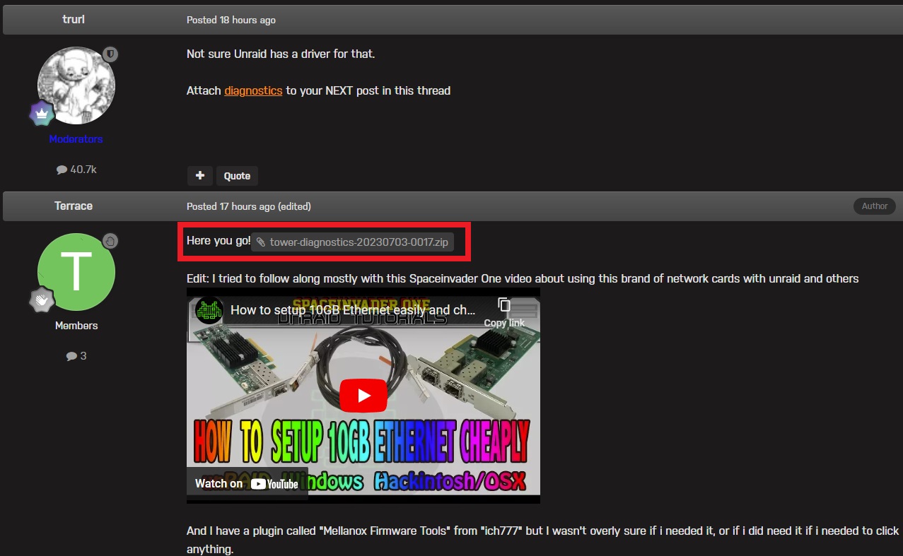

Are the diagnostics not visible from the last time i posted them? trurl asked me to post them as the first post, and then i immediately posted them. Is my attachment not visible to others?

Here you go!tower-diagnostics-20230703-0017.zip Edit: I tried to follow along mostly with this Spaceinvader One video about using this brand of network cards with unraid and others And I have a plugin called "Mellanox Firmware Tools" from "ich777" but I wasn't overly sure if i needed it, or if i did need it if i needed to click anything.
