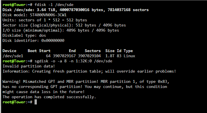

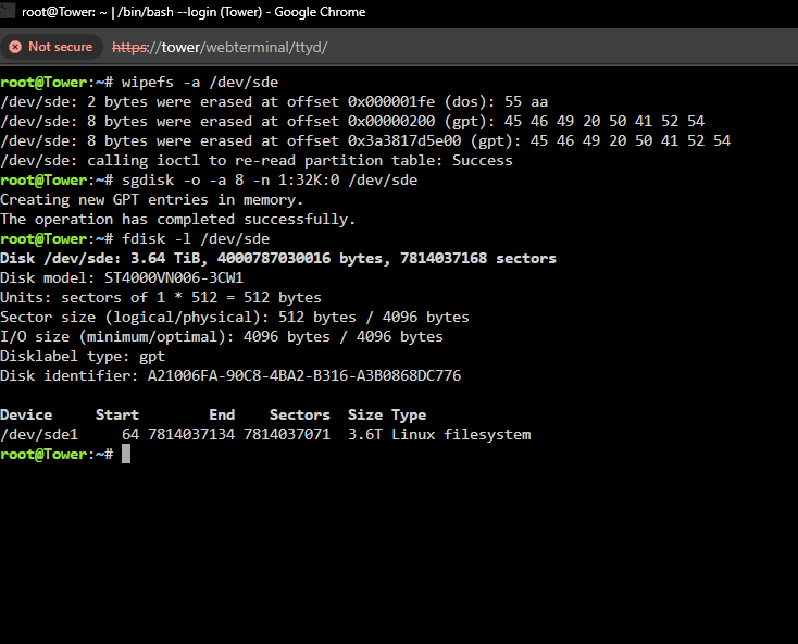

  5. Trying to summarize 1. After upgrading 2 of my drives unmountable Check using fdisk -l /dev/sdb and fdisk -l /dev/sde, both drives detected 2 TB, real capacity is 10TB and 4TB so next step. Using command from this post Check again with step number 2, if didn't work try this post If the problem still persist then try this step if the drives already detected with the real capacity, then do this Then all is good :D Thank you hope it helps for someone that have the same problem with me

  10. How to fix backup header for sde?
  11. This is result of the command, is it okay? to restart?

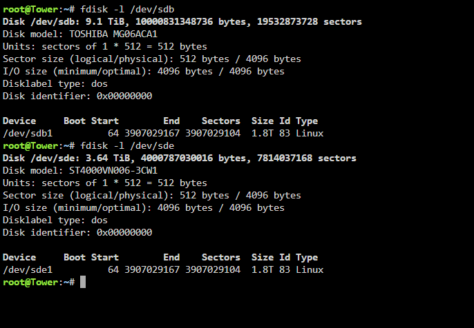

  12. Here is the output root@Tower:~# fdisk -l /dev/sdb Disk /dev/sdb: 9.1 TiB, 10000831348736 bytes, 19532873728 sectors Disk model: TOSHIBA MG06ACA1 Units: sectors of 1 * 512 = 512 bytes Sector size (logical/physical): 512 bytes / 4096 bytes I/O size (minimum/optimal): 4096 bytes / 4096 bytes Disklabel type: dos Disk identifier: 0x00000000 Device Boot Start End Sectors Size Id Type /dev/sdb1 64 3907029167 3907029104 1.8T 83 Linux root@Tower:~# fdisk -l /dev/sde Disk /dev/sde: 3.64 TiB, 4000787030016 bytes, 7814037168 sectors Disk model: ST4000VN006-3CW1 Units: sectors of 1 * 512 = 512 bytes Sector size (logical/physical): 512 bytes / 4096 bytes I/O size (minimum/optimal): 4096 bytes / 4096 bytes Disklabel type: dos Disk identifier: 0x00000000 Device Boot Start End Sectors Size Id Type /dev/sde1 64 3907029167 3907029104 1.8T 83 Linux" "

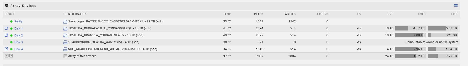

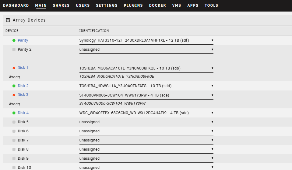

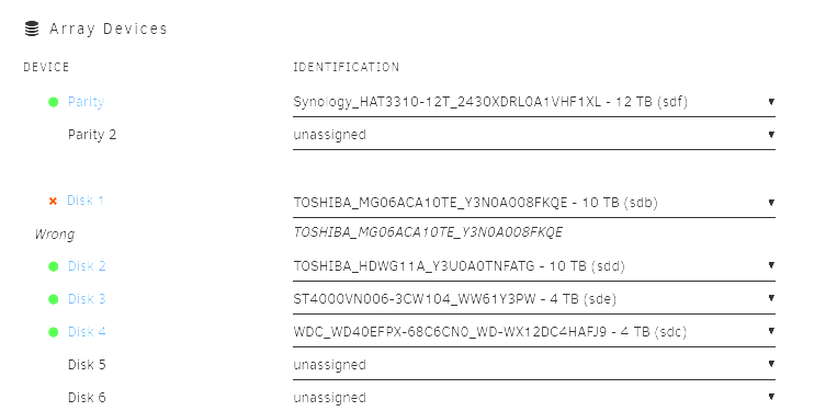

  13. Hello, I just upgrade my unraid twice, first from 7.0.0 to 7.10, reboot and success but I set my array to not automatically start but all the disks is recognizeable, so I continue to updated it to 7.12 version, after I reboot , 2 of my disks read wrong disks, I cannot start the array, So I setup new config, with all the same drive and start the array, Then 2 drives unmountable. As can be seen in the pictures both drives are the same as before. The diagnostics attached, Thanks tower-diagnostics-20250522-1500.zip
