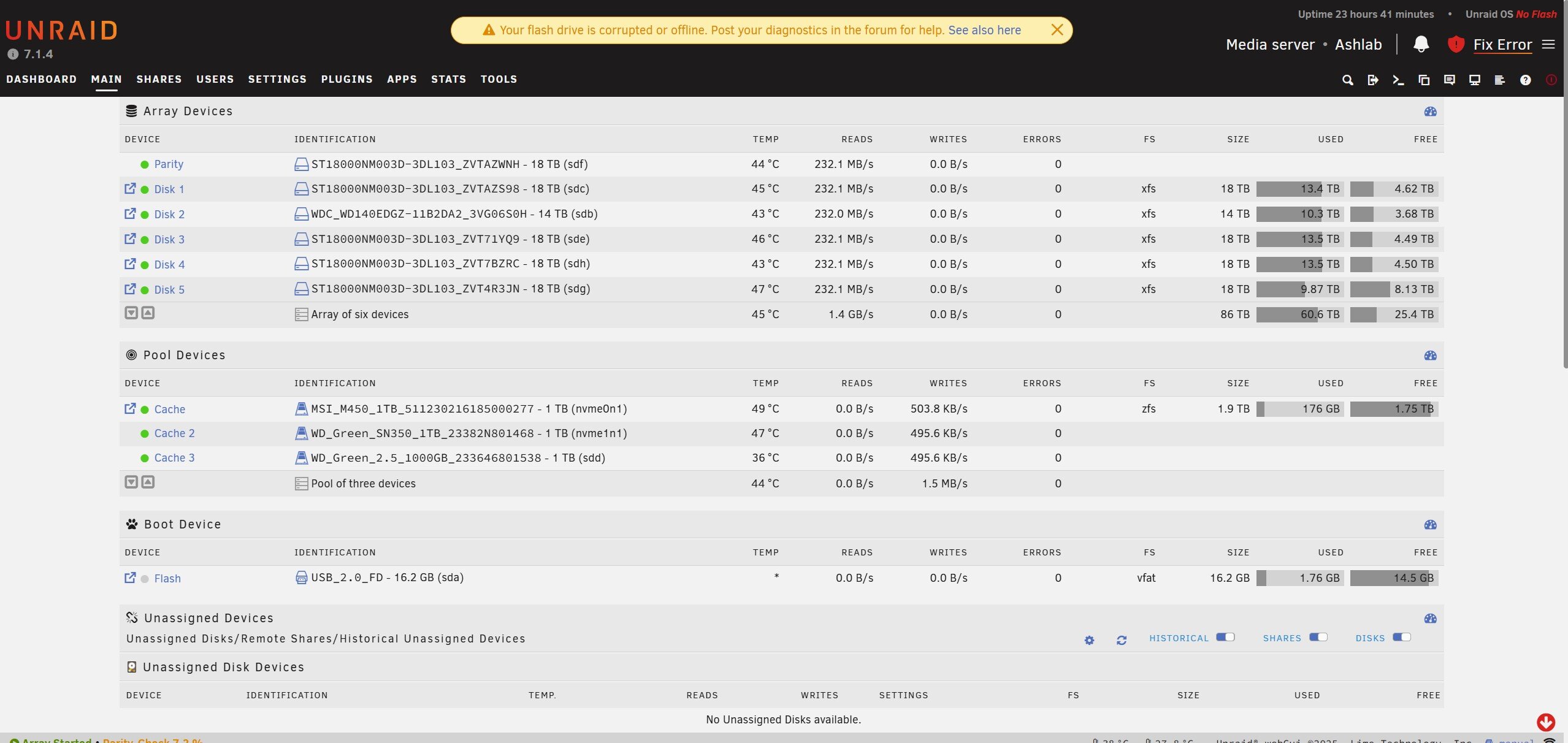

  3. Greetings I recently noticed that my disk 3 has a error "device is disabled, contents emulated" I looked up and read...So i stoped the array, unassigned the disabled disk from partition and started array again, then stoped array again, then reassigned the disk to same slot and started maintenance mode and iniated sync. Shortly after initiating sync, the sync paused and same error showed up next to my disk 3, at that time under error colum i noticed 1024 as errors as well. So does this mean my drive is bad? I have attached a diagnostic and smart quick test. I am doing the extended test right now also. Thank you for any help or advice ashlab-smart-20251203-2216.zip Unconfirmed 156632.crdownload ashlab-smart-20251203-2122.zip

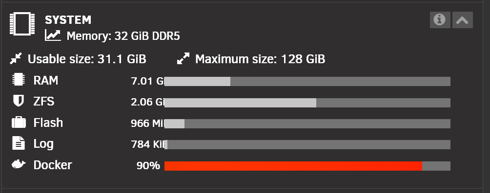

  9. I would appreciate any clarification on this topic in more detail My image file size is set to 27Gb, because I increased it, I am also aware that now I can not make a smaller img file without deleting all my docker applications and starting from scratch (which is so much time I put is setting my dockers up I don't want to do unless I can save my docker setting and reload them.). On looking at container size I do not use that much space says 8.46 GB if I am understanding this correct. So not sure why the system section says I have 84% utilization Appreciate anyone's knowledge about this subject. Unconfirmed 998744.crdownload

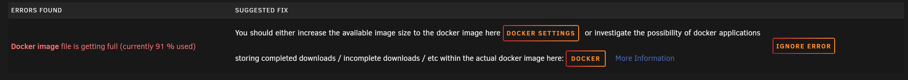

  10. why does it state system memory? I am a bit confused what this means. Can you help direct me where I can get more info what this means? Also, is the fact that it is in the RED a bad thing? How do I resolve it if it is? The fix common problems keeps showing I have limited space... see screen shot
