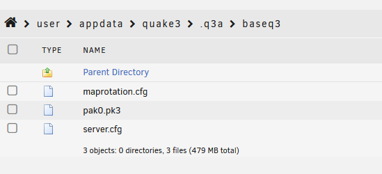

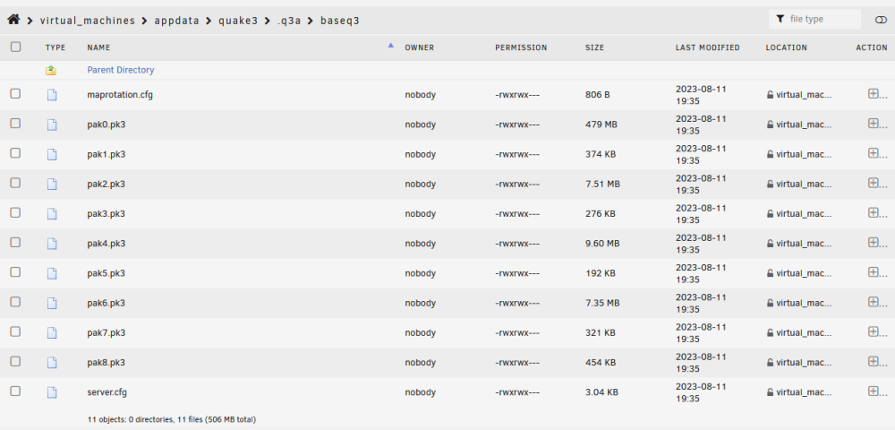

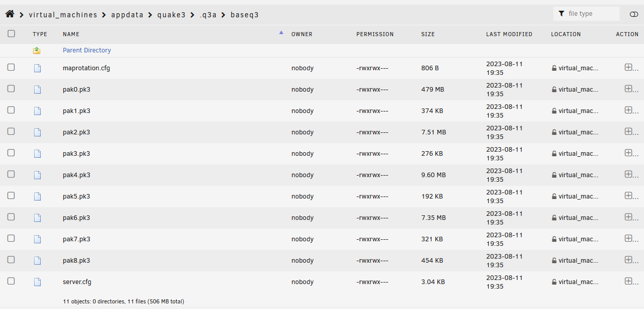

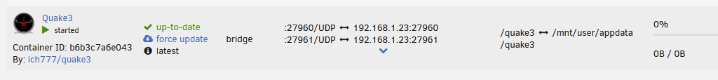

  1. Yeah, I'm not sure. I have tried 3 PK3 files now. I found some on a github. At the end of my log I noticed this: ---pak0.pk3 found, continuing--- ---Prepare Server--- ---Checking if 'server.cfg' is present--- ---'server.cfg' found, continuing--- ---Checking if 'maprotation.cfg' is present--- ---'maprotation.cfg' found, continuing--- ---Server ready--- ---Starting server--- So it eventually found it? The thing is if i have any PK3s in there it seems to not do anything, the webgui shows that the docker is using 0% CPU and 0bytes of RAM, if i remove the PK3 files it at least runs to some degree. Is there a specific version of the PK3 files i would need, or is it pretty universal? Appdata is on an SSD in a pool for the sole purpose of running VMs and dockers, no alternative storage is set. These are the PK3 files i found on that github, decided to dump them all in there. Same result. I don't know what info you might find useful. I'm still pretty green to unRAID and my understanding of the Linux file structure is pretty weak.

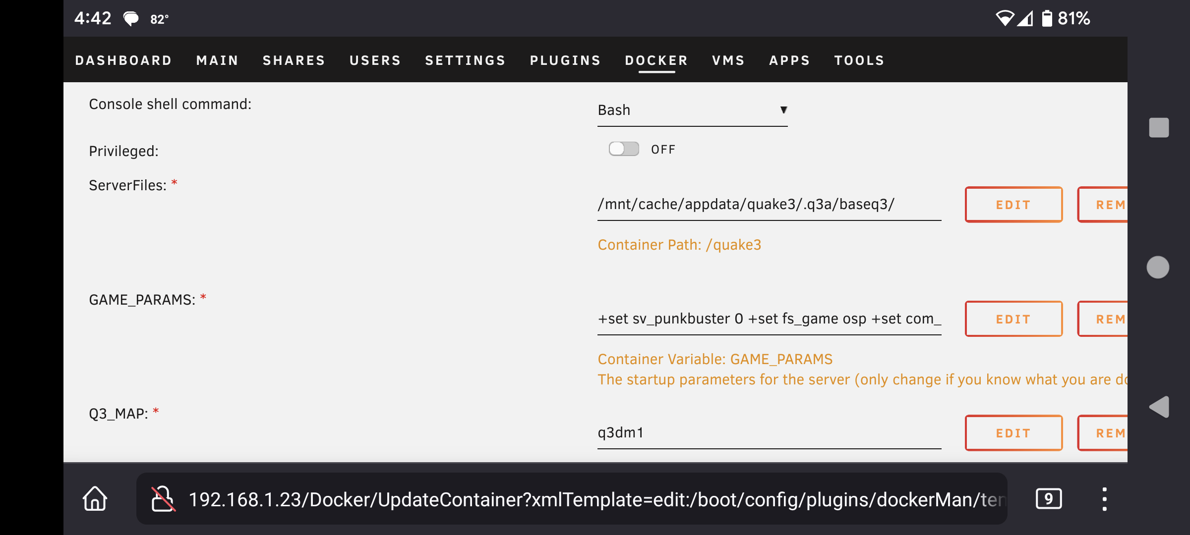

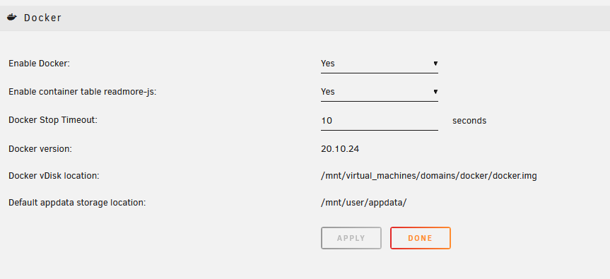

  2. Alright, got that sorted out. The default install path was in /tmp and I think that was throwing myself and the system off. Anywho looks like i have the files in the right spot, more files have populated around it, but now the console and the logs only show up for a split second, and I'm not sure it is even running. EDIT: I can see the logs after stopping the docker, here is what it has: text error warn system array login 0 files in pk3 files Sys_Error: Couldn't load default.cfg Q3 1.32c linux-i386 May 8 2006 ----- FS_Startup ----- Current search path: /quake3/.q3a/osp /quake3/osp /quake3/q3ded/osp /quake3/.q3a/baseq3 /quake3/baseq3 /quake3/q3ded/baseq3 ---------------------- 0 files in pk3 files Running in restricted demo mode. ----- FS_Startup ----- Current search path: /quake3/.q3a/demota /quake3/demota /quake3/q3ded/demota ---------------------- 0 files in pk3 files Sys_Error: Couldn't load default.cfg Q3 1.32c linux-i386 May 8 2006 ----- FS_Startup ----- Current search path: /quake3/.q3a/osp /quake3/osp /quake3/q3ded/osp /quake3/.q3a/baseq3 /quake3/baseq3 /quake3/q3ded/baseq3 ---------------------- 0 files in pk3 files Running in restricted demo mode. ----- FS_Startup ----- Current search path: /quake3/.q3a/demota /quake3/demota /quake3/q3ded/demota ---------------------- 0 files in pk3 files Sys_Error: Couldn't load default.cfg ---Ensuring UID: 99 matches user--- usermod: no changes ---Ensuring GID: 100 matches user--- usermod: no changes ---Setting umask to 000--- ---Checking for optional scripts--- ---No optional script found, continuing--- ---Checking if Quake3 is installed--- ---Quake 3 found, continuing...--- ---Taking ownership of data...--- ---Starting...--- ---Checking if .pk3 files are present--- ---pak0.pk3 found, continuing--- ---Prepare Server--- ---Checking if 'server.cfg' is present--- ---'server.cfg' found, continuing--- ---Checking if 'maprotation.cfg' is present--- ---'maprotation.cfg' found, continuing--- ---Server ready--- ---Starting server--- ---Ensuring UID: 99 matches user--- usermod: no changes ---Ensuring GID: 100 matches user--- usermod: no changes ---Setting umask to 000--- ---Checking for optional scripts--- ---No optional script found, continuing--- ---Checking if Quake3 is installed--- ---Quake 3 found, continuing...--- ---Taking ownership of data...--- ---Starting...--- ---Checking if .pk3 files are present--- ---pak0.pk3 found, continuing--- ---Prepare Server--- ---Checking if 'server.cfg' is present--- ---'server.cfg' found, continuing--- ---Checking if 'maprotation.cfg' is present--- ---'maprotation.cfg' found, continuing--- ---Server ready--- ---Starting server---

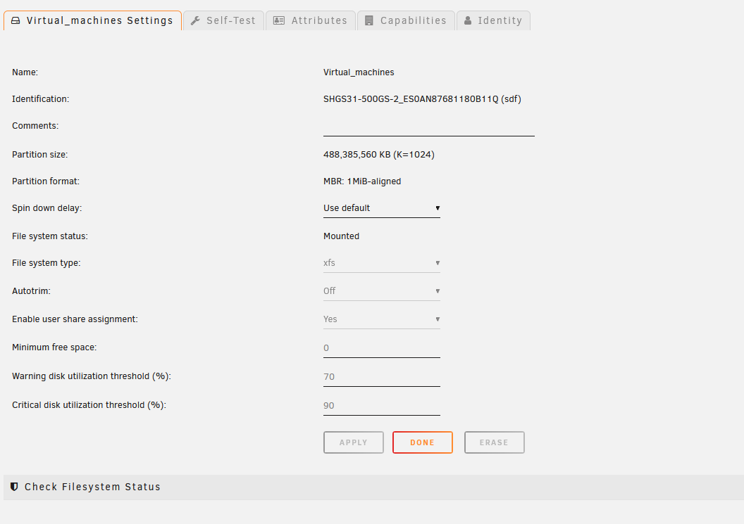

  3. That is just the name assigned to the SSD I use for VMs and Dockers. I'll uninstall and reinstall and try again in case I boogered it up.

  5. Yeah I restarted it. Initially I tried the pk3 files from the CD, the from the install (it's on a win98 box) and restarted each time. The path looked like it didn't go deep enough so I pointed it right to the folder. Still no luck.
  6. Howdy! I am trying to setup a Quake III Arena server, and this is what I am running into. My install only has the one PAK file. Any tips? Thanks!!
