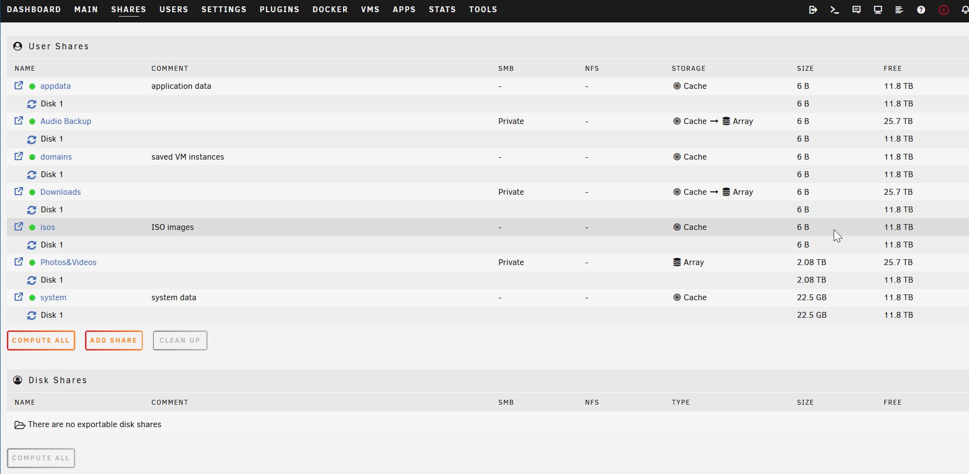

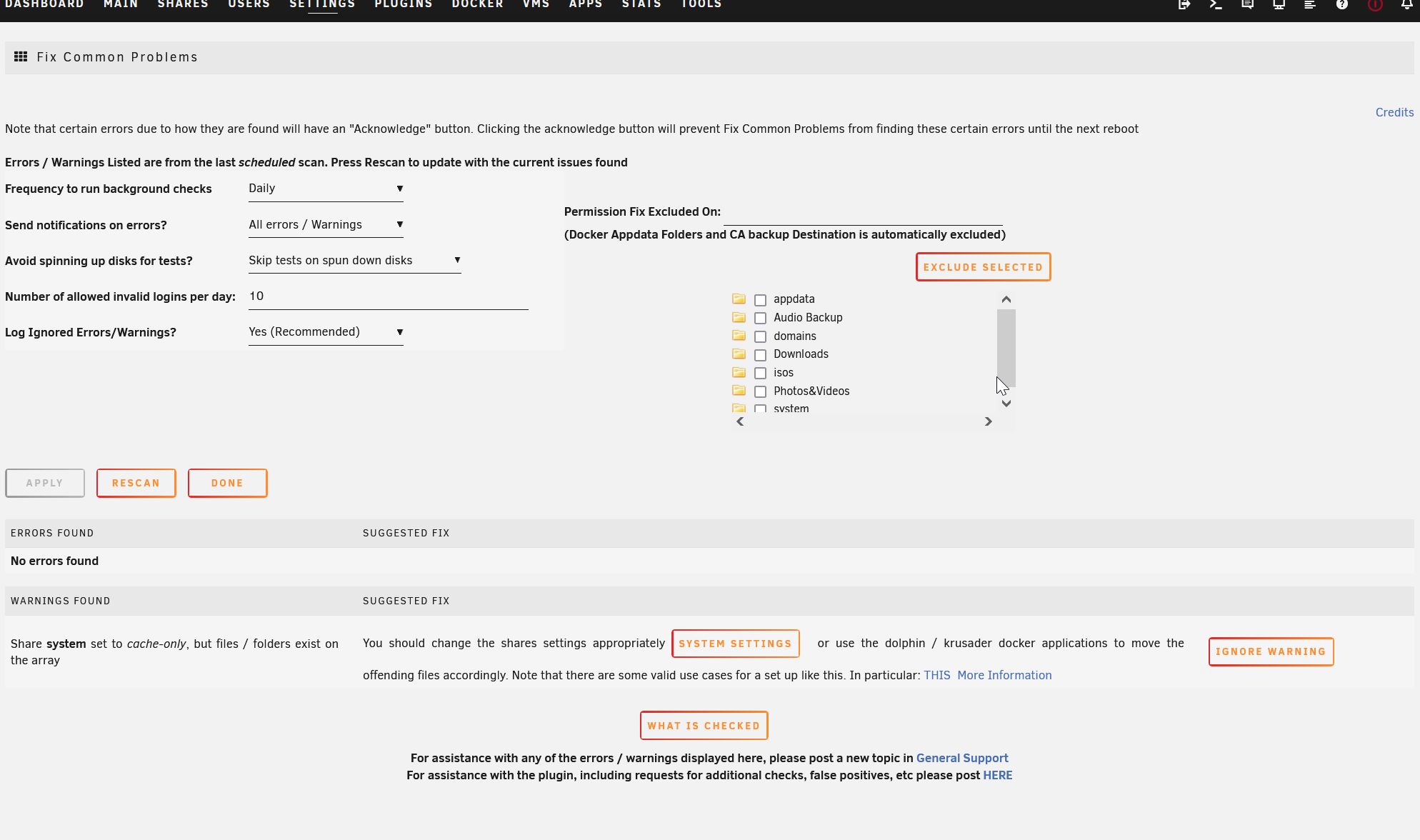

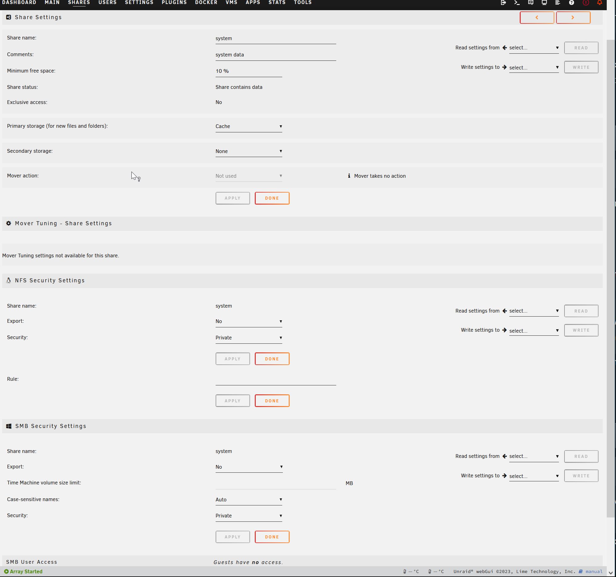

  14. Hi, I'm a new user. Following advice from an older thread, I set up my appdata, domains, isos, and system shares to primary>cache and secondary>array. I then learned that these settings are wrong and I need to set them to cache only and exclusive. However I cannot see how to do this. The 'fix common problems' plugin says 'Share system set to cache-only, but files / folders exist on the array. You should change the shares settings appropriately or use the dolphin / krusader docker applications to move the offending files accordingly. ' I have no knowledge of using docker. Can someone please help? Thanks tower-diagnostics-20230917-1235.zip
