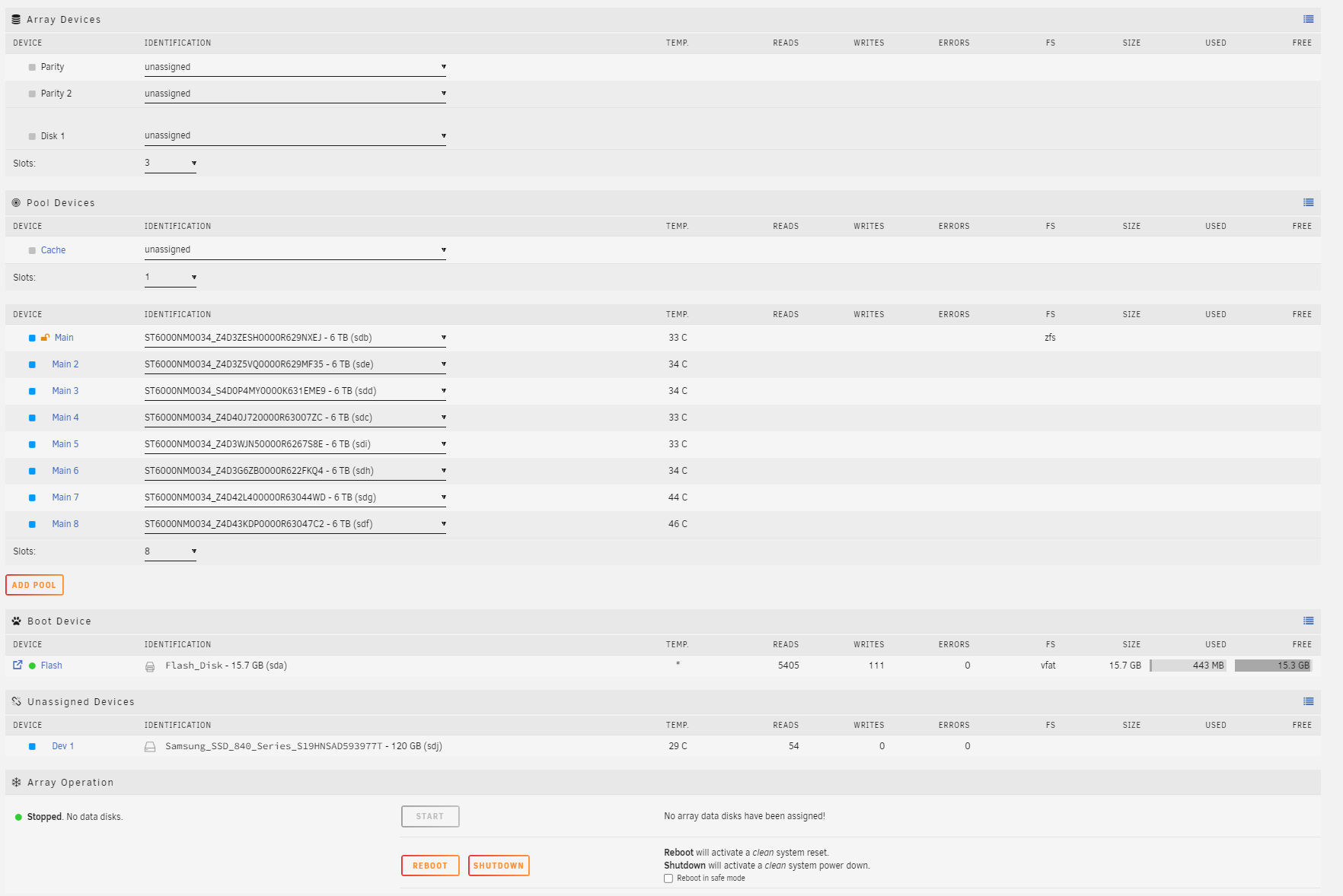

  4. I am using 6.12.4, my first time working with Unraid, the setup is new, I can wipe and redo as needed. I created my RAIDZ2 pool (1x8) and unless I have a disk in the array, I seem unable to start the array. Using SSH, zpool list returns no pool. I must be doing something wrong, see below. If anyone can spot my mistake, let me know.
