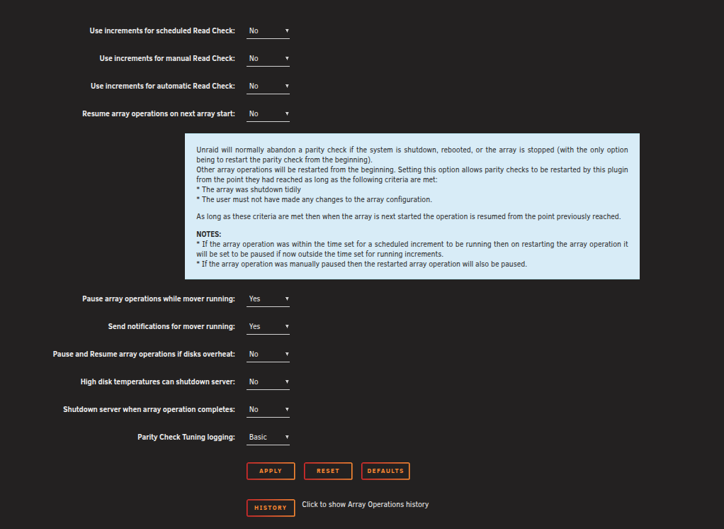

Hi Jorge, Current parity check status: Position: 3081 GB (15.4%) Speed: 106.6 MB/s Sync errors corrected: 412 Estimated finish: ~1 day 20 hours No read or write errors so far One concern: I have a planned power outage coming up. Is it safe to pause the parity check, shut down properly, and resume after power is restored? Will Unraid pick up where it left off or restart from the beginning? Thanks again!
